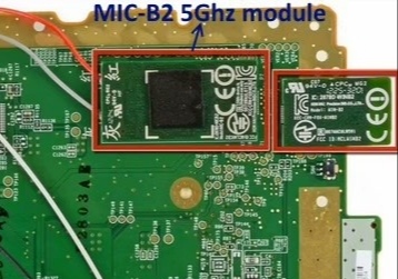

You don't need the disc drive for now, but connect the wireless modules.
Connected wireless modules, console outputting Wii U logo, orange LED flashing. Here are the logs:
I will keep it on for a bit, but now it looks like it's repeating:
"alive
opening /dev/net/ifmgr/ncl...
opening /dev/net/ifmgr/ncl..."
are you sure they are seated properly?
I powered it down and ensured they were connected properly and tried it again.
Repeating the same "alive opening" lines. I'm 95% sure I have the modules connected to the correct ports. Going by what the picture Ysecond shows, the module with the red cable is the one connected in that specific port. I did the same with my Wii U
