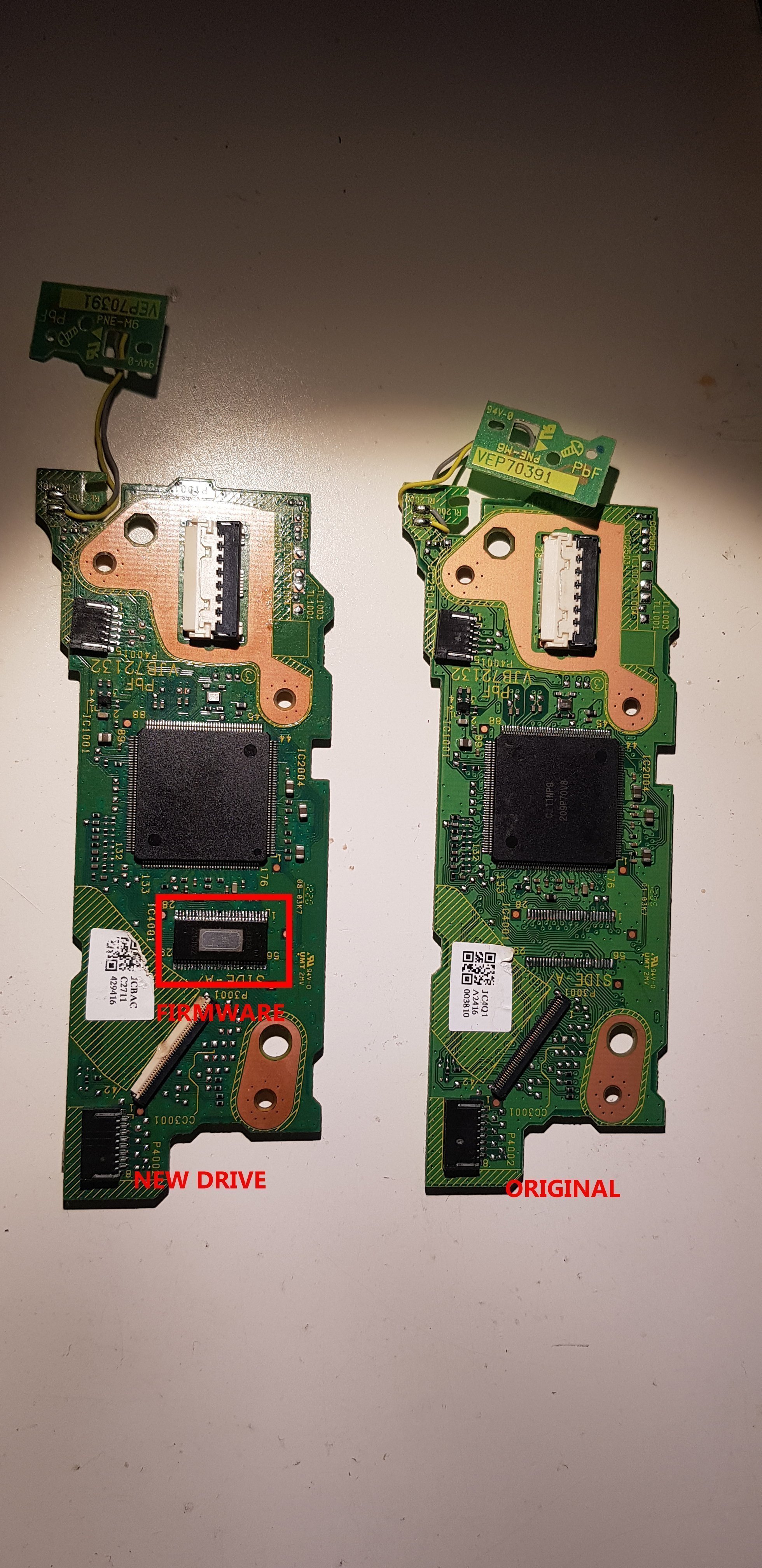

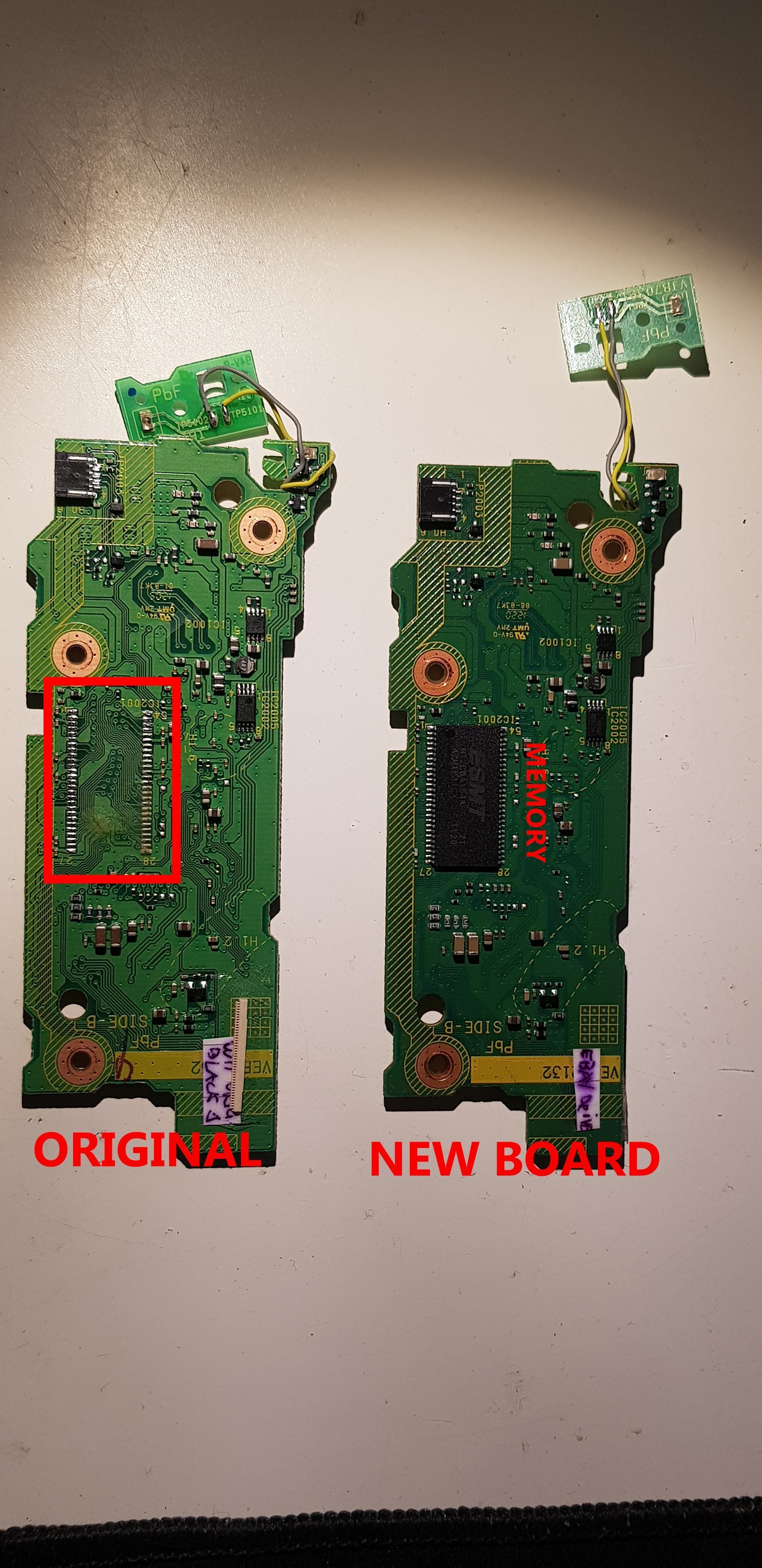

You can see in one of the pictures that there is one IC that I'm pretty sure it is the memory ( RAM and you don't need to replace it, I did just for testing ) and in the other there is where the firmware ( and where the key would be recorded ) that IC is the one we are interested in.
If you are looking to fix yours just remove that IC where supposedly the firmware is from your original PCB and solder it into a new PCB ( make sure to buy a PCB that is the exact same model as yours ).
I CAN NOT guarantee that it will work, but I have read about people who replaced and it worked.
In my case when soldering the "Firmware IC" the console doesn't turn on it stays with a red light, if I replace it by the one from the new drive the console turns on and stuck with error 160-1402
I am 100% sure that the "Firmware IC" is faulty on my PCB, 'cause I have desoldered it several times to make sure that the problem was not into my soldering.
The idea behind this post is to find someone out there that has a Wii U and two drives to test this theory and confirm that it works and the ICs I'm mentioning are the right ones. :grog:

Did you check what are those 8 pin chips? They look like serial flash but i can't read their names.
