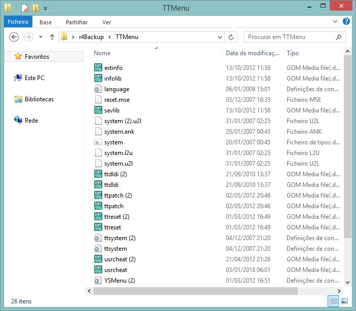

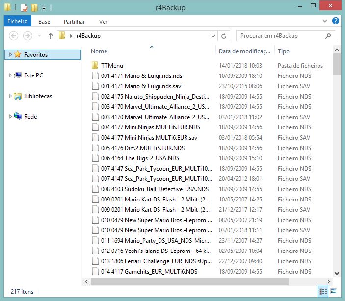

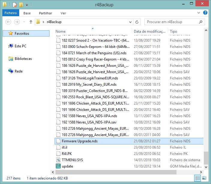

Some images of the sd card root and the flashcard pcb below. I never owned a r4 flashcard as i always said, and a help would be very nice. Thank you in advance.

Make a backup of the SD and download ysmenu for it (http://gbatemp.net/threads/retrogamefan-updates-releases.267243/ for DSTT/i, remember to rename the TTMenu.dat to ill.il).

It's R4i Pocket(couldn't find a single pcb match on the internet but there is a file R4i.PK) which is a DSTTi clone appearently, checking tools says its chip is not supported, as expected, and the problem just returned, it gets normal sometimes but nothing permanent, i'll try these DSTTi clones firmware(the oldest or the most recent) to see if i can fix it, but what i wanted was to restore it to it's original state before i upgrade, any tips ?
Fixed the problem by renaming the file update.dat to R4i.PK(possibly generated when i booted the "firmware upgrade.nds" file) and removing the old R4i.PK.
