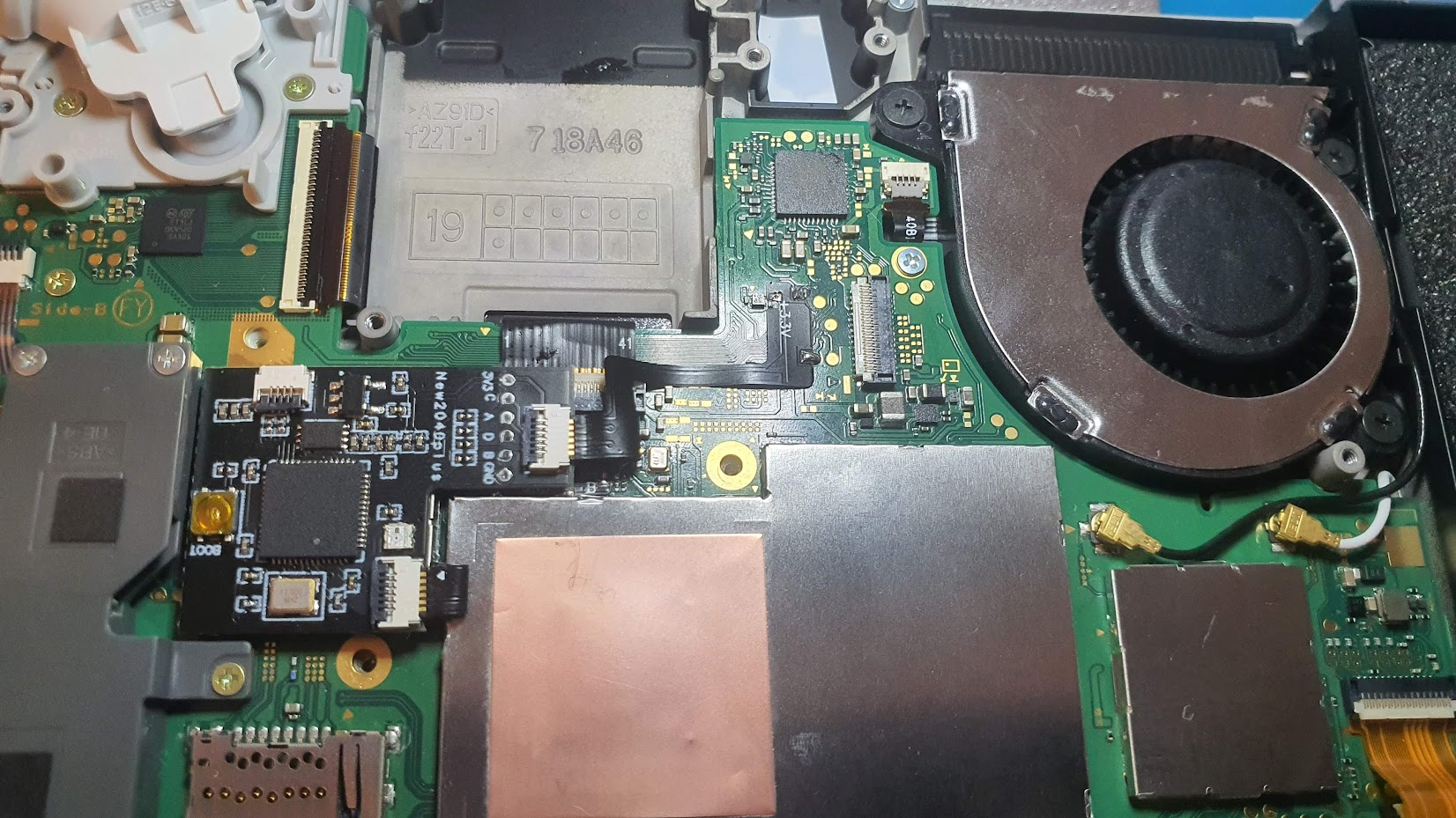

Hi guys,
I've bought this chip, does someone know it : https://ibb.co/3SwcSQ0 ?
I installed it but nothing happens, no LED activity, switch boots straight to OFW.
To make sure my installation was correct I tried with a regular hwfly and it boot to hekate.
The chip is brand new, do i need to flash it or something ? What's thoses BOOT and RESET buttons ?
Thanks !
then it's probably not a picofly. Check with the people you bought it from
Thas is a picofly. Same as Hwfly but with RP2040.
That is good , should work now 100% :teach:
Should work ? But switch is on bootloop now :'( on nintendo logo... I assume something might be wrong with the chip or bad flashing from my end
Remove only the chip and then make some close up fotos.
You cant mess up the flashing, copy/paste
Aren't you the same person who fried his chip earlier?
Be careful where you place the chip because your metal cover can press those buttons resulting in a bootloop.
the speaker should protect the buttons, don´t think it´s that. But if he placed the chip on the speaker then yes :lol:
