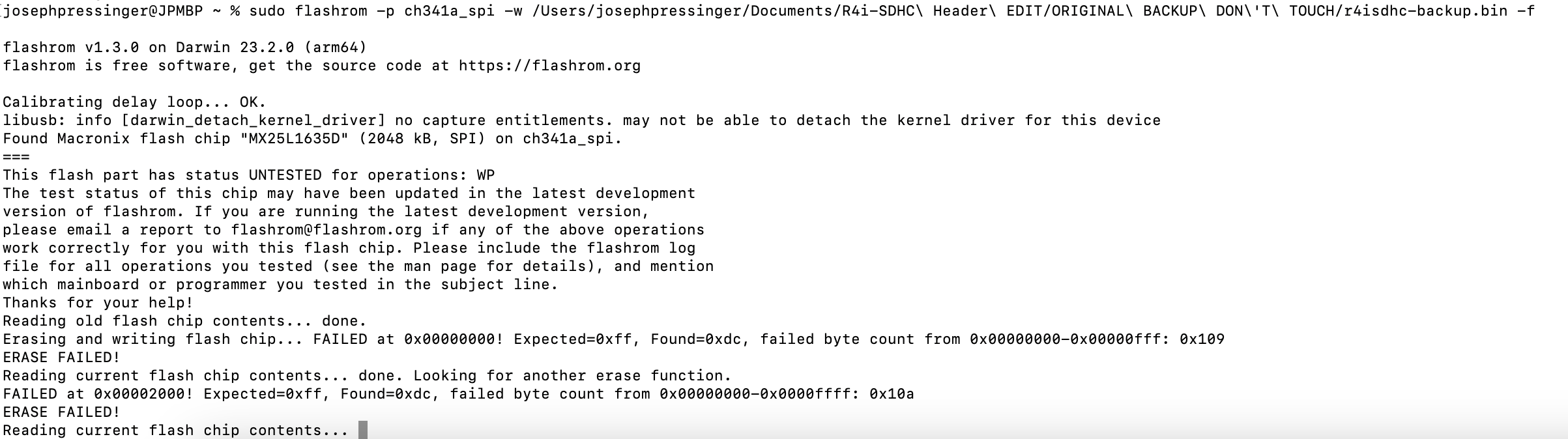

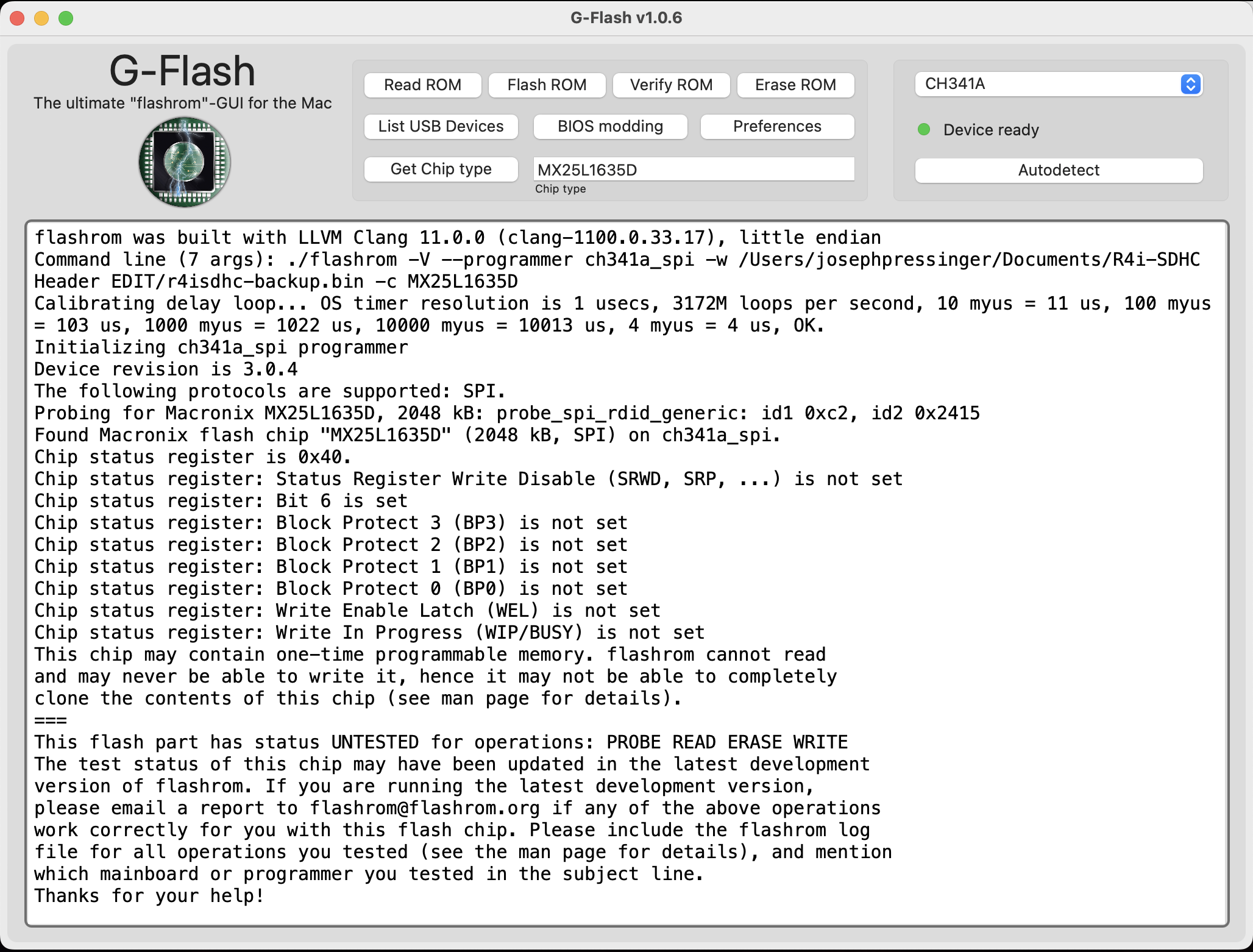

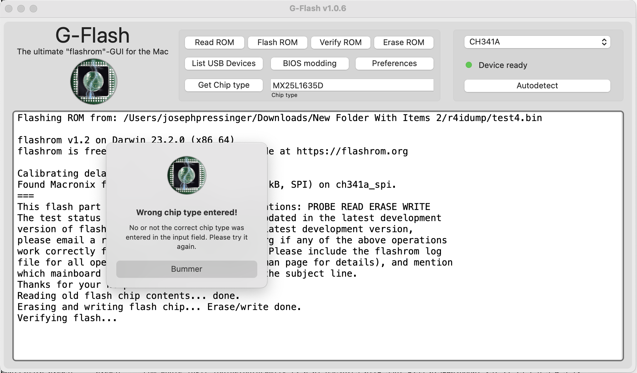

I have tried everything... and I am currently trying G-Flash. The chip identifies itself automatically but when Flashing it doesn't want to work:
I have no idea what I am doing to be honest, but it didnt work in ASProgrammer or NeoProgrammer- when flashed in either of these two, it would register as flashing successfully however, would fail to verify. the chip would also return back a completely different readout to the backup that was used to flash it too. This is been attempted now on Mac and windows so I am a bit lost!
edit: I tried again with verbose logs enabled and this is what it output:
It is better to use neoprogrammer on windows instead of flashrom.
If your ch341a is not recognized by windows, you will need a usb driver.
They usually come with the programmer files
It's a bit tricky, but it can be solved with programs like zadig or
You can also use another computer or laptop.
If the CH341A is recognized correctly, there may be protection on the chip.
You can try the un-protect function of neoprogrammer.
Reactions: Jammyjoe05

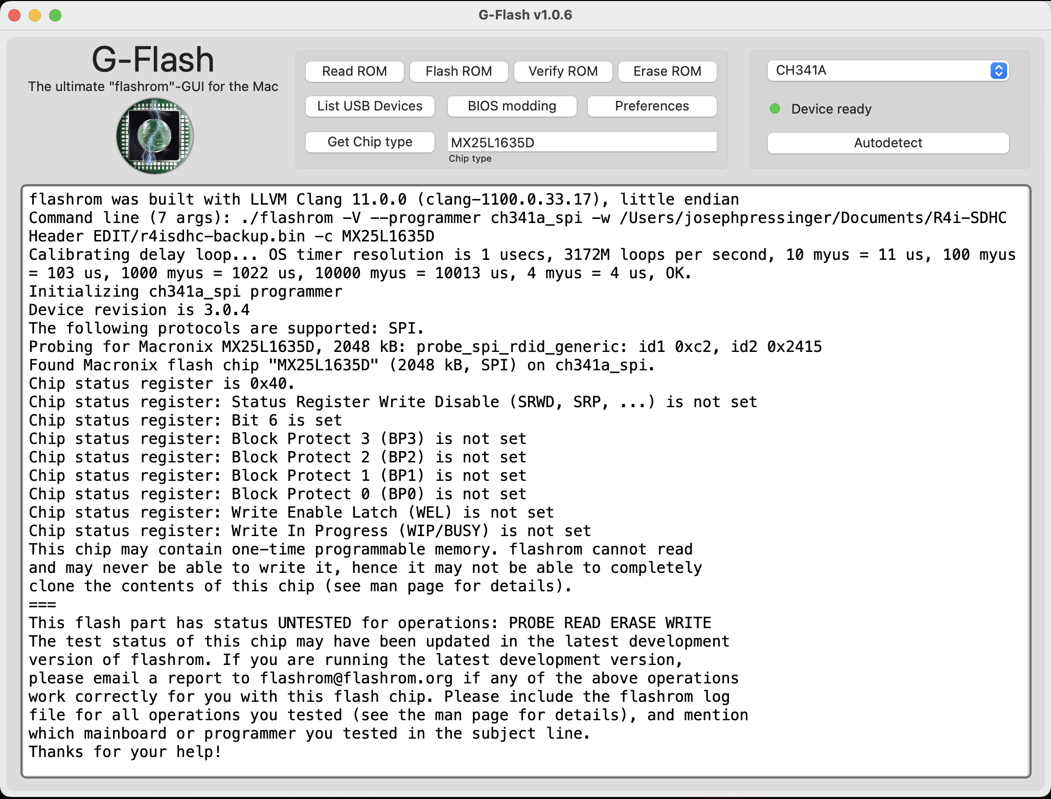

I am the guy on discord that was having the same problem.
Finally gotten a new SOP8 chip and I managed to restore it back into working condition with a dump I made before messing again.
I am guessing the reason why it didn't work the first time I tried it, is because I didn't erase the chip before programming it.
I attached the firmware dump for anyone who needs it in the future.
