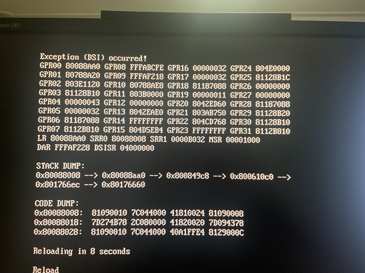

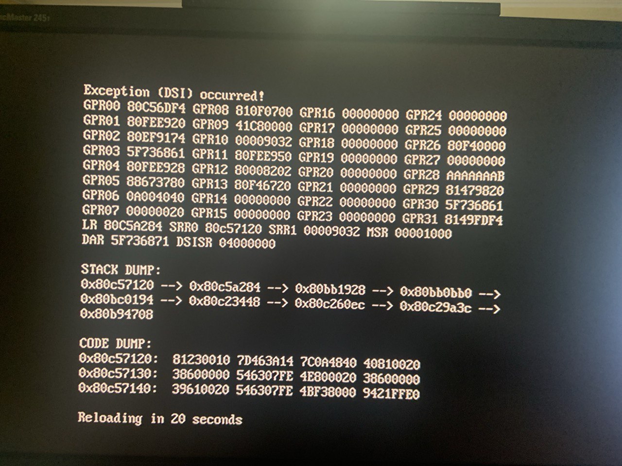

Hello. I installed CFW on a new Japanese Wii (probably revision "RVL-CPU-20/30" or "RVL-CPU-40/50/60"). I followed this guide. cIOS installed using the latest d2x-v11-beta3, according to the guide. Then I copied the latest version of USB Loader GX to a sd card, launched it successfully, changed the language to English, and then did this for autostart. Everything seemed to be working fine (I hadn't gotten to testing games yet), but suddenly, when I clicked on the loader menu, this error appeared. Then everything worked again. What could this mean?
Then, during one of the launches of FCE Ultra GX from the HBC Menu, an error occurred.

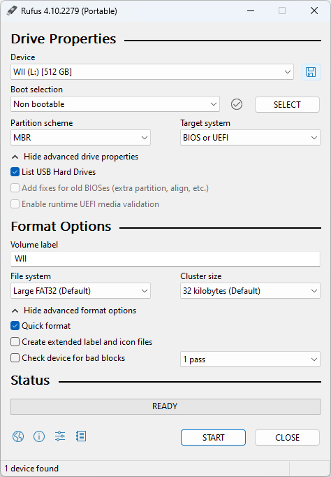

As it's crashing with other homebrew too, it's likely caused by the SD card and how it's formatted.
If you're using Windows, you can use Rufus to format the SD card or USB drive. Just copy the exact settings shown here.
Always eject your SD card or USB drive before removing it from your PC, otherwise data can get corrupted and that'll cause crashes.
I formatted the SD card using Rufus and now I can't reproduce those errors. Thank you! Are there any tips for using an SD card in the Wii, similar to the tip to eject your SD card in Windows?
Never remove your SD card or a USB drive while you're using them in homebrew. But it should be safe to remove either while you're viewing the Homebrew Channel.
