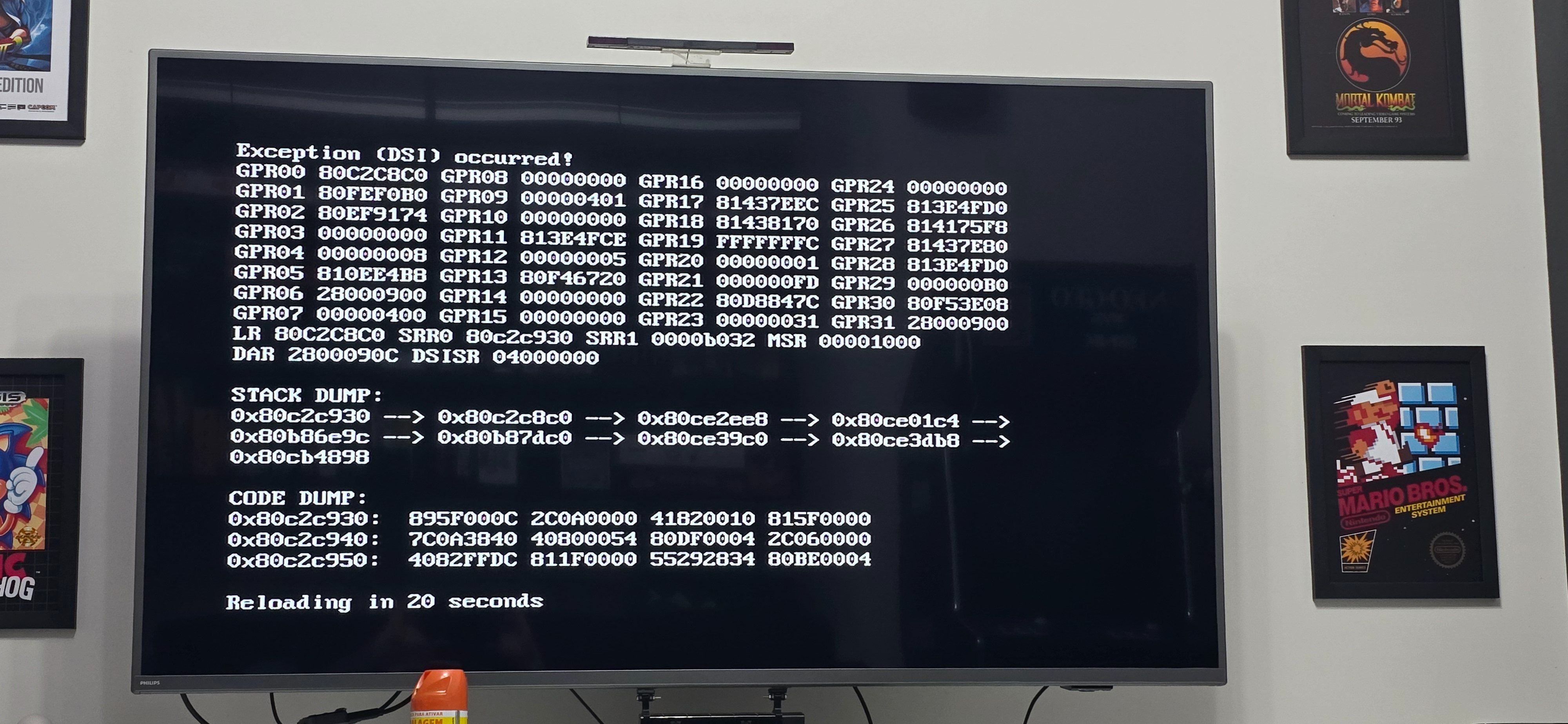

I get this error when I try to load USB loader. Hdd 4tb ntfs just with wbfs folder. It's appear after load resources

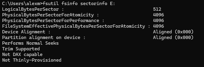

Can you input the following from a PC (replace X with your drive letter) and then share what it says?
fsutil fsinfo sectorinfo X:
It'd also be good if you could tell me your hard drive model, because if the goal on my Ko-fi is met, then I'll need to purchase a drive that doesn't function at its full capacity when it's configured for modern systems.

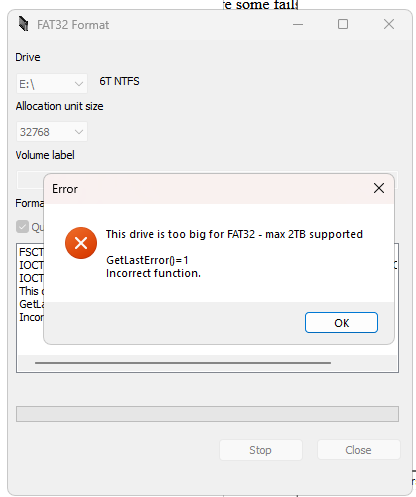

This is what I'm getting when trying to format the 6TB drive.
Drive is a WD 6TB Elements Portable External HD - WDBHJS0060BBK-WESN
Have you tried to use WD Quick Formatter to set the configuration to XP Compatible? Then in Rufus you'd want the partition scheme set to MBR and the cluster size set to 64 kilobytes (because it's a 6TB HDD).
If using WD Quick Formatter and Rufus doesn't work then can you confirm if creating a 1.8TB FAT32 partition works? You could use Minitool Partition Wizard, EaseUS Partition Master, GParted etc.

Have you tried to use WD Quick Formatter to set he configuration to XP Compatible? Then in Rufus you'd want the partition scheme set to MBR and the cluster size set to 64 kilobytes (because it's a 6TB HDD).
Awesome the WD quick formatted actually worked for me. Had to do Xp compatible and it put the entire drive as MBR, only then was I able to format im FAT32 @ 64kb with guiformat. Adding some games to test it out now.
