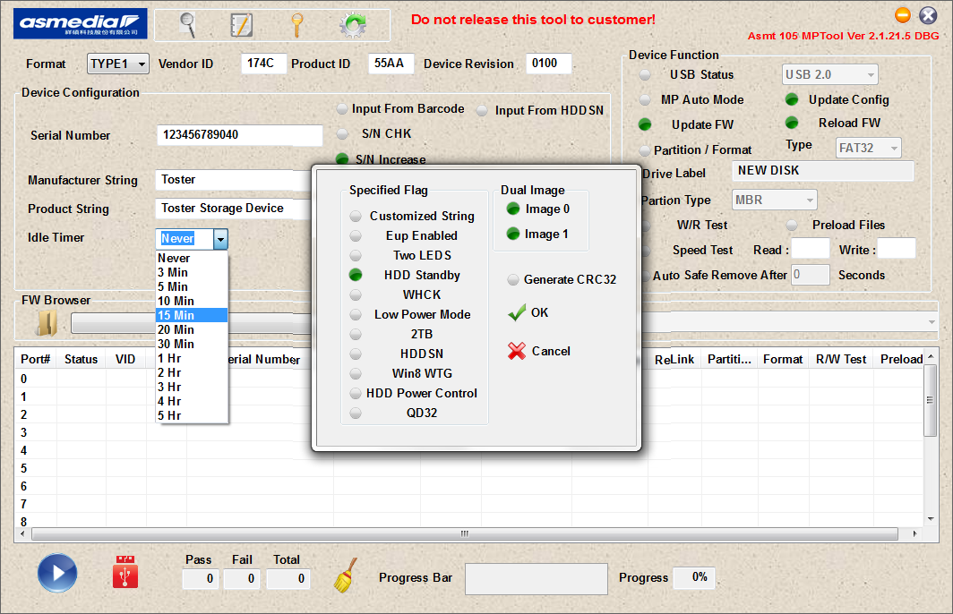

Is there any way to use IOS58 but have it also prevent HDD spin down?
I could just have the loader read random sectors every 60 seconds or so. But I don't know how reliable that'd be.

@Nomado Just check if you can disable the spin down internaly in the drive -> Drive Spin Down
I think the USB enclosures themselves also have their own idle timer. For example Asmedia ASM1051 MP Tool has such options for configuring the firmware:
