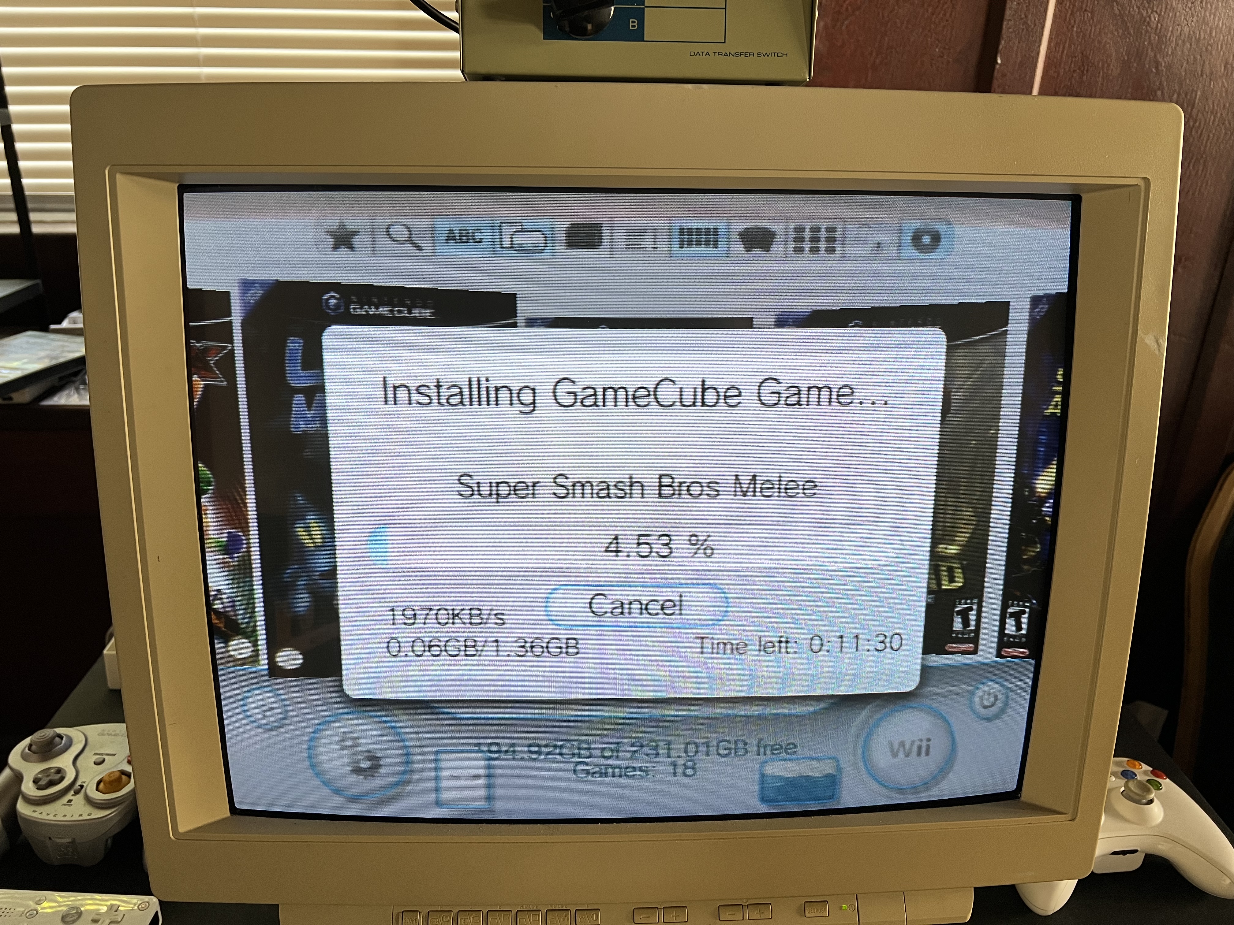

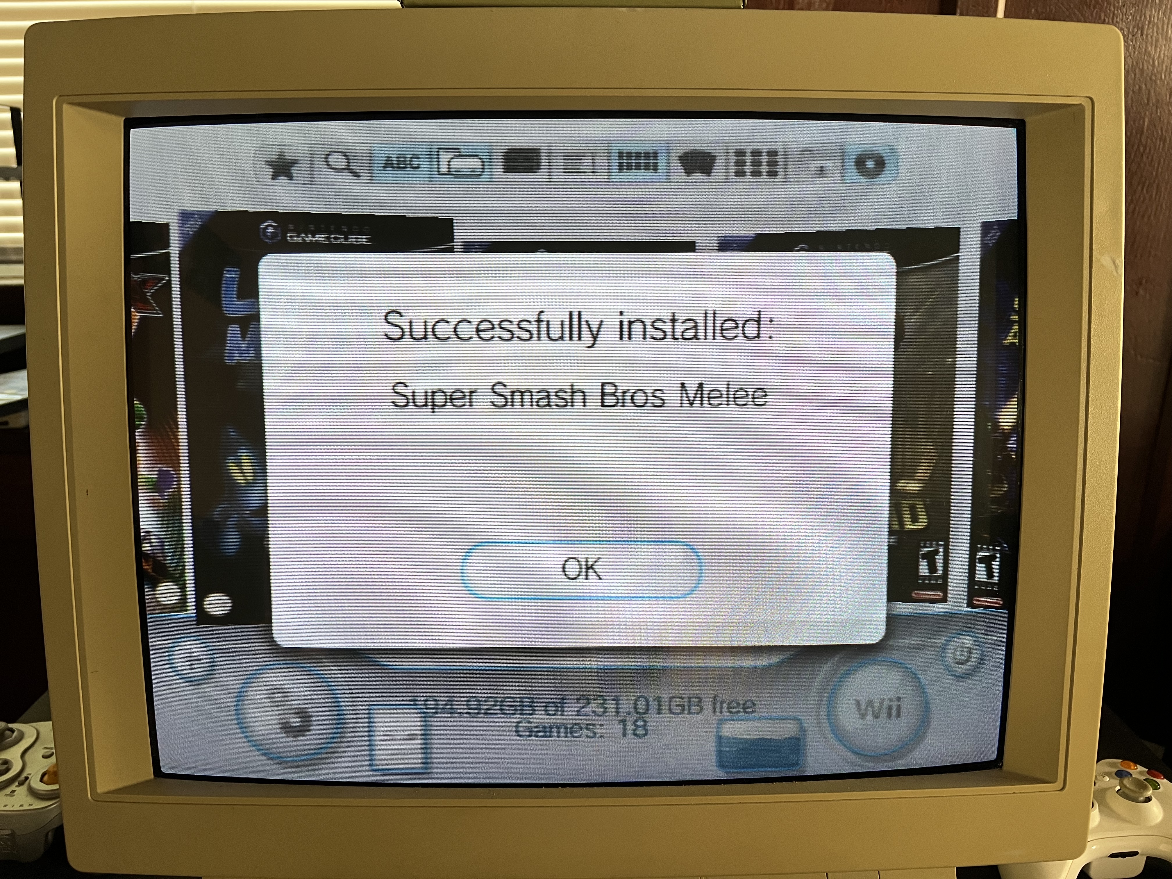

The biggest thing I've seen with flash drives is that when trying to rip games to them in USB Loader GX, things freeze. Does this drive not have this issue?
It's nice to see a confirmed modern flash drive working on the Wii. I have some recent SanDisks which don't work, and I tried an external HP 500GB "SSD" (glorified flash drive) which failed to reset correctly as well.
Only thing I will say is do be careful with PNY flash storage, in my personal (and friend's) experience, PNY flash QC isn't the greatest and be prepared for it to spontaneously die/forget data for no reason (seen multiple SD cards and an SSD fail, haven't tried their flash drives).
Thanks for the heads up. Luckily, Wii game saves stay on the Wii, and GameCube saves stay on the Memory Card. So worst case, I just have to reload the ROM backups from my NAS.
Okay, tested it in the time since I posted the last message. That was fast. Works great!
