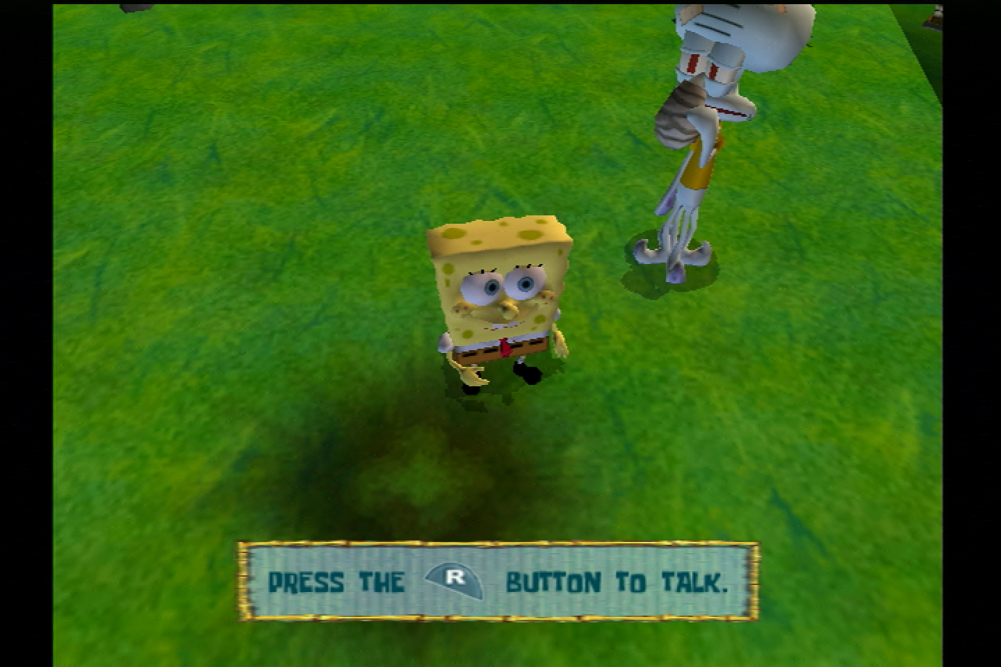

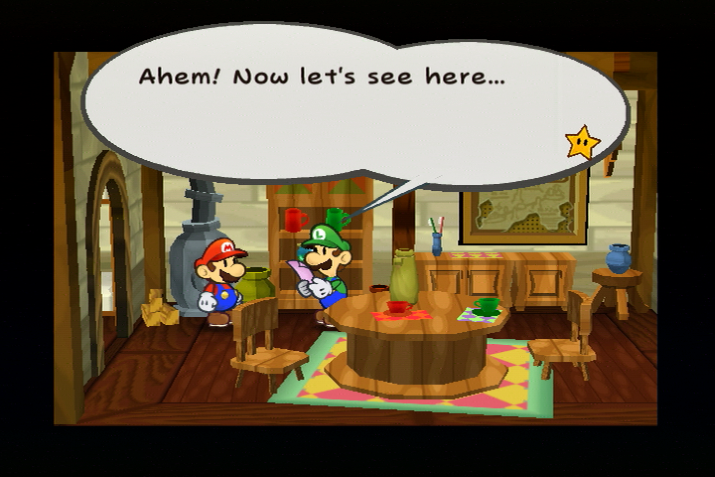

I had a launch Wii connected to my OSSS straight up through component with the recommended Wii settings for OSSC.
It looked absolutely dreadful. Just bad. I messed with settings for hours and it never looked anything close to good. My Wii U Wii looked better and the Gamecube looked light years better.
Not until Deflicker mode/480p bug fixdid my Wii truly come alive. Then i added other stuff like Wii Dual, retrovision, ect and it looked even better but the game changer was turning off that deflicker and fixing the 480p bug since i had a launch console.
Straight up launch Wii out of the box though is so bad. You can't say that about other consoles.
I don't think it's that bad, but this is for sure not a 2006 launch system:
But you could still get a cleaner and sharper image from a GC I think, let alone using GCVideo, that's another point with it being able to do digital video; although I'm using cheap cables.
The Wii U vWii has so many oddities and weird things with the upscaling, that if you are searching a good and clean signal, I probably won't recommend it.
But for most people it will be fine and good (but if someone does so, use 720p or 1080p, don't use 480p).
