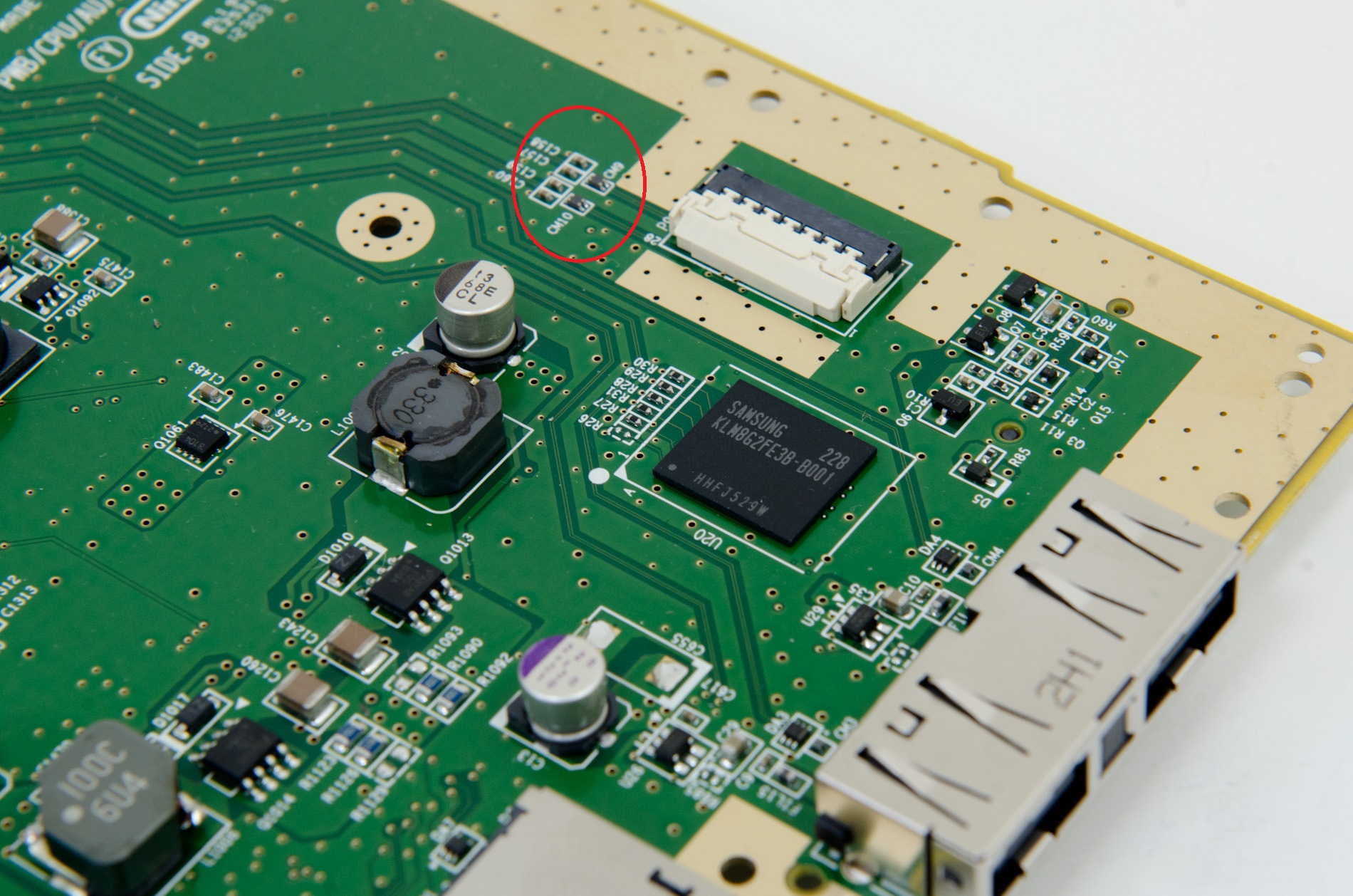

how i can fix an 160-1402 error on my wii u witch the dvd drive died
Error 1402 will shown, if the flatcable of the drive is rotated (rotate the cable with the edge right). If you then got error 160-1400 then are mostly two small smd items near the driver connector bad (on the Wii U Pcb) and had to be replaced.

This is the same as with the PS3. If the connection to the DVD drive does not work 100% during a firmware update, the drive will not be checked, updated and this will end in this error message. With the PS3 I would have to look for the error message, I don't have it in my head and it wasn't anywhere at the time. With the Ps3, however, there is the possibility of marrying another PCB, which is not yet possible with the Wii U as far as I know. You have to check your Wii U PCB !
ok bro i will disasimble the console tomorrow and will tell you whats will happed
Ok, if you got 1400 error, you have to check the red area. Mostly the first two tiny smd parts a gone.

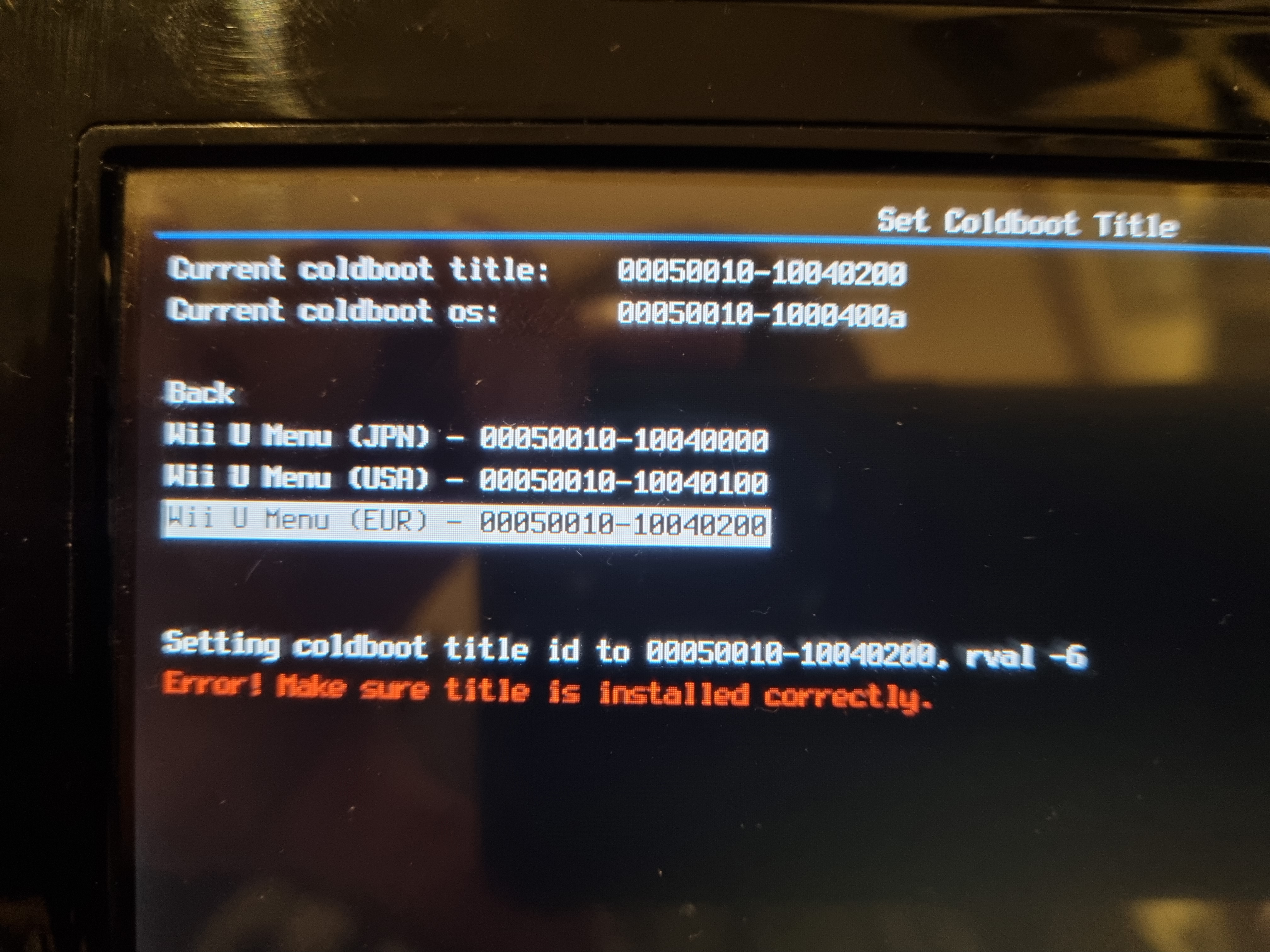

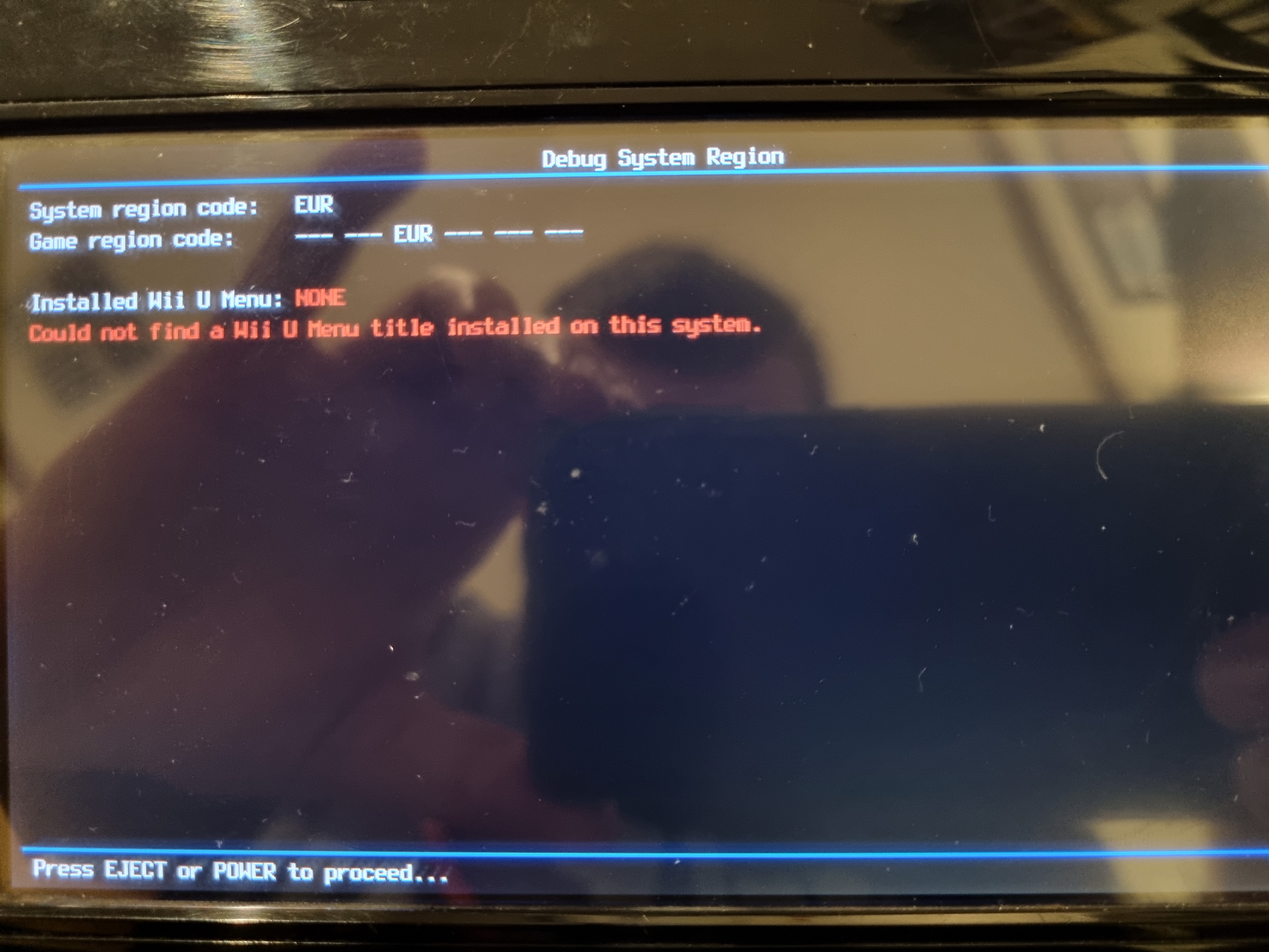

Hi all,
Looking to get some help with this Wii U I purchased. I do not know the history of this console, so I have no NAND backup of it. It displays a 160-0101 error, however when I use a pi pico to load the udpih + recovery menu, I cant seem to set the coldboot title back to my correct region. It gives me an error telling me to make sure title is installed correctly. Going into debug system region, its telling me that it could not find a Wii U menu title on this console.
Can this be fixed?
