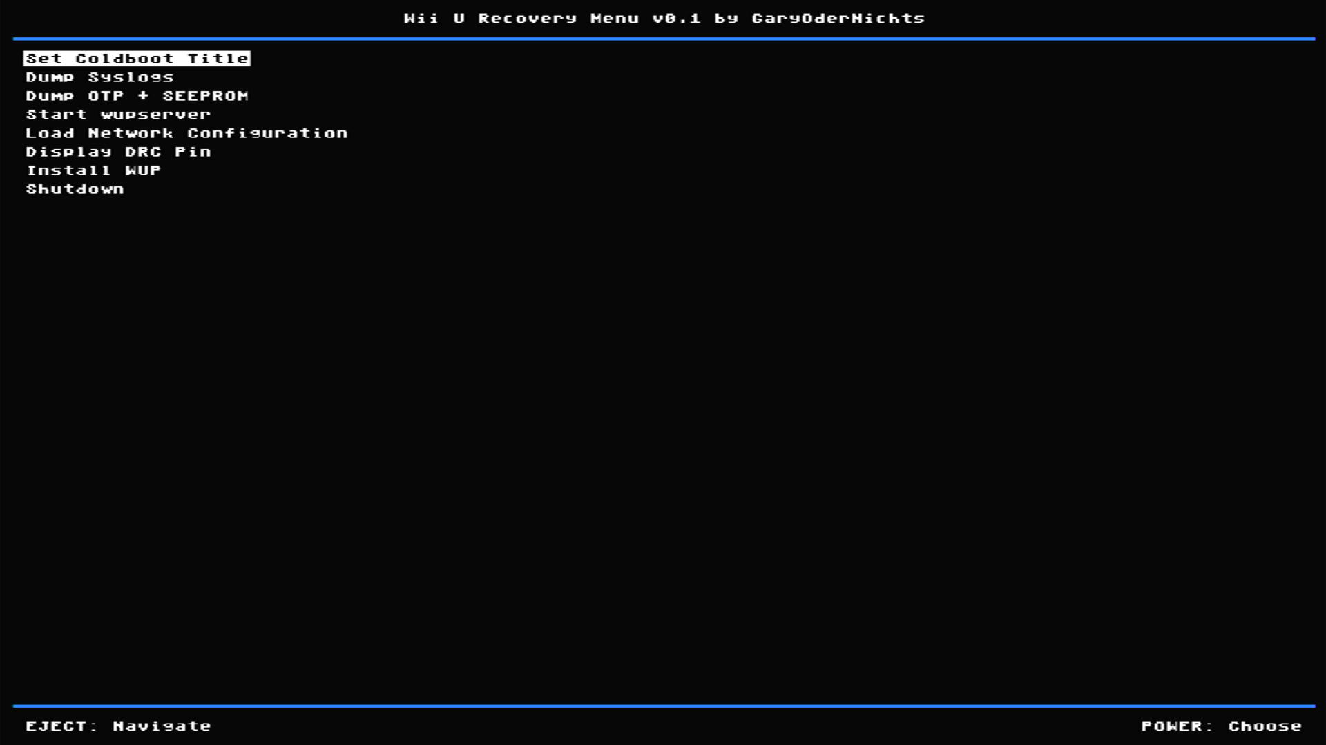

Setting up UDPIH​
Head over to the UDPIH post and follow the Intructions for your device until you're booted into the Recovery Menu.
Changing the coldboot title​
Once on this screen make sure the cursor is on "Set Coldboot Title", and press the POWER button on the console itself (not the controller or GamePad)
Press the EJECT button on the console until the Wii U menu entry corresponding to your console region is highlighted.

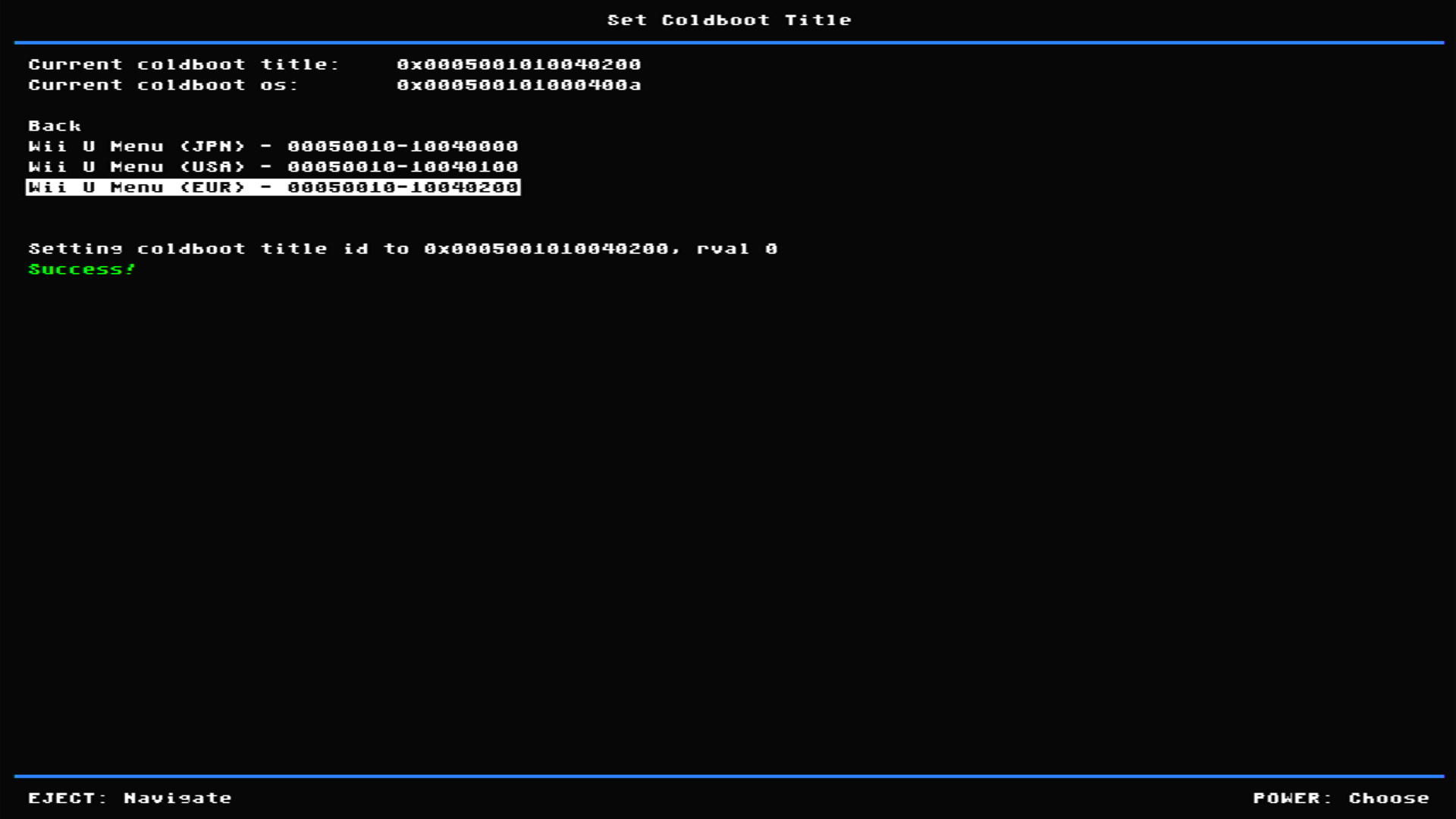

Then press the POWER button.
If everything worked out you should see the following screen:
Now press EJECT and you should be back on the main menu. Navigate to Shutdown using the EJECT button and press POWER.
Your console should power off.
Now remove the Pi from the console, and power it back on. Your console should boot back into the Wii U menu.
