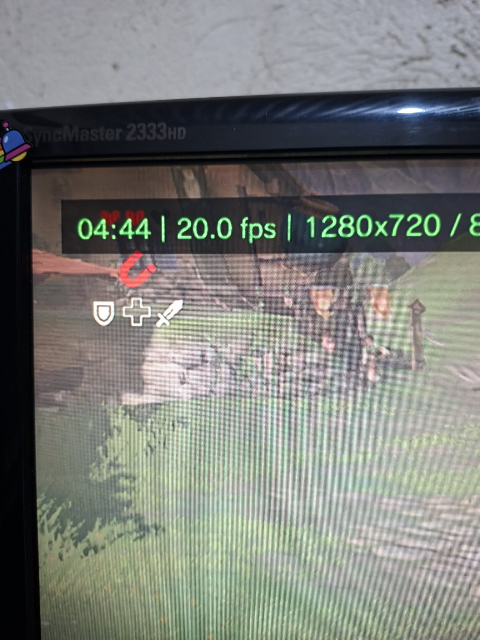

How can I see the difference in FPS?
- Try to install the PapayaHUD аromа plugin. This isn't the best method, as it lowers your FPS so test it before and after OC, and at least something will be clear. The best way is, of course, a capture card.

I have a question regarding to my wii u, it is WUP-01. I cleaned it this morning. I tried to overclock it to 750mhz. and still getting 20fps in Hateno Village.
my game is BOTW btw.
I already copy and paste it in my minute.ini, but it still getting 20fps.
Hateno Village and the Castle remain those locations that depend on the CPU power, not the GPU.
I also wrote a guide for Zelda BOTW modding and you can install the performance patch, it will help increase FPS a little more.
I can quote a review from one person with tests at a frequency of 650 for anyone interested.
> "Korok Forest ran at 30 fps, and Hyrule itself, while riding most of the time, remained at 30 fps without drops, except in certain places like Hylia and Faron where the fps did drop. But mostly in the places where I used to have FPS drops with 550MHz, they are no longer present for the most part, which is already a victory for me. Clearly, the frame rate improved in the ranches unless you go inside, but outside it mostly maintains a stable frame rate, while in Kakariko Village and the castle itself it ran at 20fps as you already mentioned in your guides. However, I noticed a difference in more stable (though not perfect) frame rates in the following locations: • Zora's Domain (stable 30fps until near the king's throne) • Goron City (30fps with some minor drops) • Ornin Village (same as Goron City) • Gerudo Town (30-25fps, not bad, but clearly there's room for improvement). Where I also noticed a difference is when activating bullet time and using the tablet modules. Before, magnification and paralysis would drop the FPS to 20, but now it maintains 30 FPS. Similarly, exploding bombs or barrels didn't cause such aggressive drops and also maintained 30 FPS (although I should do some pyrotechnic tests, haha). I played for almost 1 hour and 22 minutes, and honestly, my Wii U didn't get hot at all (I bought it a year ago). It felt the same as when I have long gaming sessions. I have an A5X SoC, and my Wii is one of the first models, so I want to think I got lucky and my Wii U dissipates heat well, or something like that."
