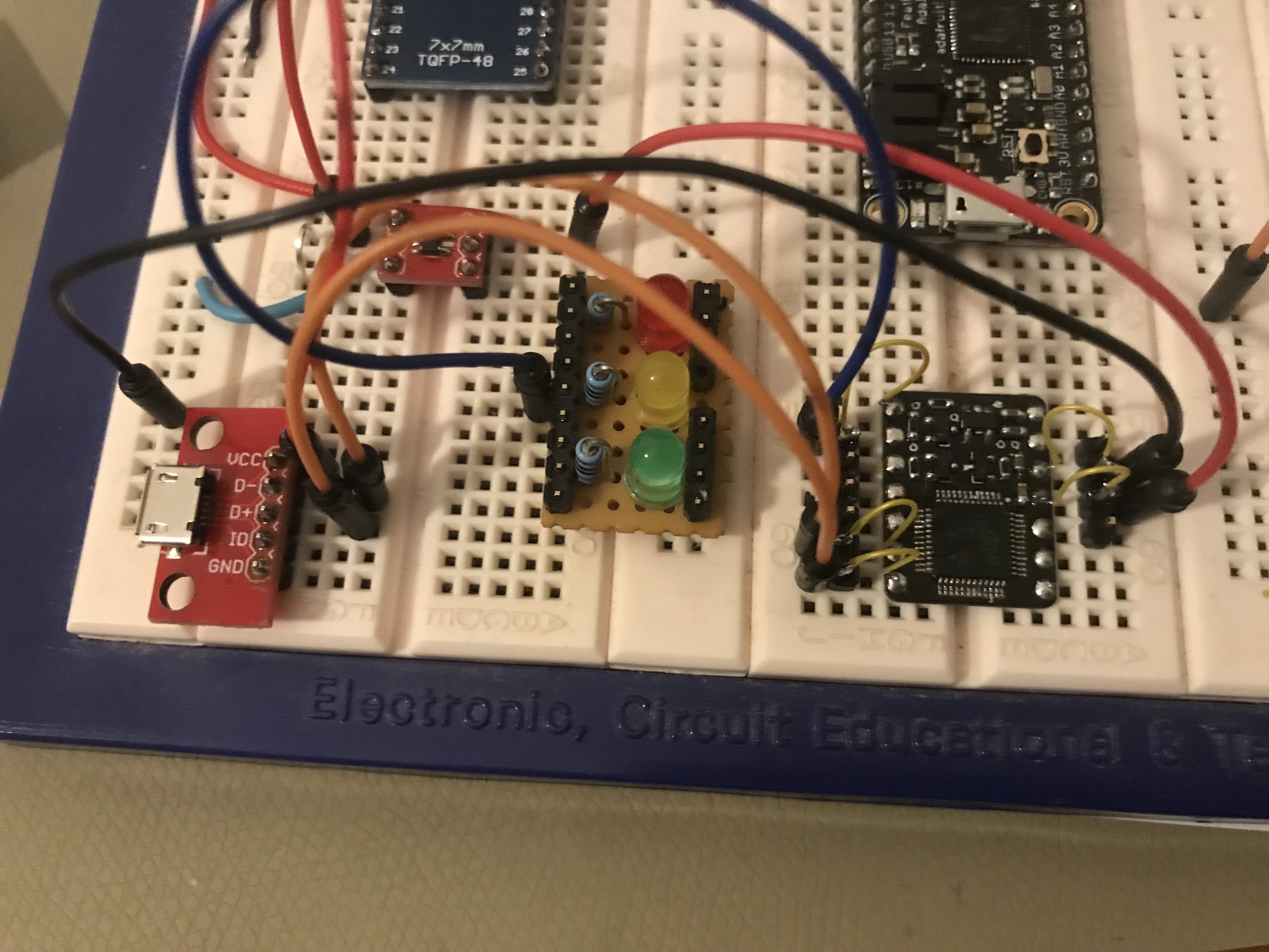

OK after doing a few experiments (3 chips), I found the following:
Pins 5,18,35,42 are all ground pins and are connected internally to each other - so only 1 ground wire from the chip is required.
Pins 17,36,44 are all 3.3v pins and are all connected together internaly
Pin 6 is also 3.3v but is not connected internally to the other 3.3v pins.
1: After soldering check all pins - do a continuity on all adjacent pins to make sure they are not shorted (you'll not have any continuity before any power is applied to the chip).
2: If you power up the chip without a bootloader and only connected via gnd + power, after a few seconds the chip will get hot and bridge all GND to 3.3v pins (sometimes pin6 will short to gnd, but pin 17,36,44 will all be bridged to ground).
I don't know if powering up before programming breaks the chip - but it seems to need the bootloader pogrammed or it will just get very hot due to shorting out :-), At first I thought this was a soldering issue - but after 3 chips and checking for shorts prior to power, it's not. So be warned if doing your own chips!

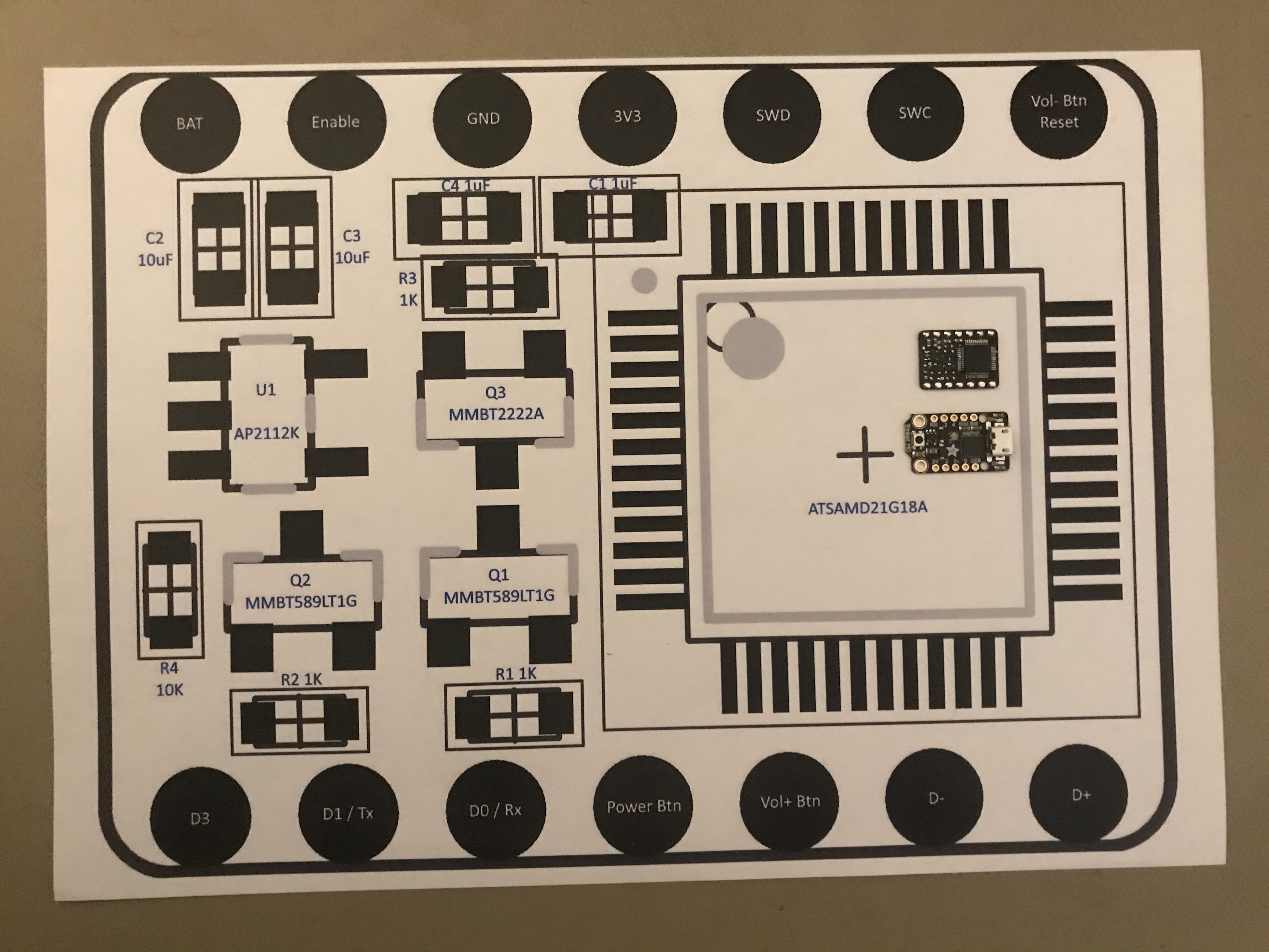

In case you want to program some sketches on your testboard, you can try my board package file in the Arduino IDE:
The reason, why I made a own board package was, that I had troubles using the arduino zero (native usb port) configuration. I think, the build or the upload settings didn't mach with the cristalless design of the testboard. The trinket configuration also didn't made me happy. There, it was possible to successfully upload sketches (build and upload settings seems fine), but the pin-configurations were very limited. Worst of all, my chosen pins weren't defined as digital IO's.
My configuration now combines the pin-configuration of the zero board together with the build and upload settings of the trinket.

My custom boards arrived today, yeah! :-)
Size comparsion with a trinket:
Soldering the 48-TQFP was a pain... but after that, all the other components were no problem at all.
For flashing the bootloader on the board, I used the j-link edu mini programmer (I will test other programmers another day). Even without the additional supply caps, flashing worked the first time without any problems:
With the bootloader on the chip, it was time to plug it into the PC. The trinket was recognized and was ready to use in the Arduino IDE:
Flashing of the sketch worked also without any problems. All in all a quite successfull day! :-D
