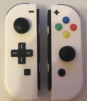

hello, I want to replace my tri wing screws. Last time I ordered joy cons shells and these came with tri wing replacements. These were cross screws to replace the tri wing. The seller didn‘t response my message where to find these replacements. Can someone help me?

Watch out. Test how soft the replacement screws are. Cheap screws from China can be so bad that the heads either break off (though only in extreme cases of cheapness) or the metal they used is too soft and strips very easily which can happen when using third party Joycon shells as I hear those don't have pre threaded screw holes so there will be a lot of extra torque needed to screw them in the first time. (I recommend screwing in the triwing screws first to thread the holes, then install the cheap replacement screws).
Assuming you prethread the screw holes I suppose it would be worth the risk finding third party replacements. :P

I don't have a transparent shell, but I am VERY happy with the material used on my white shells. Feels at least as solid as the official shells and nice matte finish.
Do you really need to replace the screws? How often are you planning to open the thing?

Yes I need new screws. In the first attempt the right joy con didn‘t fit on my switch tablet. It was a bit above the side of the tablet. My screws (tri wing) are already a bit screwed. So, safety first before something go wrong.
