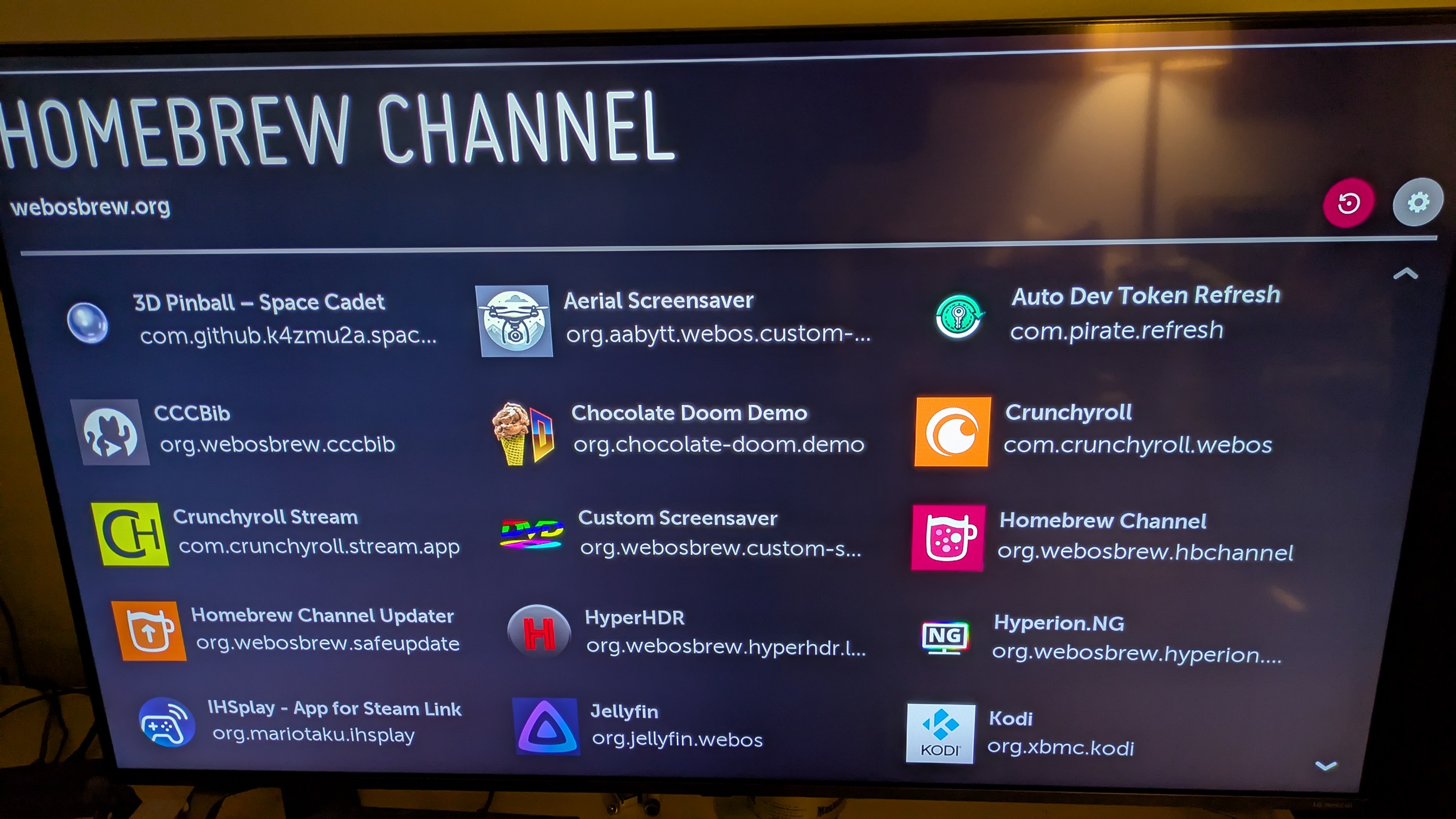

In this case WebOS LG TV, should support retroarch as well, but I have so much other emulator capable things connected to the TV already, so didn't check retroarch further.
Mostly did the modding just for shits & giggles :lol: (and to get usable functionality out of Prime Video and Media buttons on remote)

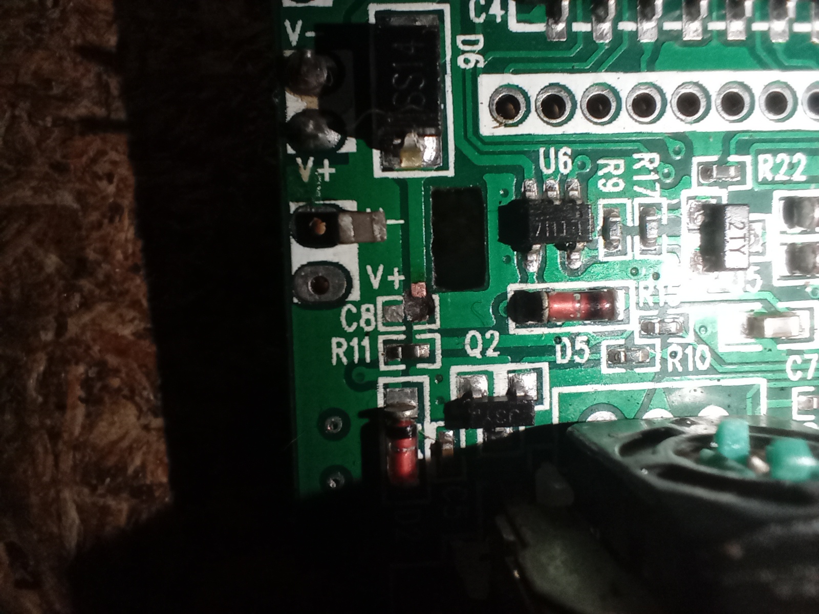

I removed the PCB out of the shell, and saw that something indeed burned... component "C8" which I assume was a Capacitor.
Not only burned, but it actually did a hole into the PCB because when I tried to clean the burn area, my needle went all the way through the PCB in that spot.
I grabbed my Multimeter and noticed that C8 has continuity with the thing above it, and to the right of V+, and noticed that R11 was shorted because I got continuity with Ground.
I asked ChatGPT for assistance, and it asked me to show it the picture above... I did... and the motherfucker analized it, and not only that, it recognized R11, Q2 being a Mosfet and D2, which is a Diode, the red thingie on the bottom.
It told me to check for shorts on the PCB, it did not had any, then told me to check D2, and it indeed was shorted, no continuity and no reading. Fortunately, Q2, the Mosfet was working right... so I guess the Diode sacrificed itself. And ChatGPT told me to replace C8, R11 and D2.

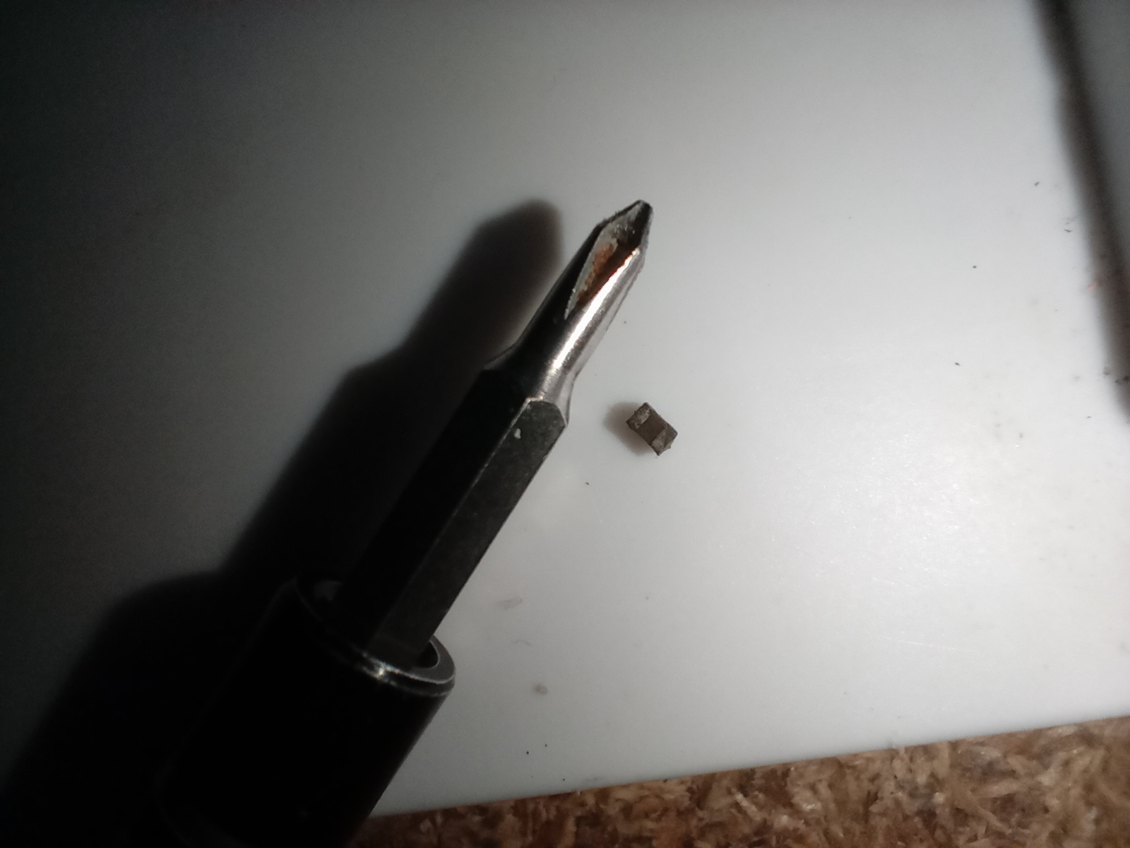

I did... look how small the Capacitor is!

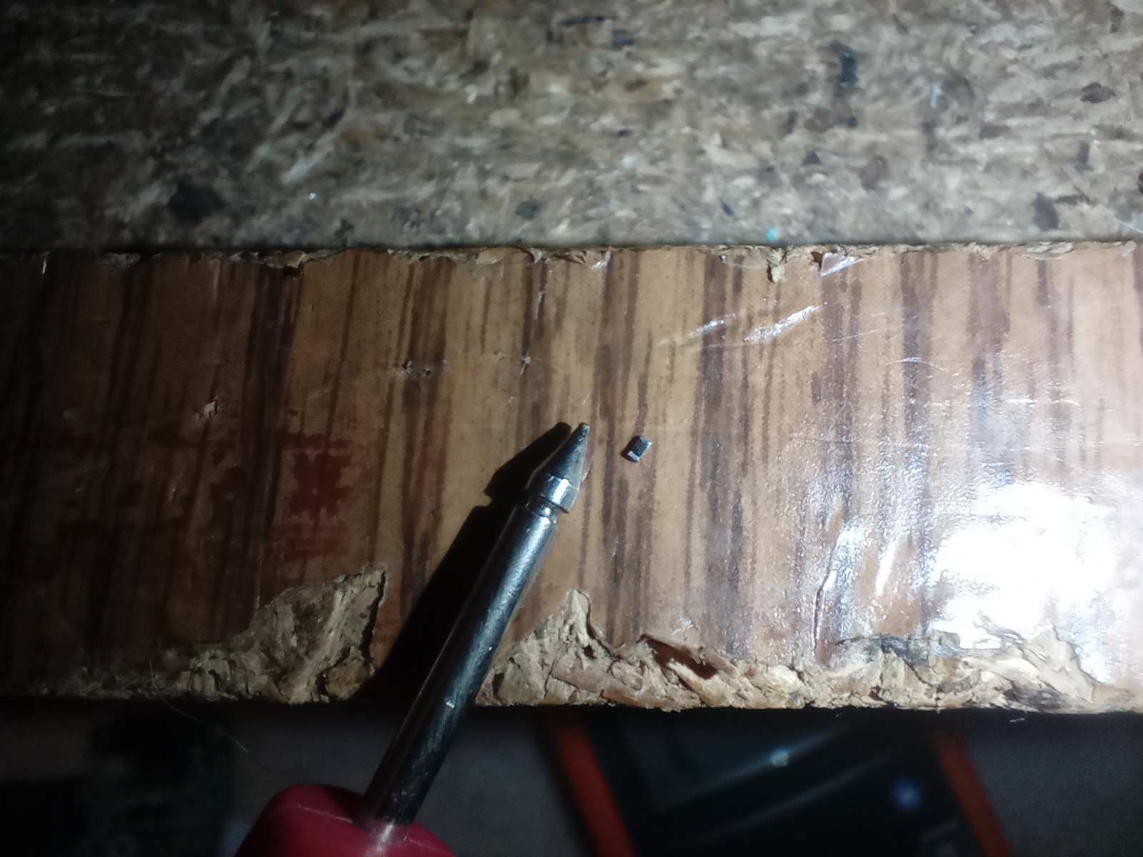

And here's the Resistor! It had no visible label, so I don't know it's value. ChatGPT suggested that it was probably a small V one, so it suggested to use a 1 to 100 ohm resistor... and I used a 100 ohm...
And here's the Resistor! It had no visible label, so I don't know it's value. ChatGPT suggested that it was probably a small V one, so it suggested to use a 1 to 100 ohm resistor... and I used a 100 ohm...View attachment 491823
