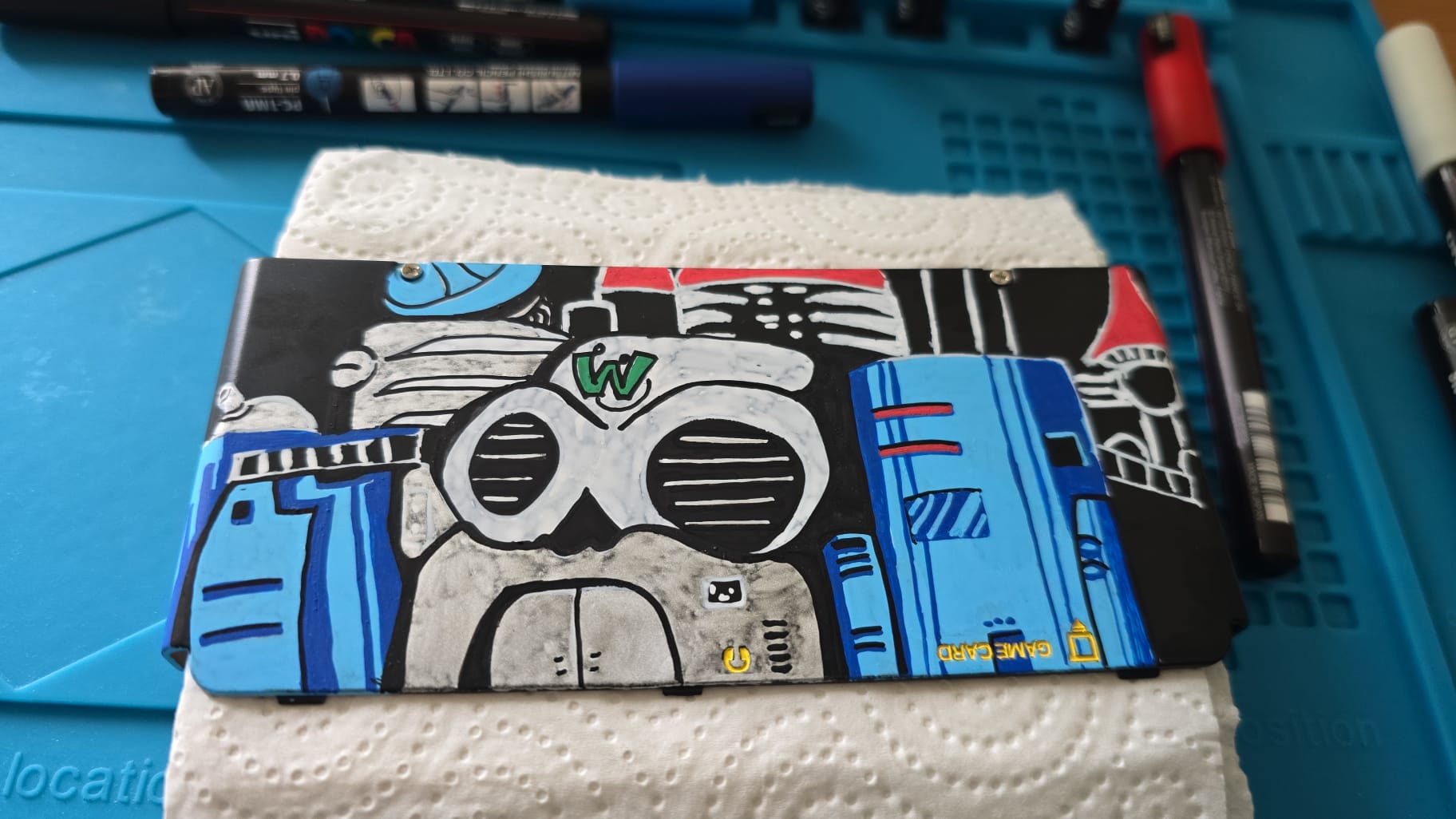

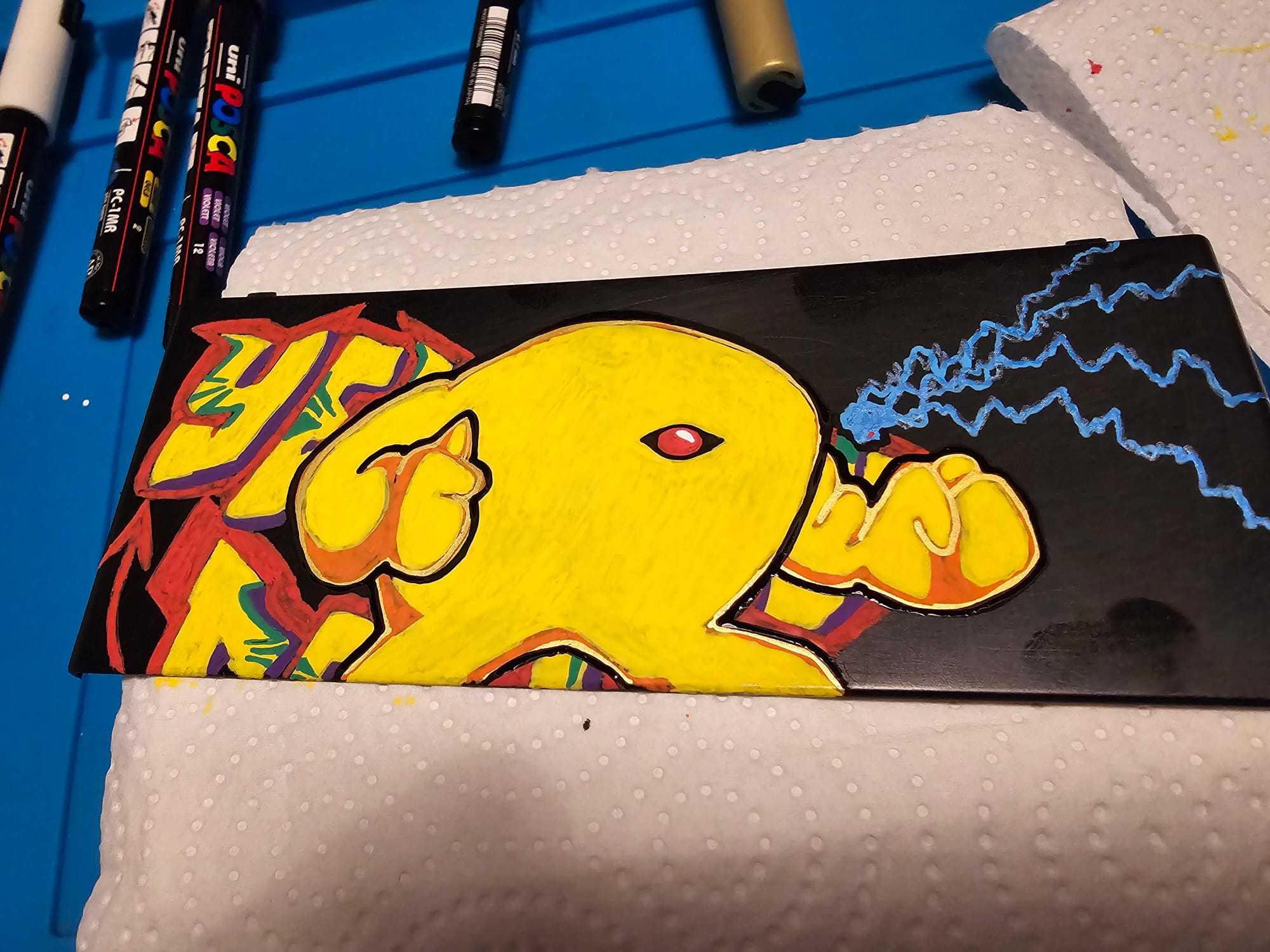

I replaced the top plastic lenses for glass (less prone to scratches), will add USB-C charging ports to the three and I'm producing a custom MegaMan faceplates set for my friend.
Top faceplate:
Bottom faceplate (unfinished, I have to complete the castle and will add an 80's vibe to it):

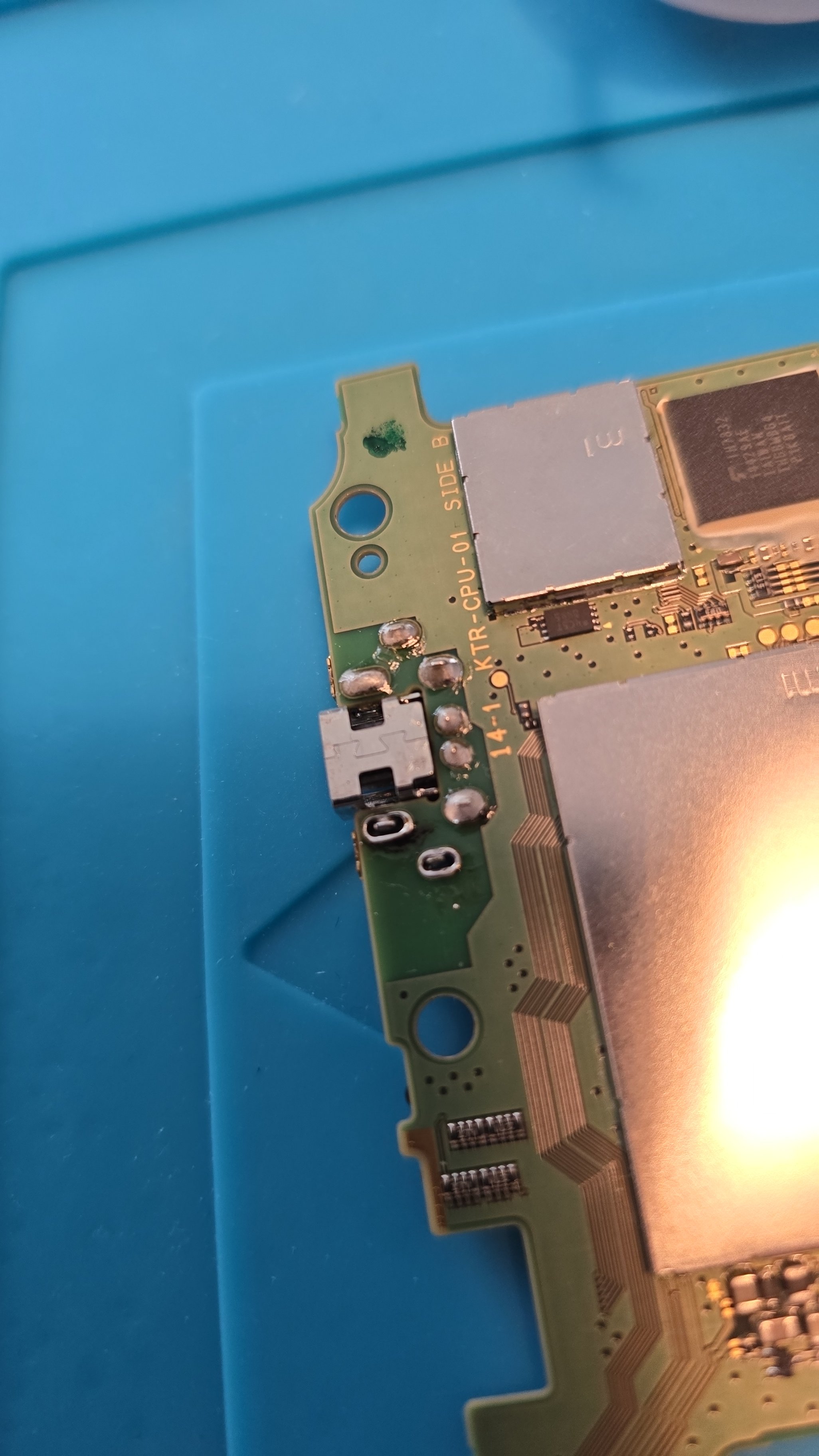

Finished the USB-C mod. 👌
The ribbon cables for the 3DS are far more sensitive than those from its older siblings.
Else, works like a charm. 🙌

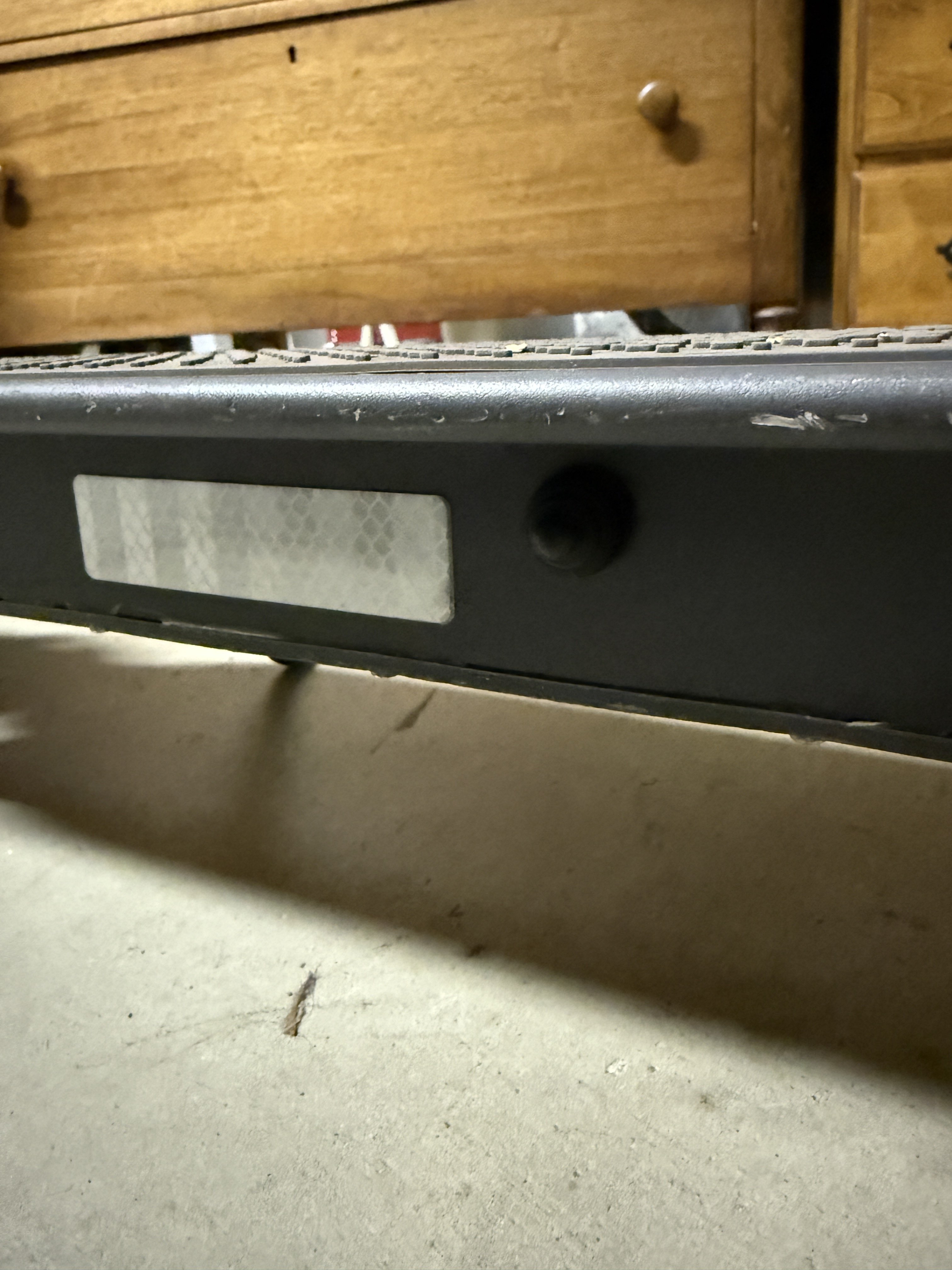

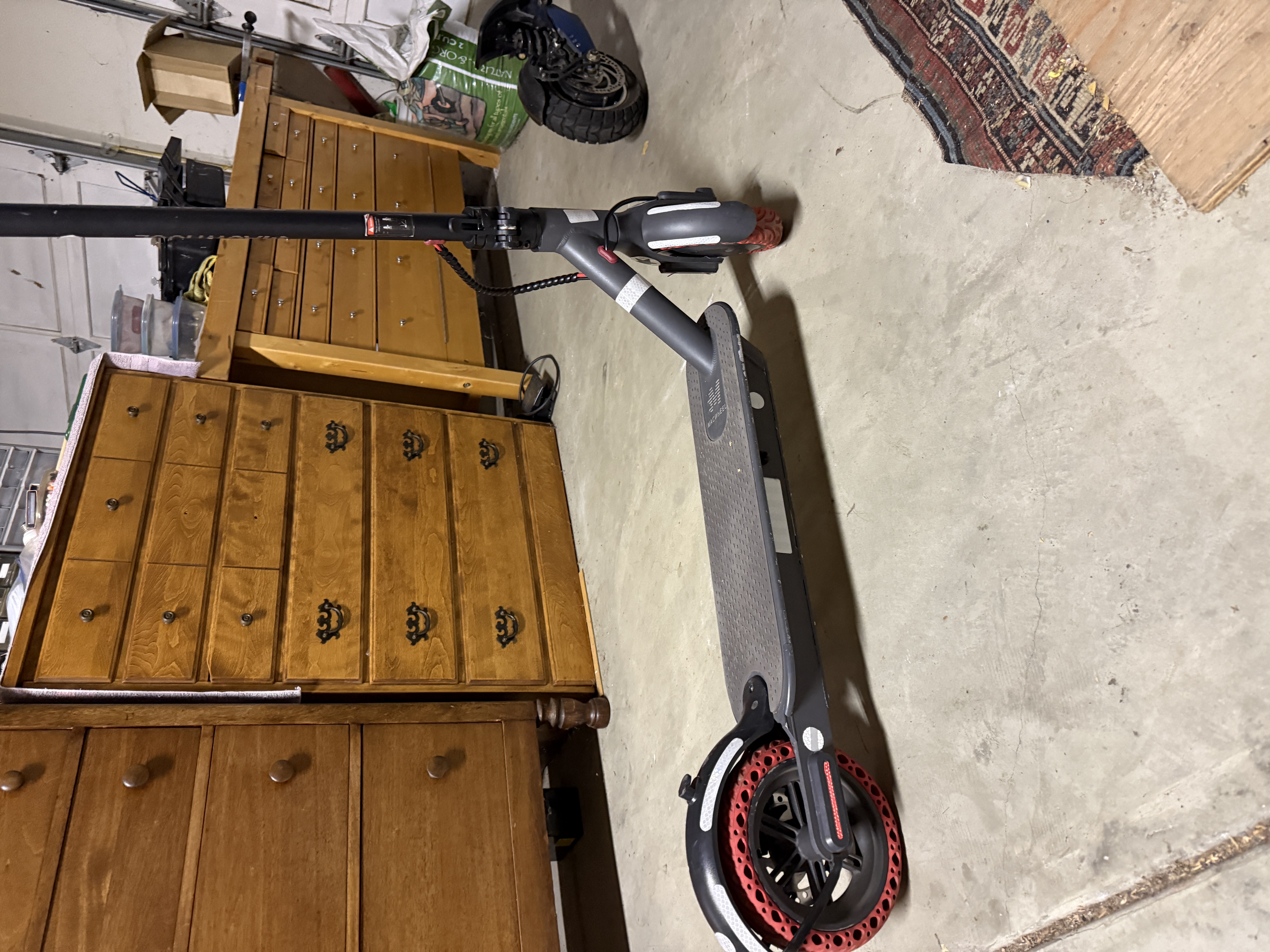

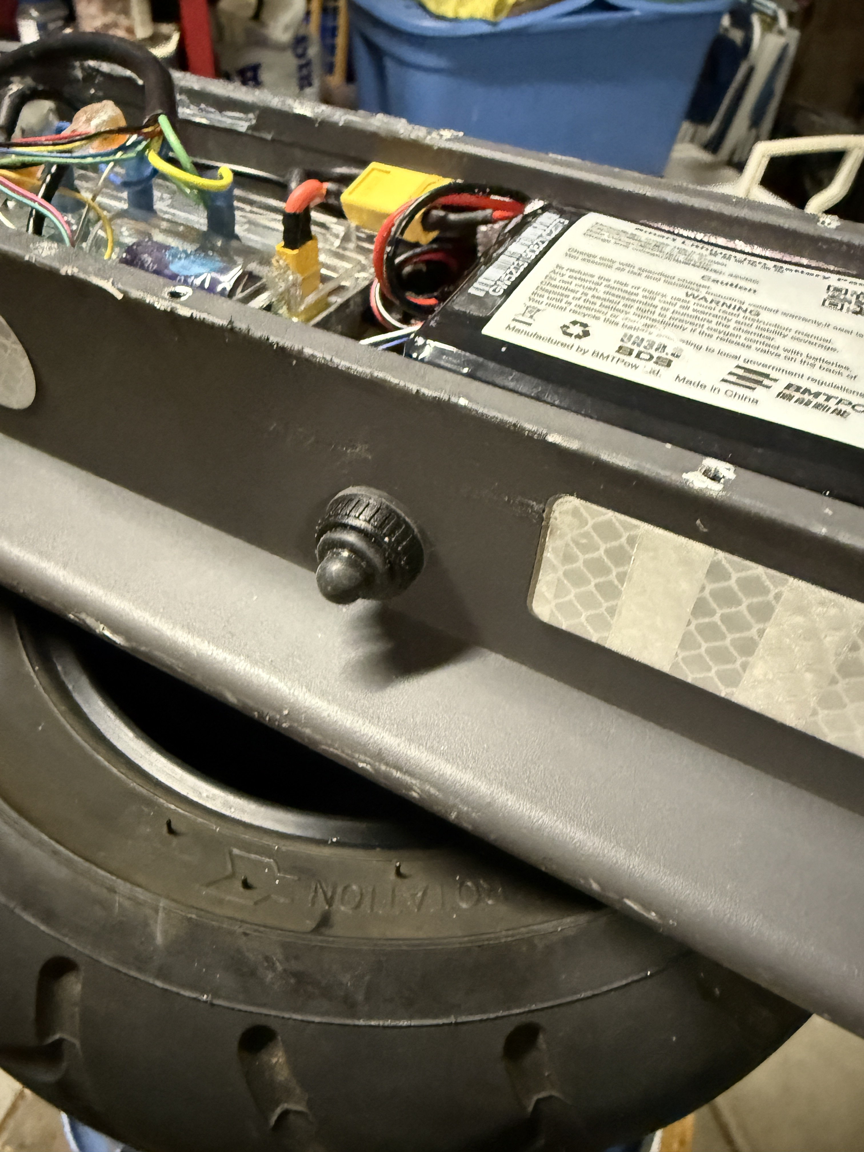

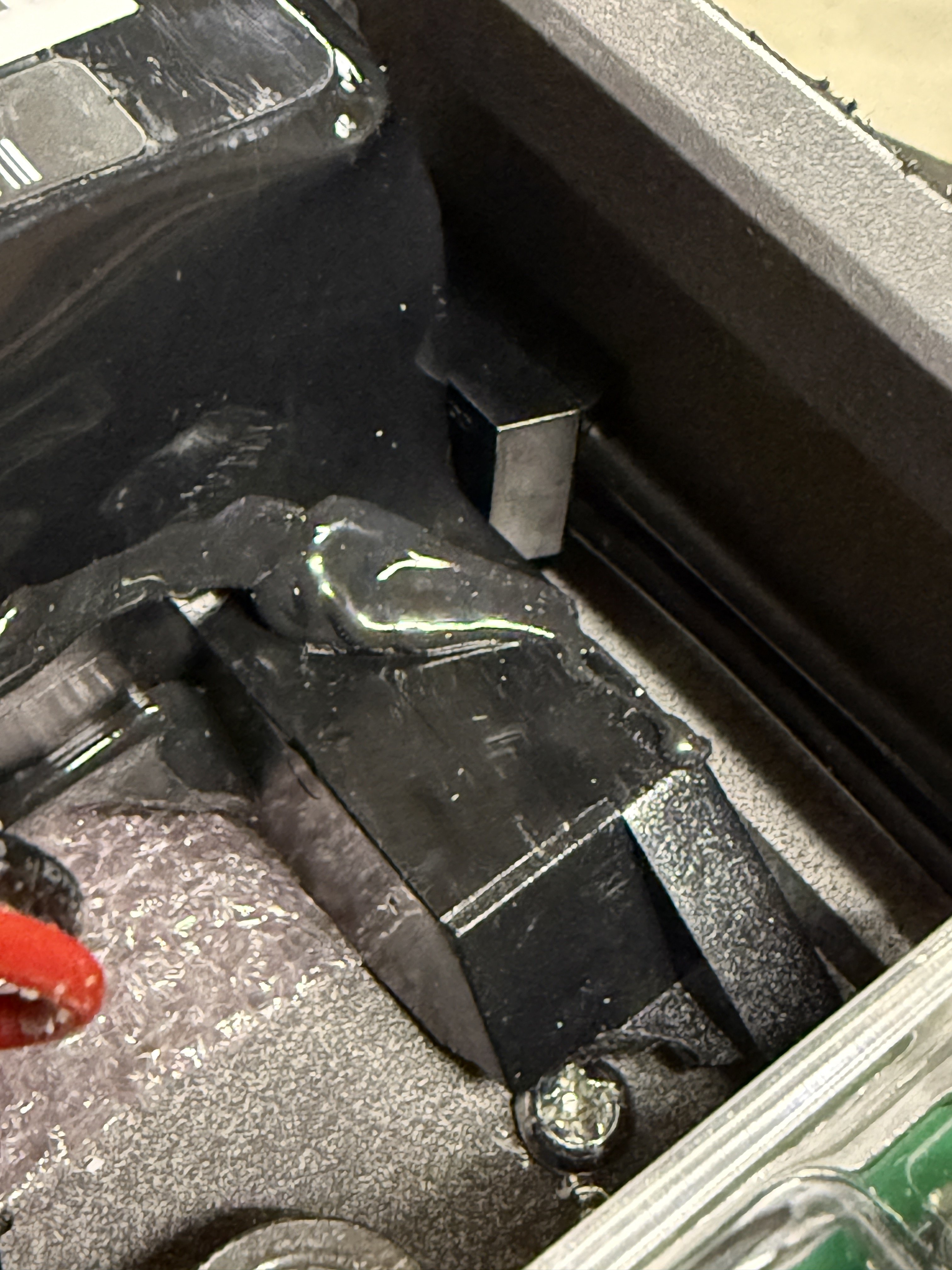

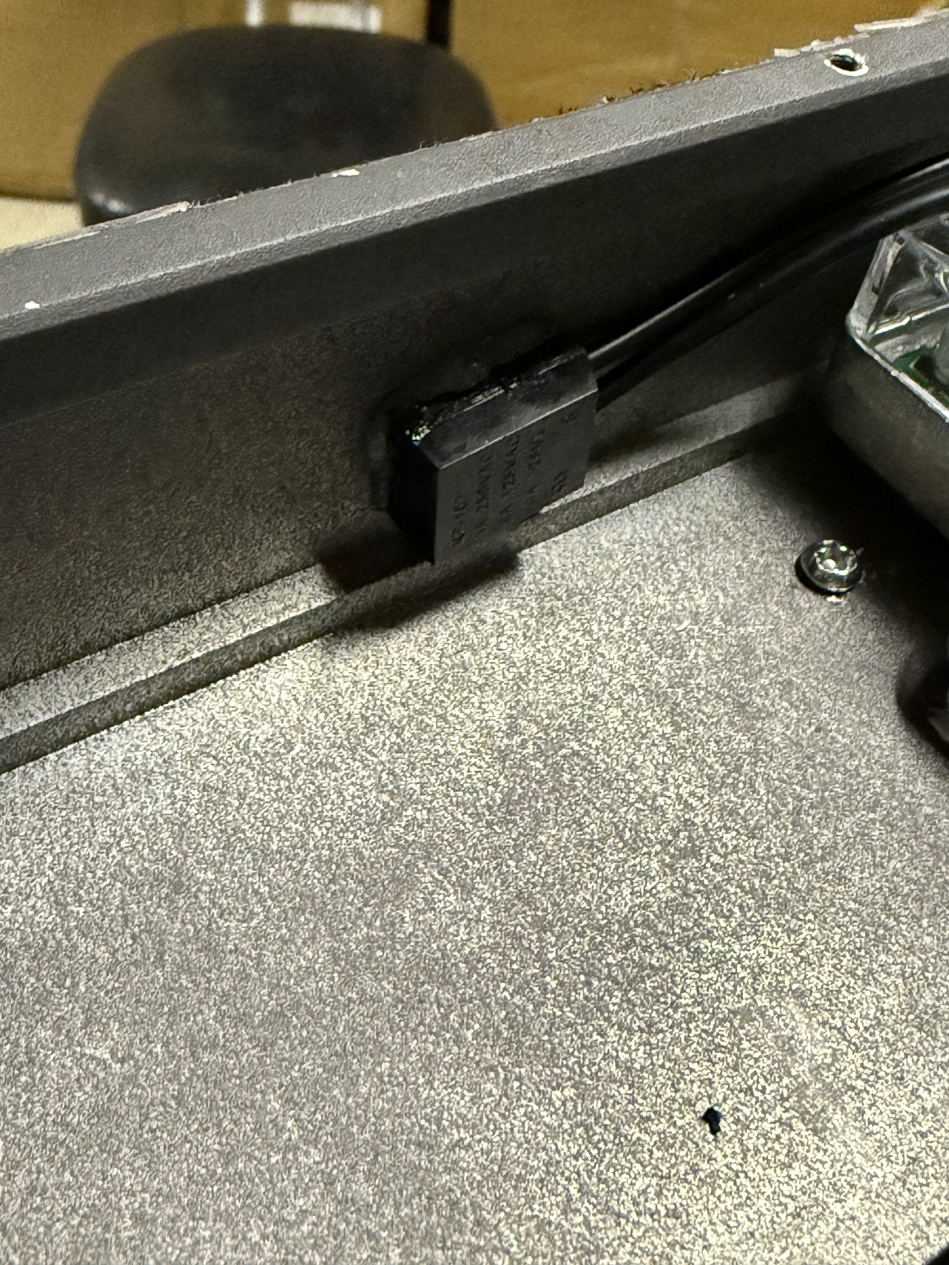

Installed a switch on my M365 scooter clone. Just like this one at https://a.co/d/322t7ZT
It’s used a master switch. I have hidden it under the deck. With it off, you can not power the scooter. If you try, the tail light slowly blinks. Throttle, display, and brake won’t work. With it on, you can normally turn the scooter on and ride!

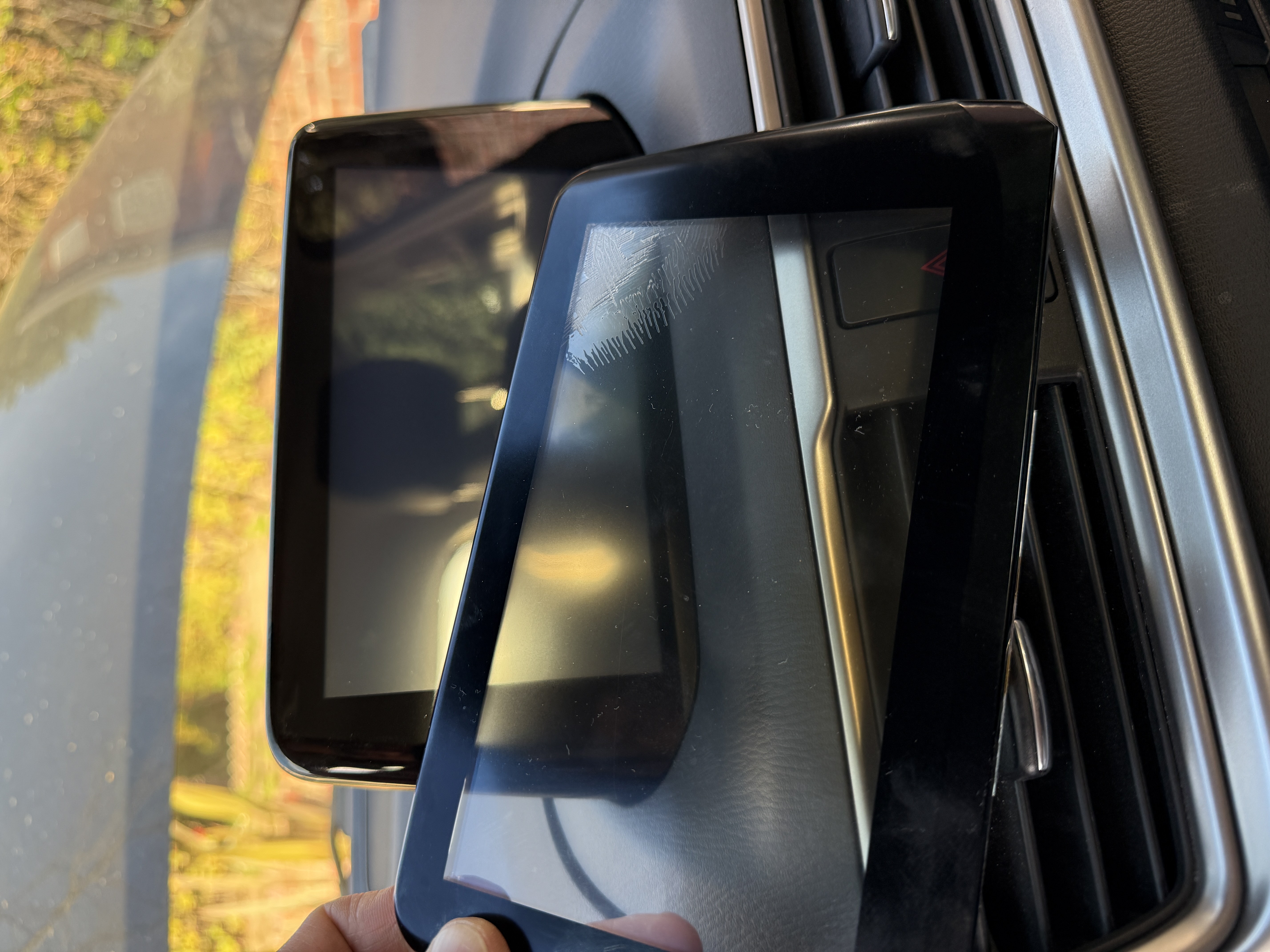

I’m not pretending to be a mechanic or anything. I had a gnarly delamination process beginning and ordered a new screen before “ghost touch” became an issue. Got the new screen last week and installed it today. This is on my 2018 Mazda 3 Hatchback.
