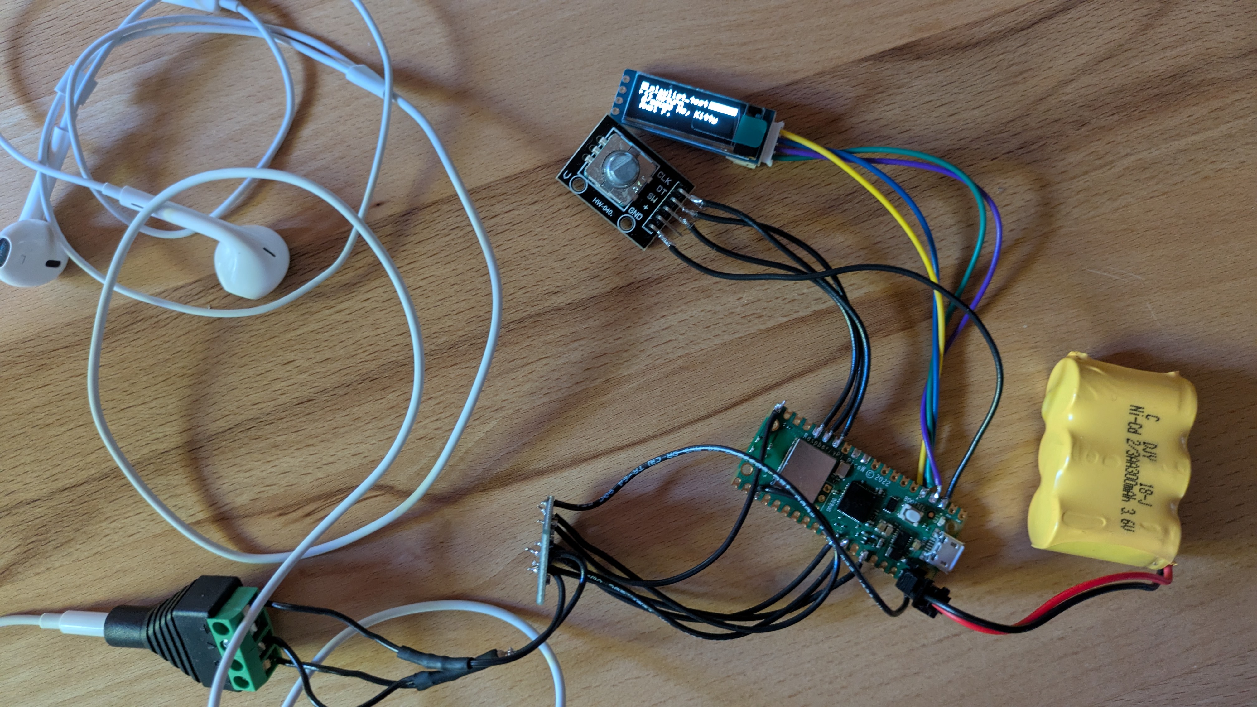

Since Logitech has shut down its server and my Squeezebox kitchen radio no longer works, I have built my own radio server. The setup actually only consists of a Raspberry Zero and an Ethernet/SPI bridge. The built is a bit older, but despite the housing, I always had contact problems with the fine winding wire. With the new cables it should now hold. I'll just use some tape for the new housing. Pretty ugly, but it works.

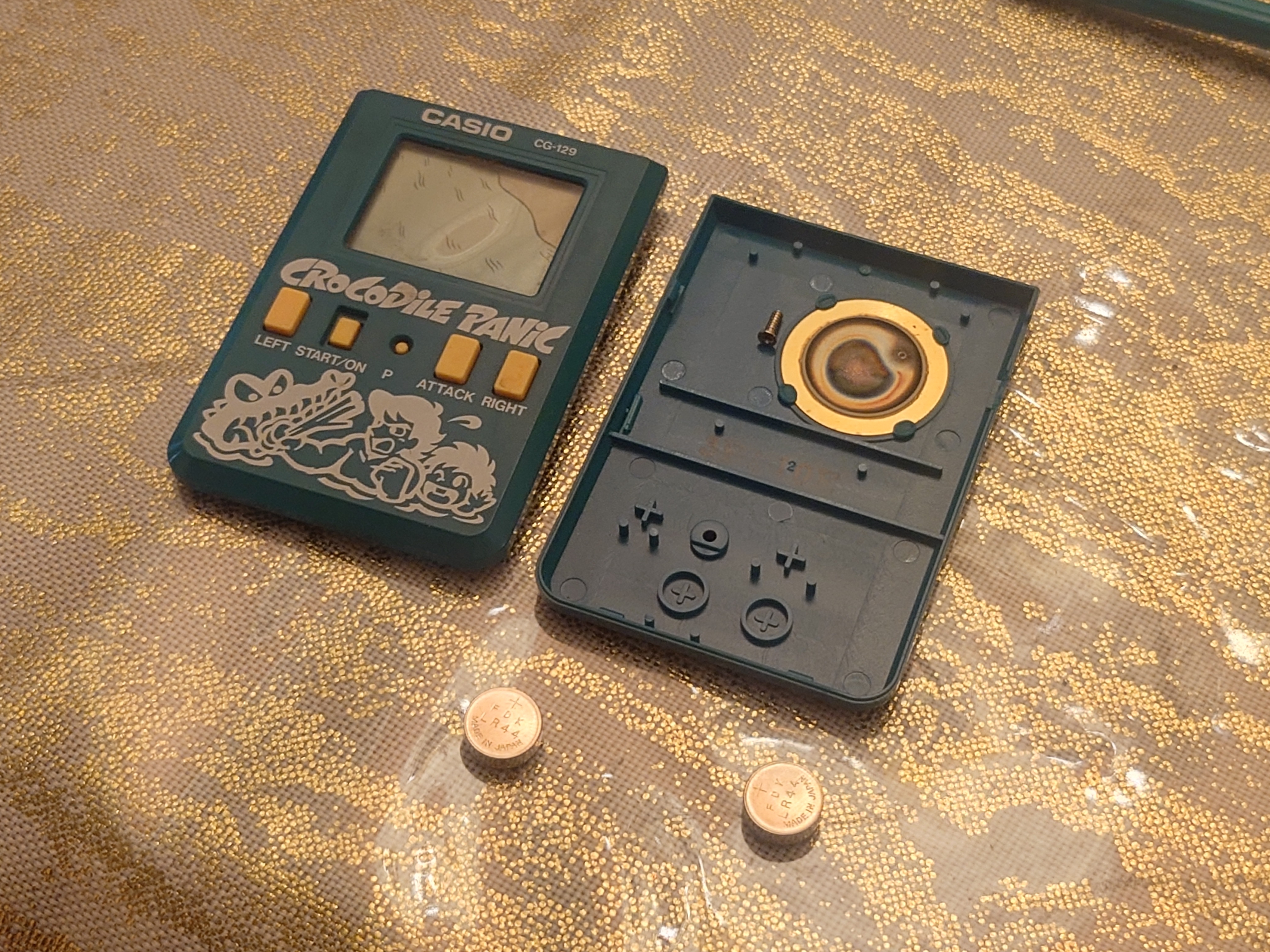

Reshelled both of my SPs today. Put the 101 into the transparent blue shell that my old 001 was occupying, and put my 001 into the free black shell that RetroModding sent me by accident and told me to keep it.
Luckily the black shell did come with a free plastic lens so I was also able to remove the scratches from the 101's display that way.
Also had much less trouble removing the hinges from the silver shell and put them into the black one, that was nice.
All in all I'm very happy with this. Sadly I can't find the smoke black volume slider cover, which I'm fairly confident I have. The 101 has the slider that can be replaced, so that would've been fitting. Maybe I'll find it eventually, or I'll just buy another set.

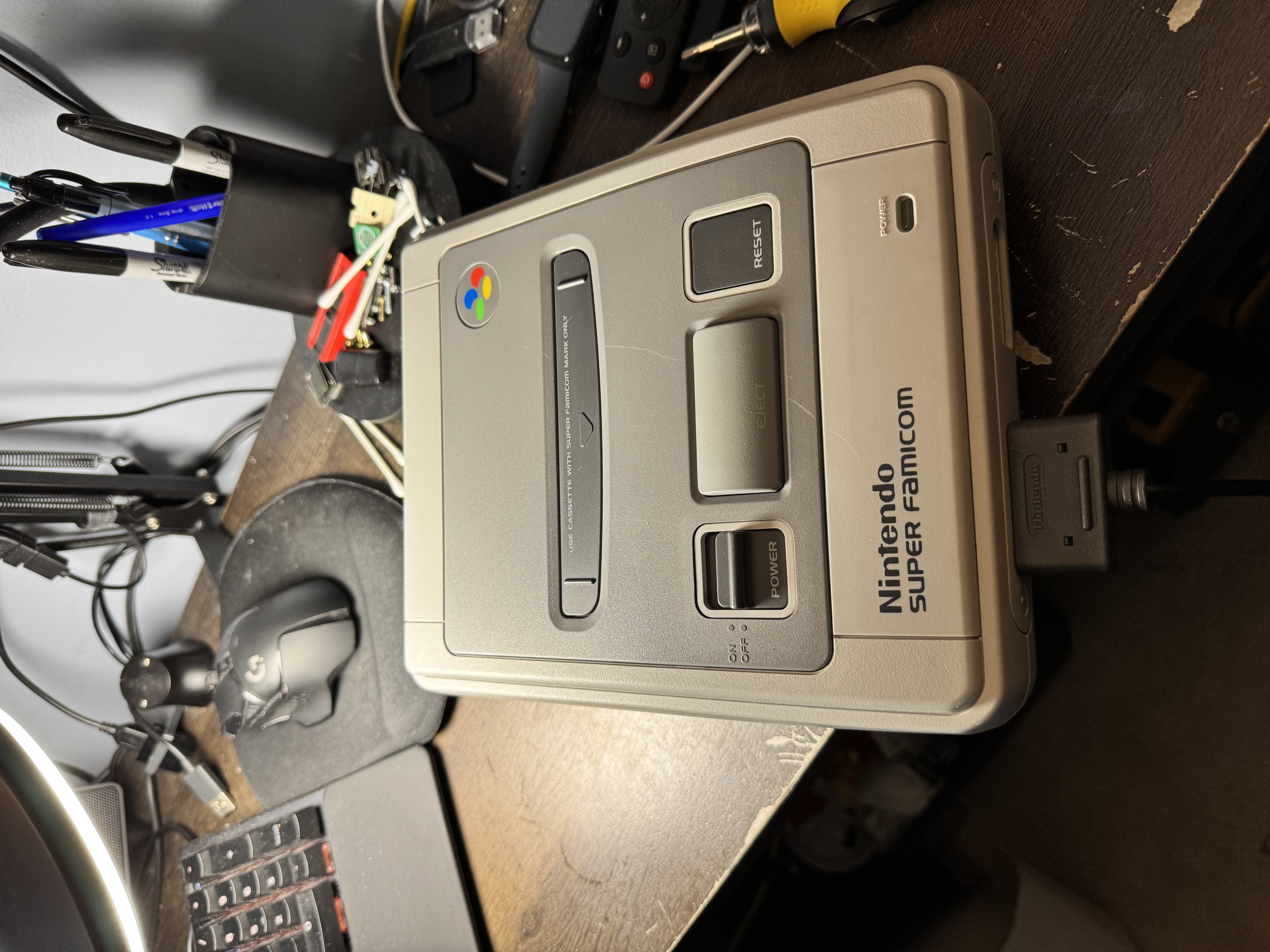

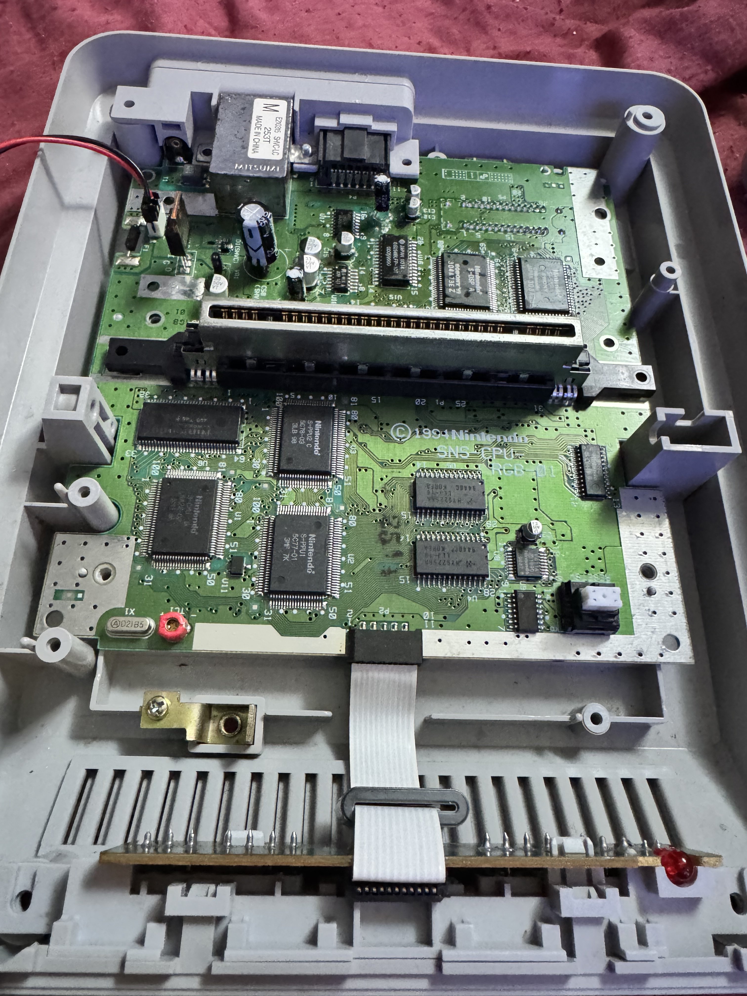

SFC with APU error. Swapped 4 of the sound chips before I got the correct sram one. Part of a lot I got from Japan. It was the cleanest one of the bunch and thought it would be the one that worked but nope. The one that worked was the dirtiest one. Go figure! Also, recapped.
