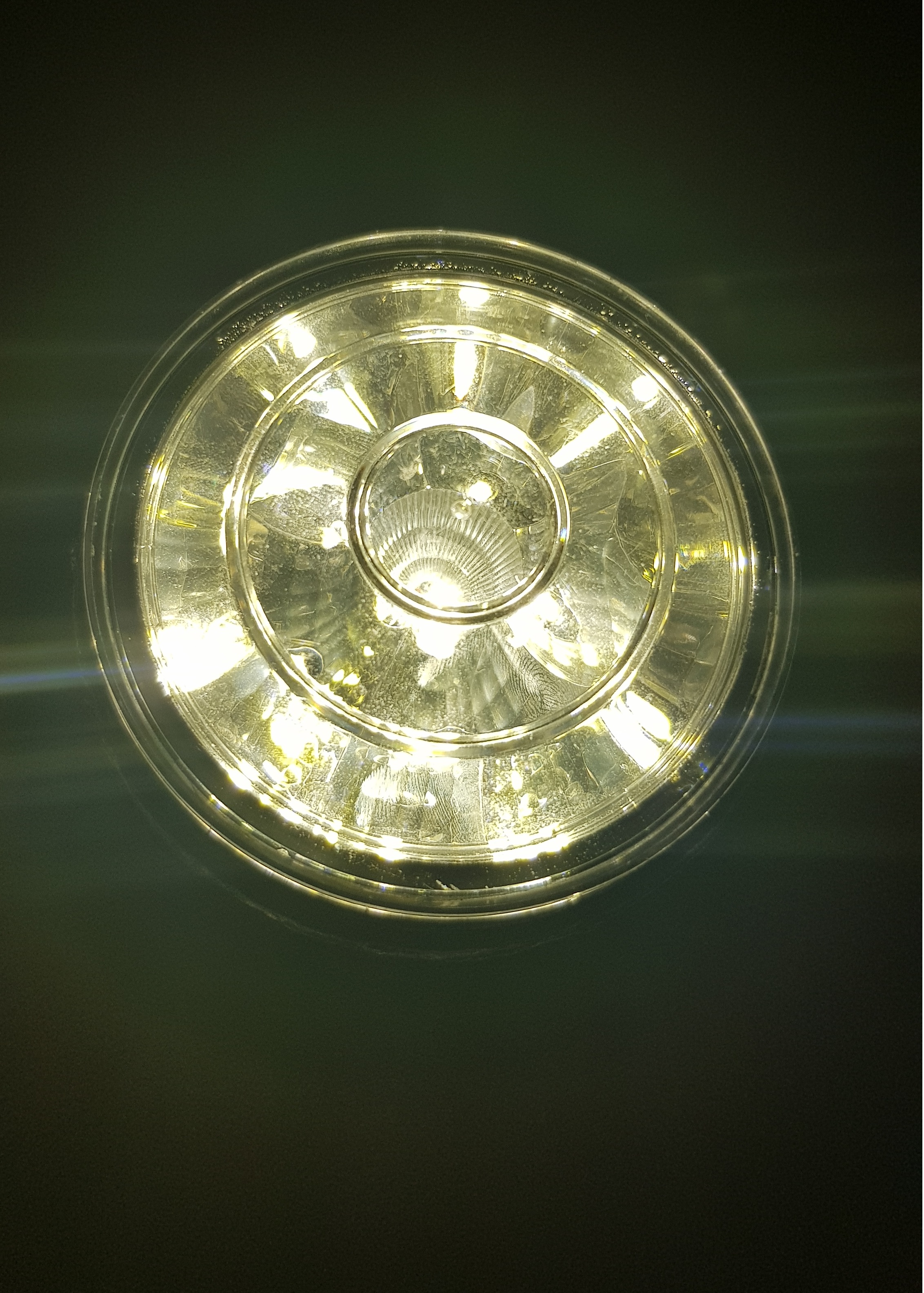

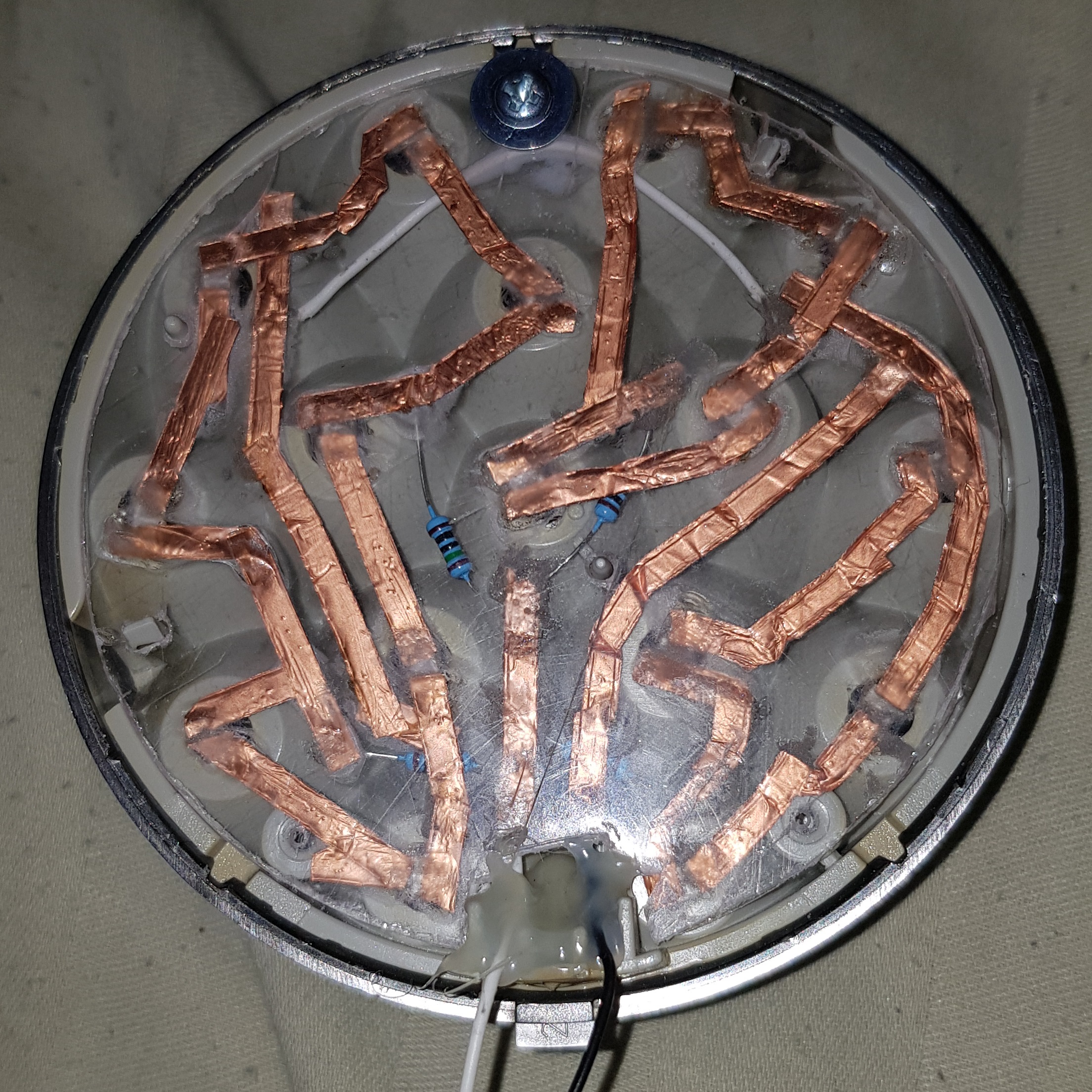

Other than that I've repurposed an old taillight by making myself a new circuit board out of a CD case and some copper tape to make a rechargeable light (with the addition of an old vape battery + tp4056 board), and I did something that I would never normally do and that is spray painting a controller. Under normal circumstances I'd leave things looking stock, but this controller is a frankensteined one made from two broken controllers anyways so there's always the other shell to swap back to.
The light:
back of the 'circuit board' :
Lighting it up:
And the controller:

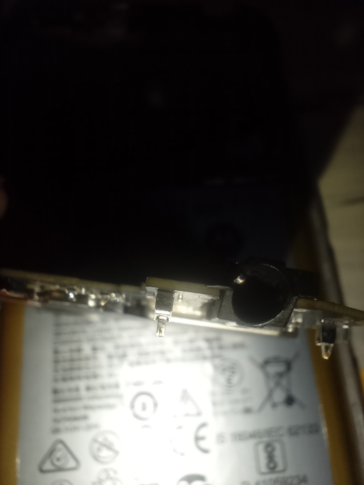

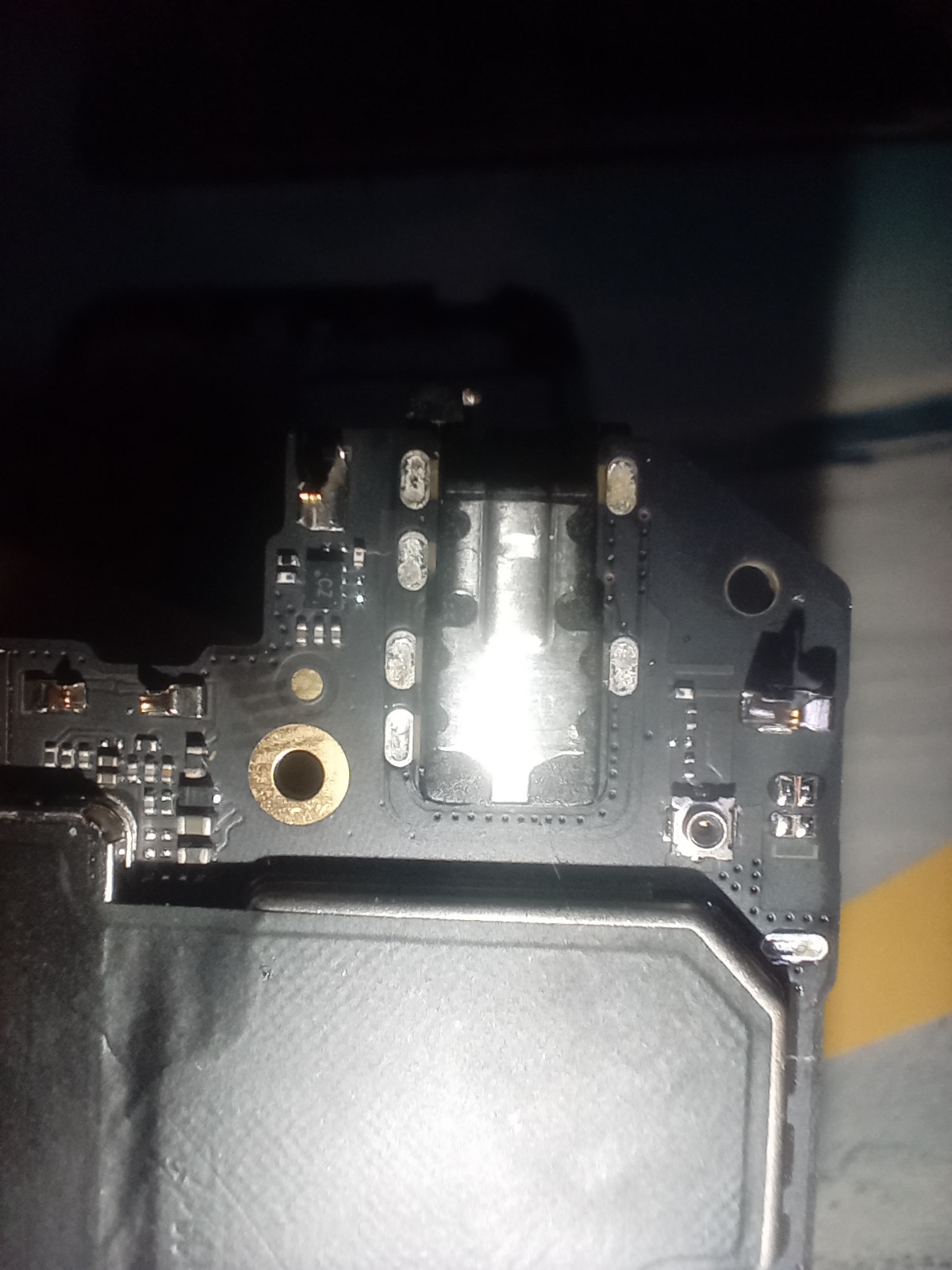

I just fixed my stupid phone.
Plugging and unplugging my Headphones broke something inside the 3.5mm Audio Jack... when I unplugged my headphones, the phone thought there was something plugged still, so it blocked the speaker, naturally.
So I had to disassemble, and had to check if all the pins in the Jack were grounded, but no, fortunately, it probably was the internal switch (usually a small metallic prong).
And then I just bent a little that tiny speck of metal while the phone was on until the headphones icon disappeared from my screen.
And then, it indeed disappeared from my screen, then plugged in my headphones, and the icon came back, then unplugged, and the icon returned, did it three more times and I think it's fixed now.
Before I disassembled my stupid phone, I tested how to take it apart with the one that was actually mine and that my dumb niece kicked and broke.
During the disassembly, I broke the main Camera connector, so, it it had been this fucking phone I wouldn't have camera by now and I would've definitely yeeted everything to the wall.
In the meantime, I cleaned with IPA the cameras and the plastic cover on the case...
It's working now. 🥴

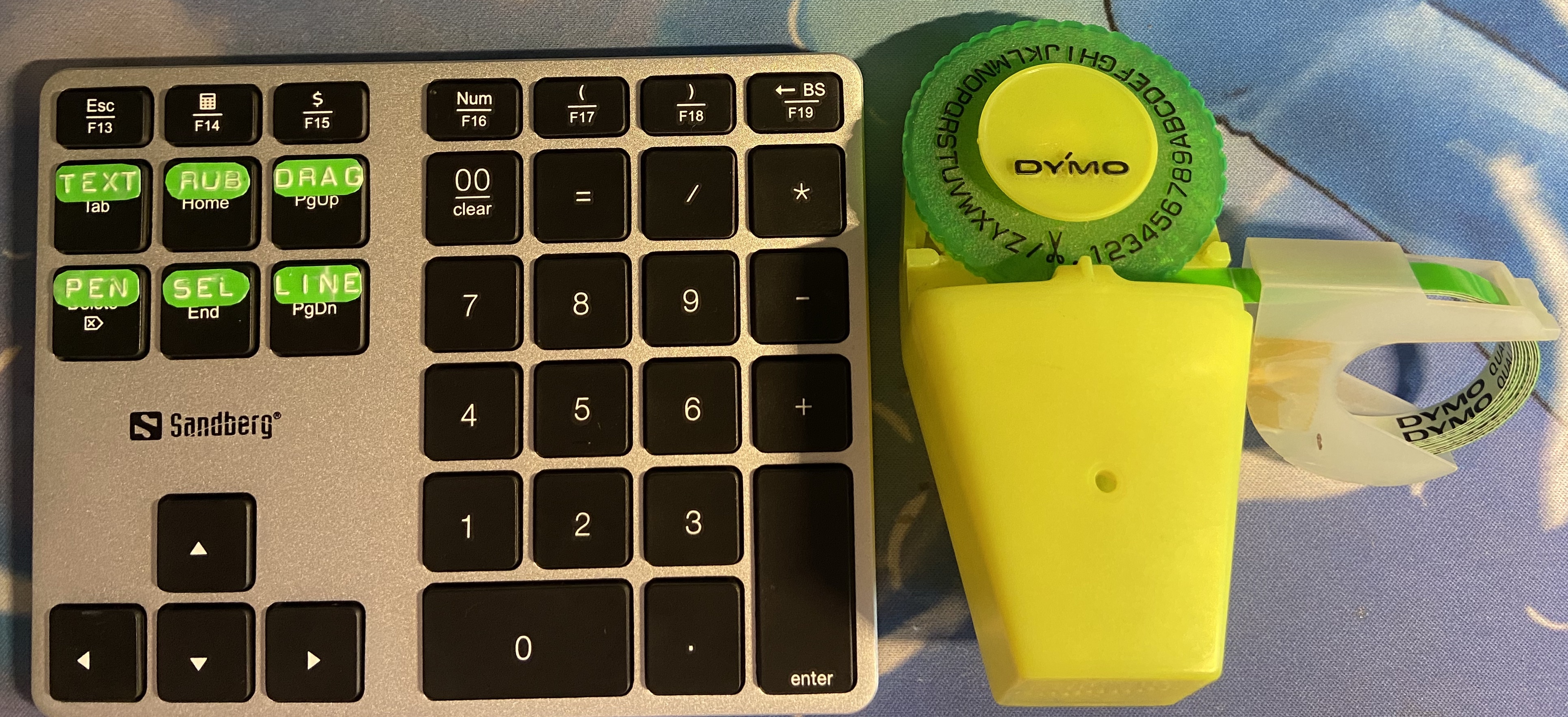

Acquired a cheap Bluetooth numpad and remapped some of the buttons to the keyboard shortcuts for the drawing tools of the online whiteboard I tutor with (NB pencil erasers are called rubbers in British English). I made labels with the tiny manual Dymo label punch I have had for, like, three decades and barely used. The adhesive on the also-decades-old label tape is still holding up!
Fun fact, when I first got it, I didn't understand that the scissors symbol is for cutting the tape when you've finished a label (which also needs a firmer grip than I had then), and was disappointed I couldn't type this cool icon.

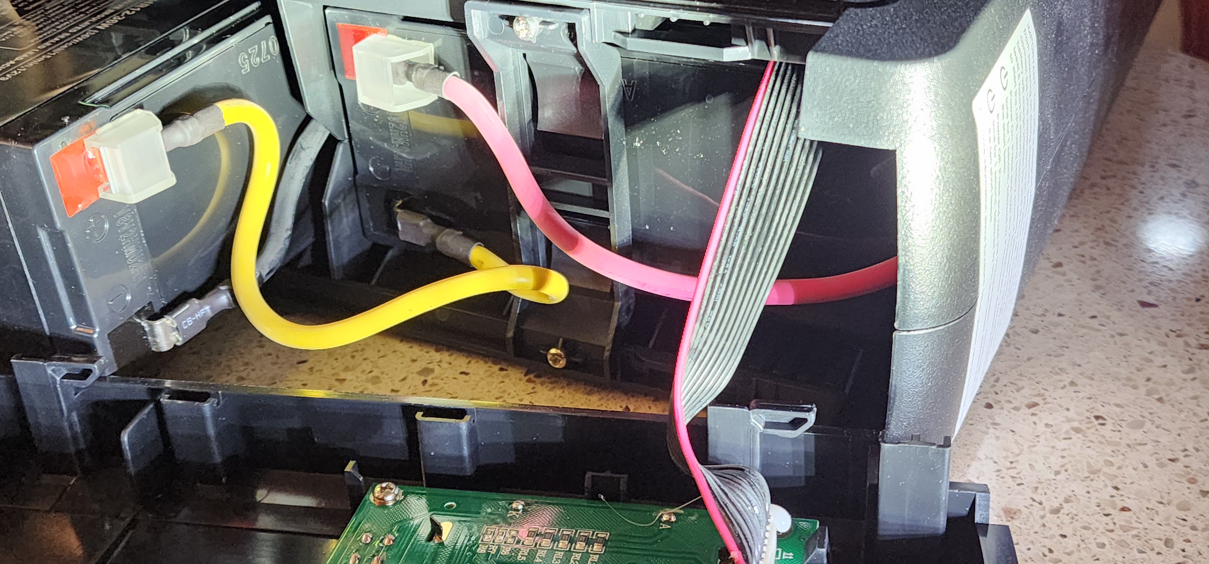

Just fixed a CyberPower 1500AVR. It died a couple of weeks ago so we got new batteries and I finally got around to fixing it..
Nothing too stellar, but it's nice to have it functioning again. Pair of batteries is roughly $43.00 off of Amazon. :)

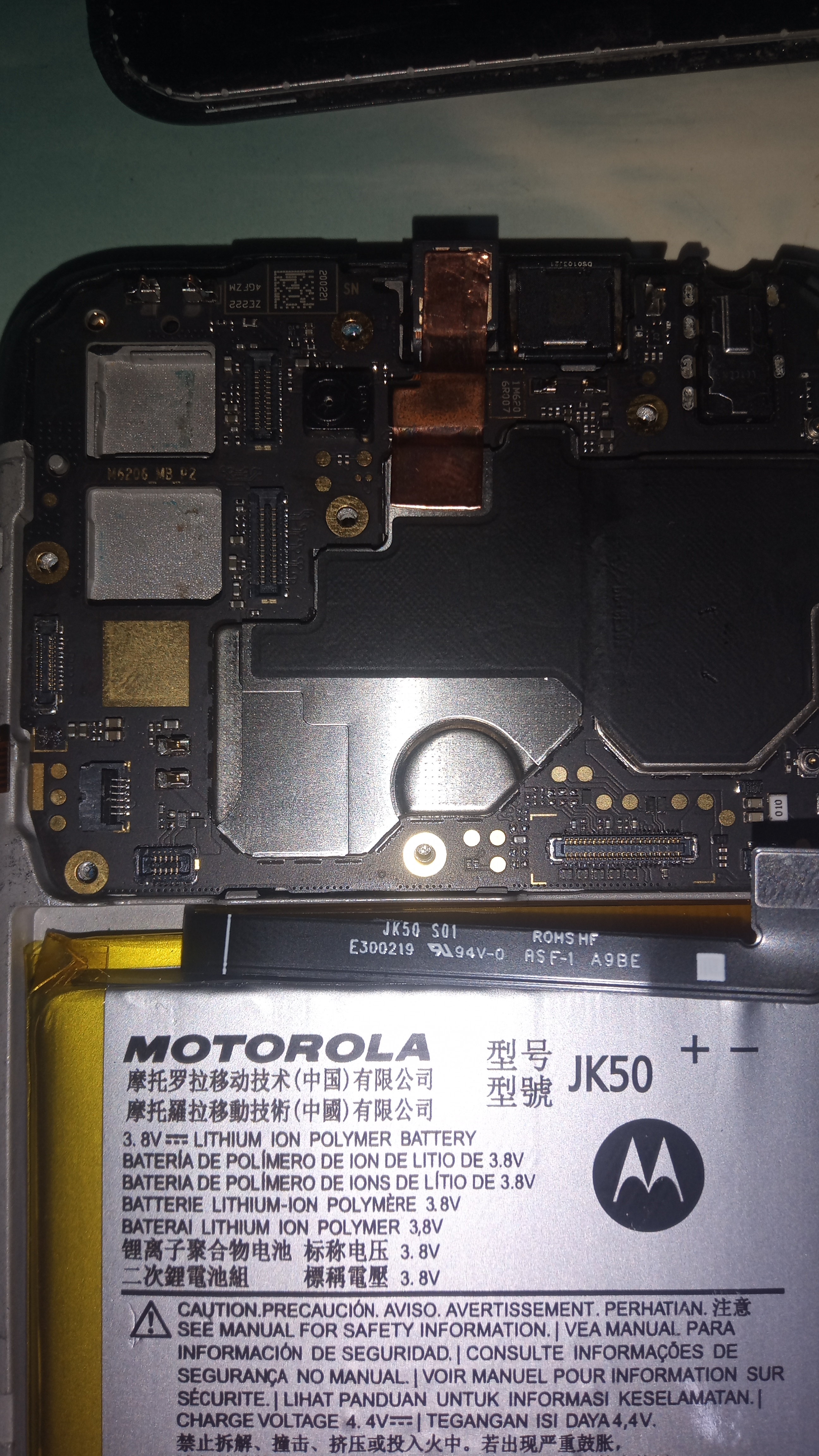

Fixed my mom's Motorola 😎
Motorola what?
