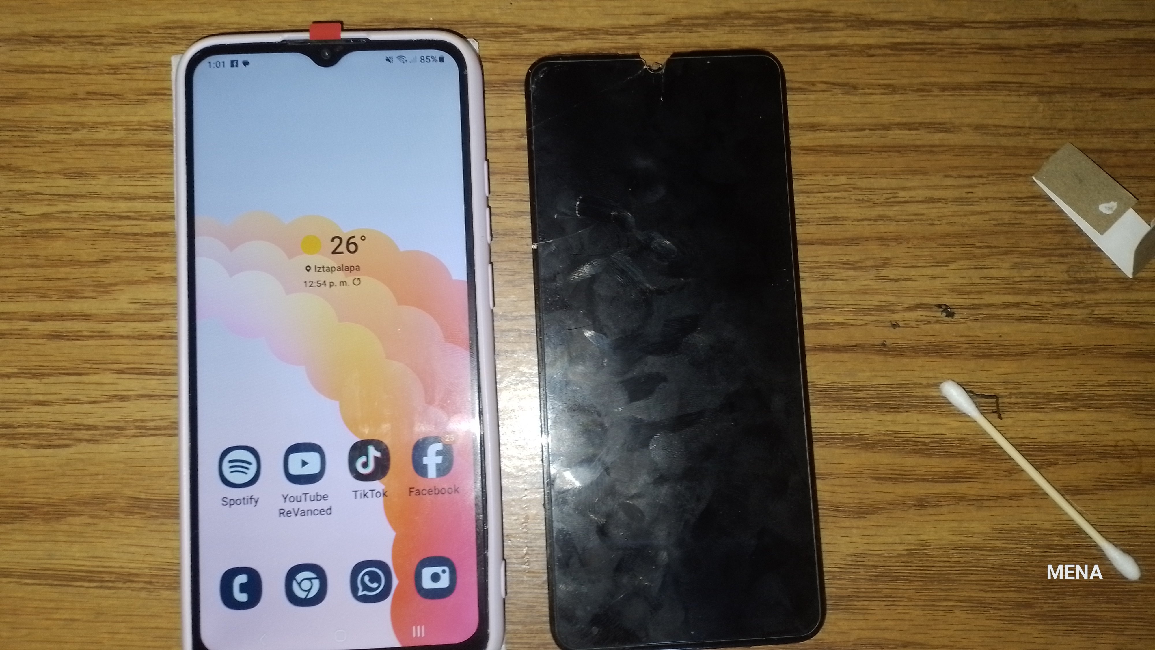

Get an otter box also, Mine has saved me from some High falls. Like from the stairs at my old place [midway from 13 steps] bouncing all the way down. But, Nothing happened to it. Nada.
That phone ain't mine, is the one I bought to my momma couple months ago.
I'm not sure how she got the screen so badly damaged but it's not hard to guess how when my 2 (now 4) year old niece broke my phone after she kicked it.
Whatever, I'm glad I could fix it. The screen costed me $200 MXN, and looks really nice. Glad I have the skills to do this job, outside it would've been $800 for Display + $800 for "job".
