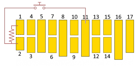

As good size/shape 'normally closed' buttons seem difficult to get hold of...
Would it work to have a resistor from 2 (Card Detect) to 1 (GND), but have a 'normally open' button from 2 (Card Detect) to 11 (1.8v) to bring the line high? Wouldn't that do the same job?
Honestly im not sure how you’d fit a resister in this thing safely. The shell does not have any movement room to spare really. Thats why the shell is held together with a screw and has those hooks for the bottom half
There’s no room anywhere else except the outside edge

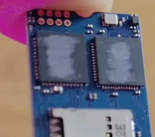

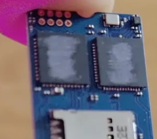

Another question, are those 8 holes at the top actually connected to anything? Can they be used to secure a button to?
Yes some go to the pins others go elsewhere
I measure em with a multimeter and there’s one to pin 1 and a bunch of ground which is all that matters

I'm a bit surprised no one noticed that the V2 Migs have new firmware that allows you to switch games backwards. To switch backwards you need to long press and that would trigger the gamecard removal detection long before the Mig has a chance to register a long press. Conclusion is that the detection pin is likely handled by the ESP32 or FPGA and the button is an input to one of the 2. The button does not control the removal detection pin directly. That also means they are likely using a standard normally open tactile switch.
