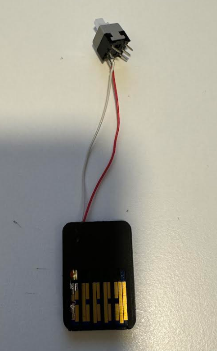

If anyone is interested, i did a easy test mod button on version 1 ;)
I cut pin 1 and soldered cable on each half of the pin to a button that should always be closed but opened when pressed, i just tested with what i had at home ;) and pin 2 did get some solder on it which can be ignored :P
And it do work great, i might look for a better button later but i dont use the card or dumper so much, i just wanted to try if it was possible ;)

If you or anyone can help me find an always closed button that’s small enough to fit inside the mig shell. Please let me know. It’s been the biggest thing holding me back from making my custom shell a “v2” shell

Aren't the pin holes on the top left of the motherboard specifically for a button? Why didn't you solder directly to those?
Sorry i an not that good when it comes to switches, if I do understand and find one that would work I will add it here, until then I guess maybe hopefully some one can help us :)
Nope, they are made for that pcb to different points, as pin 1 was not devided there aren’t two points going to upper and lower part of pin 1, doh one of them might be possible to use ;) it might be as easy to use the ground point at the top and just have one cable going to the lower part of pin “one”

The lower pin is just ground iirc I was looking into this not long ago.
There’s 100% multiple ground debug pins in that array and any of those should work. And if I used my multimeter correctly one of them is also connected to pin 1.
So in theory you should be able to just split the trace manually and use those debug pins still (assuming I didn’t make a mistake)

I just ordered some switches similar to the ones that it looks like mig switch are using according to the leaked images of the v2 board. Can you post a picture of the pcb board with the wires attached? Maybe I can make it work with the switches I ordered and I will post some pictures when I get it working.

You just need to split the left most pin down the middle (there’s a comment above yours explaining more)

I'm hoping someone at some point gets either a schematic or a bare-board pic of the v2. Would love to check the differences and try to modify a v1 to work exactly as a v2.
At the moment cutting the left-most trace in half and soldering a button works to eject the game and move to the next game, but afaik would lack the function of long-press to move backward which would be great to introduce into v1 as well.

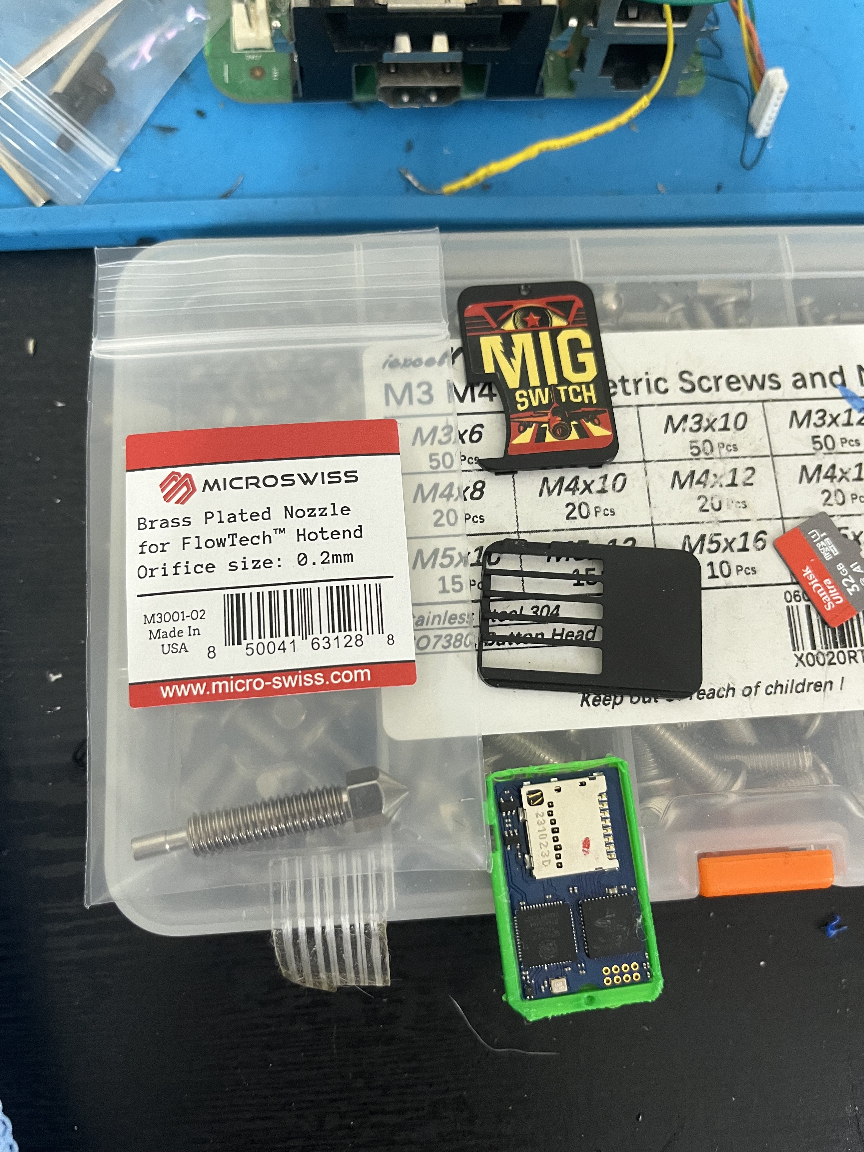

does anyone know the size of the screw holding the MIG flashcart shell together? It’s a bit too tiny for my calipers and trial and error isn’t fun with a single screw hole lol
