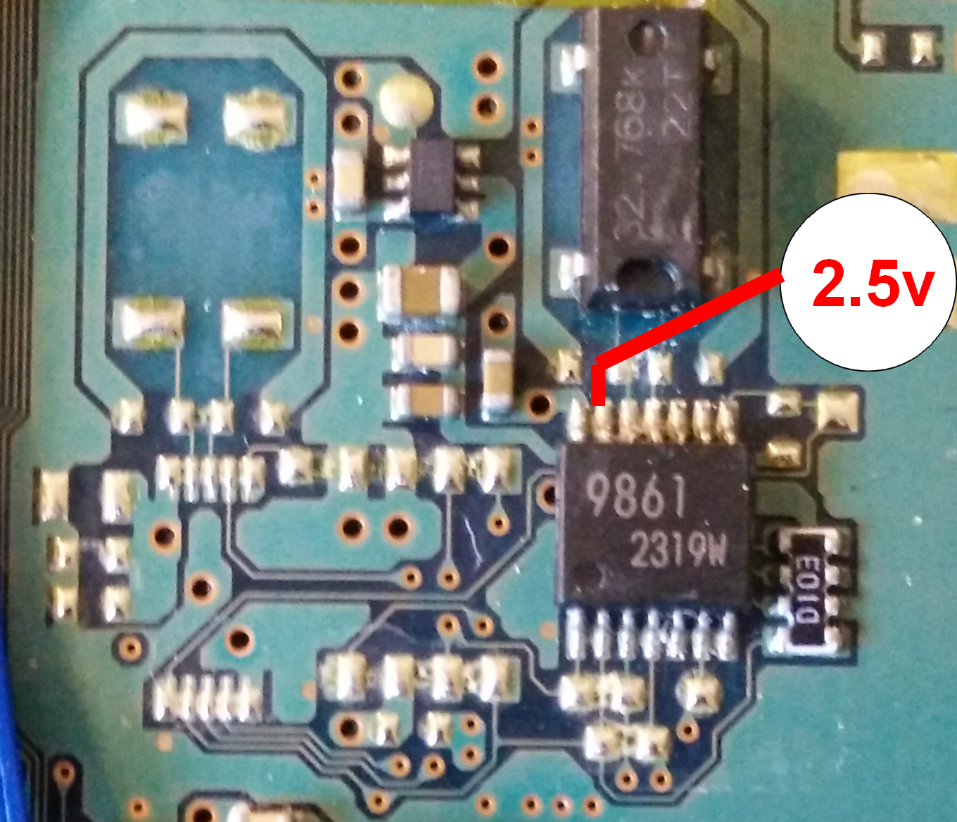

The Timer/EPROM chip seems to be correctly powered (PS2 unplugged) :
Reactions: zfreeman

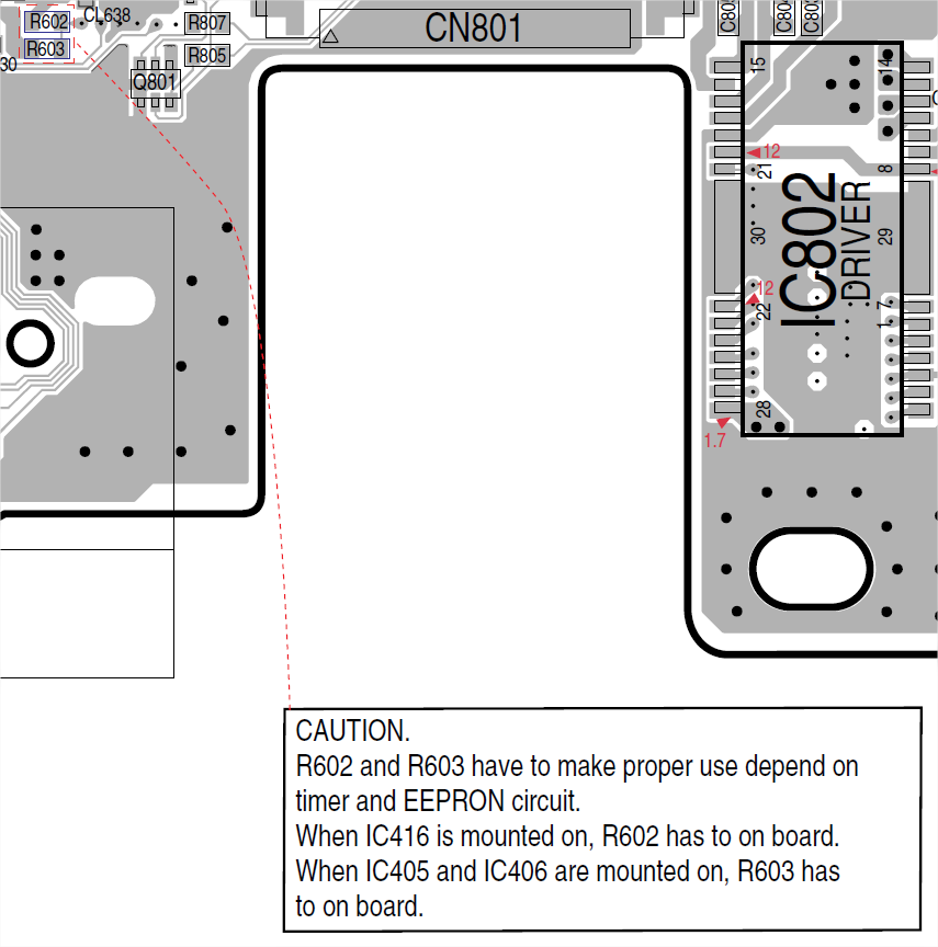

This motherboard can host 2 types of EEPROM + CLOCK. IC416 or IC 405 + IC 406 (they split EEPROM and Clock for some reason on some models). Mine has IC 416.
And if you look at the manual :
The resistor was soldered on R603 !! I moved it to R602 and BINGO MAMBO !! It works.
