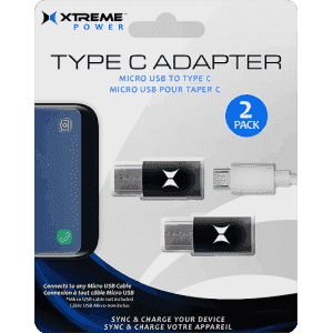

I thought we should start a list so everyone can know what cables are properly suited for the Switch. Please only add to the list if you have tested the resistance yourself or if your Switch and/or PC,phone, etc. was damaged. The resistance should be at least 56Kohm to be considered safe according to Google employee Benson Yeung (who nuked some hardware before he considered testing cables).
Xtreme Power USB A to C adapter
Model XCB2-1013-PP1
Tested @ 60.8Kohm
