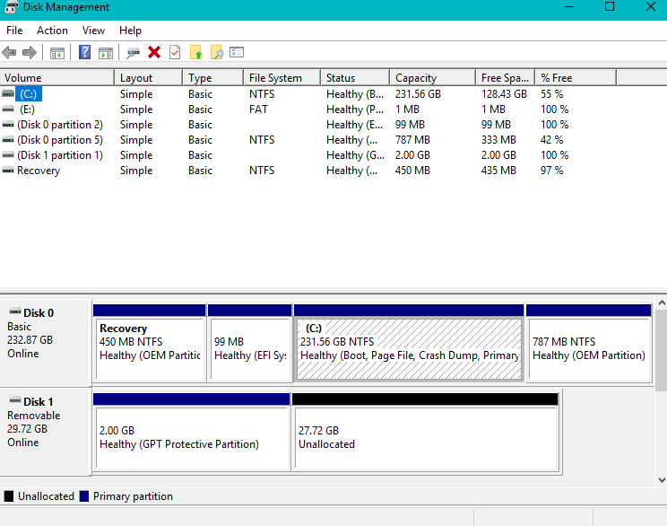

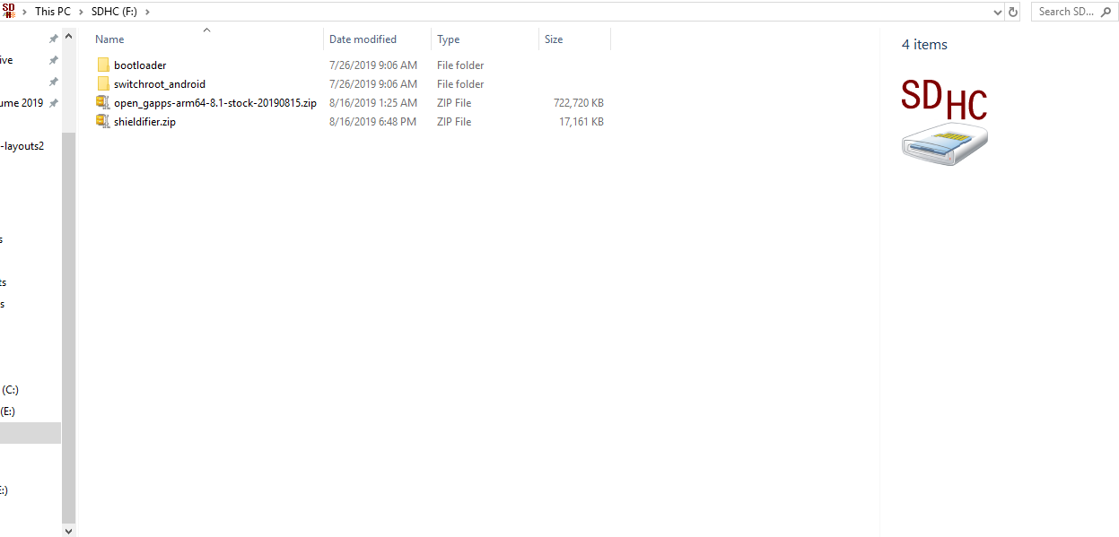

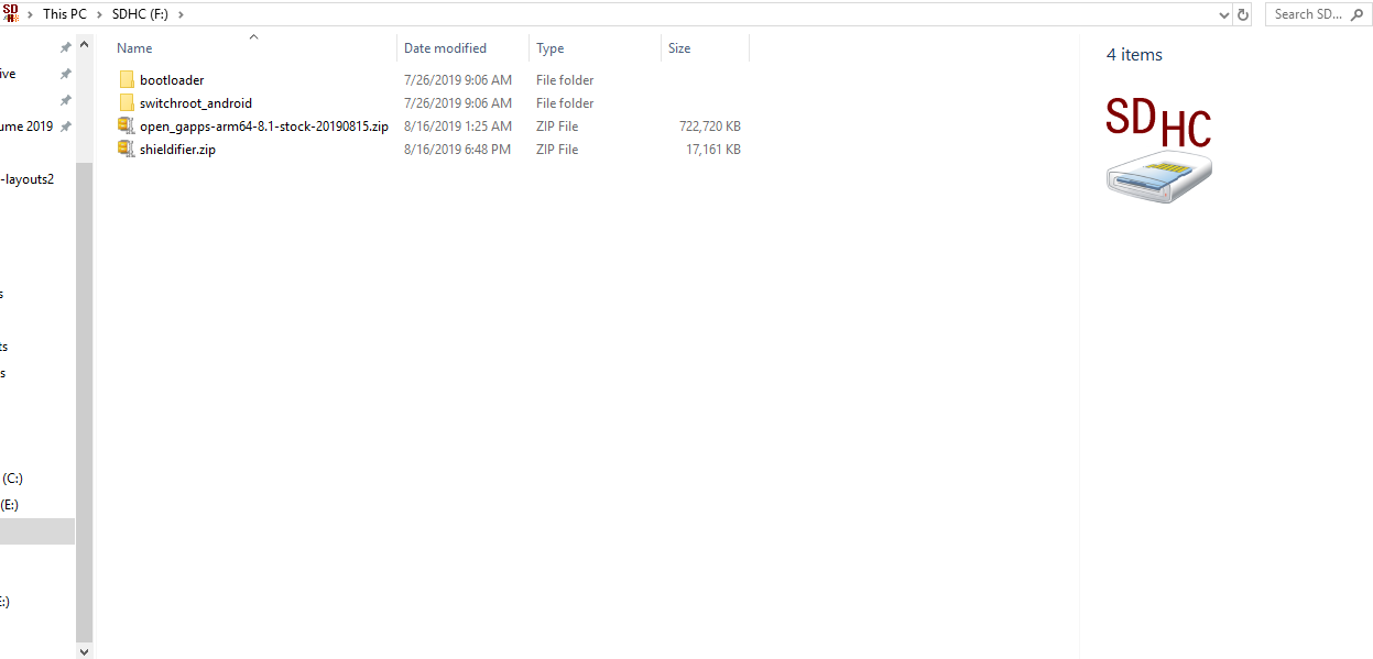

Can anyone fix my issue with Android for Switch?
I can't actually get it to run at all.
So, i've done everything the right way as far as i know..
Flashed the SD with Etcher and the 32GB image it needed..
Placed the Unzipped Shieldifier and open_gapps-arm64-8.1-stock Zips in the 2GB partition
and removed the micro sd card, pushed the payload and pressed on the Android for Switch icon while holding the Vol + button..
and all i get is a black screen.. i tried it multiple different ways aswell.. like before touching the icon, Right after touching the icon etc.. and i either get the "HEKATE" logo or just a black screen.. can anyone help? i even tried different Micro SD cards and they all do the same thing?
I've attached screenshots of how everything looks after Flashing
If etcher didn't throw you an error message, keep the plus button pressed, and wait longer.
I mean - you are copying over an sdcard image. So we are basically cloning the entire installation for every end user. Zero setup. Zero stuff that could go wrong. If you manage to somehow get user error into that - you are talented.
Card defect?
(If you copied over any .zip package to the fat32 partition, doesnt change anything - for the system booting this could as well have been a video file.)
View attachment 176610 View attachment 176611 View attachment 176612
one thing the guides mislead people is when you go to flash things you need to mount all partitions not just the two
you leave the zip files zipped on sd card and hold vol + until you see the recovery screen it could feel like good 10 secs
For TWRP you can start holding vol+ before you press the android icon, and just keep holding it. It can take a while for TWRP to start up. If it doesn't at all tho, after lots of attempts, you probably need a different SD card - the newer and faster the better.

Silly question but when you say that you "removed the micro sd card" do you mean that it isn't in your system when you boot to RCM? The sd card should be in your Switch when you push the payload.
If you are pushing Hekate then after you get to the Hekate menu you'll want to go to the second launch option, "More Configs". There you should see the option for Switchroot.
The issues been fixed now, the problem was that when it asked me to format the SD card I did, turns out you're not supposed to. I was following along with a video tutorial as opposed to reading the gbatemp post.
