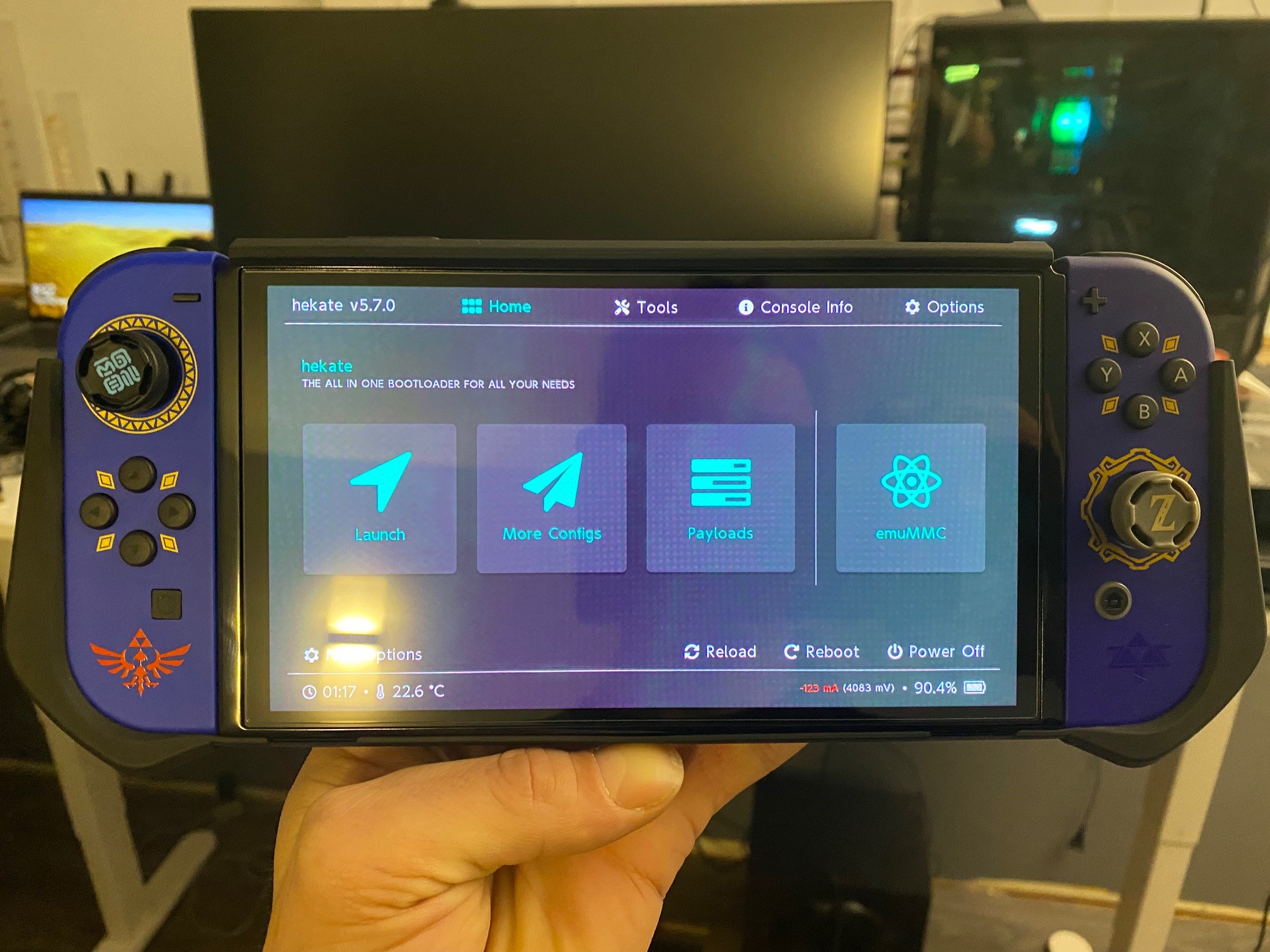

I FIXED IT. YES! Working install finally!!
Needed re-do the CPU cable was all..
You've no idea how pumped I am haha.. :D Thanks a ton to this community and all your help. Time to finish reassembly and play some games. Win!
** Edit: It's never that easy is it.. Got the fan and shield re-installed, tested again with a payload on SD card and, nope, orange blinky errors.. WTF.. Ok don't panic, it did work... Check the connections.. Grounding on CLK, wtf? Ooops, the heatsink screw caught and crushed the wire just ever so slightly. Moved it and stuck it out of the way with hot glue, which also sealed it up nicely. Bingo bango, works again. Thank, effin, god. :rofl:
Also, in case it happens to someone else... Partitioning the SD card in Hekate to setup a trimmed EMUMMC blows away Atmosphere, and everything else. Got the nice old "error while loading fss0" error. Had to copy it all back after. So after multiple scares, yet again.. All good now! :yayswitch:

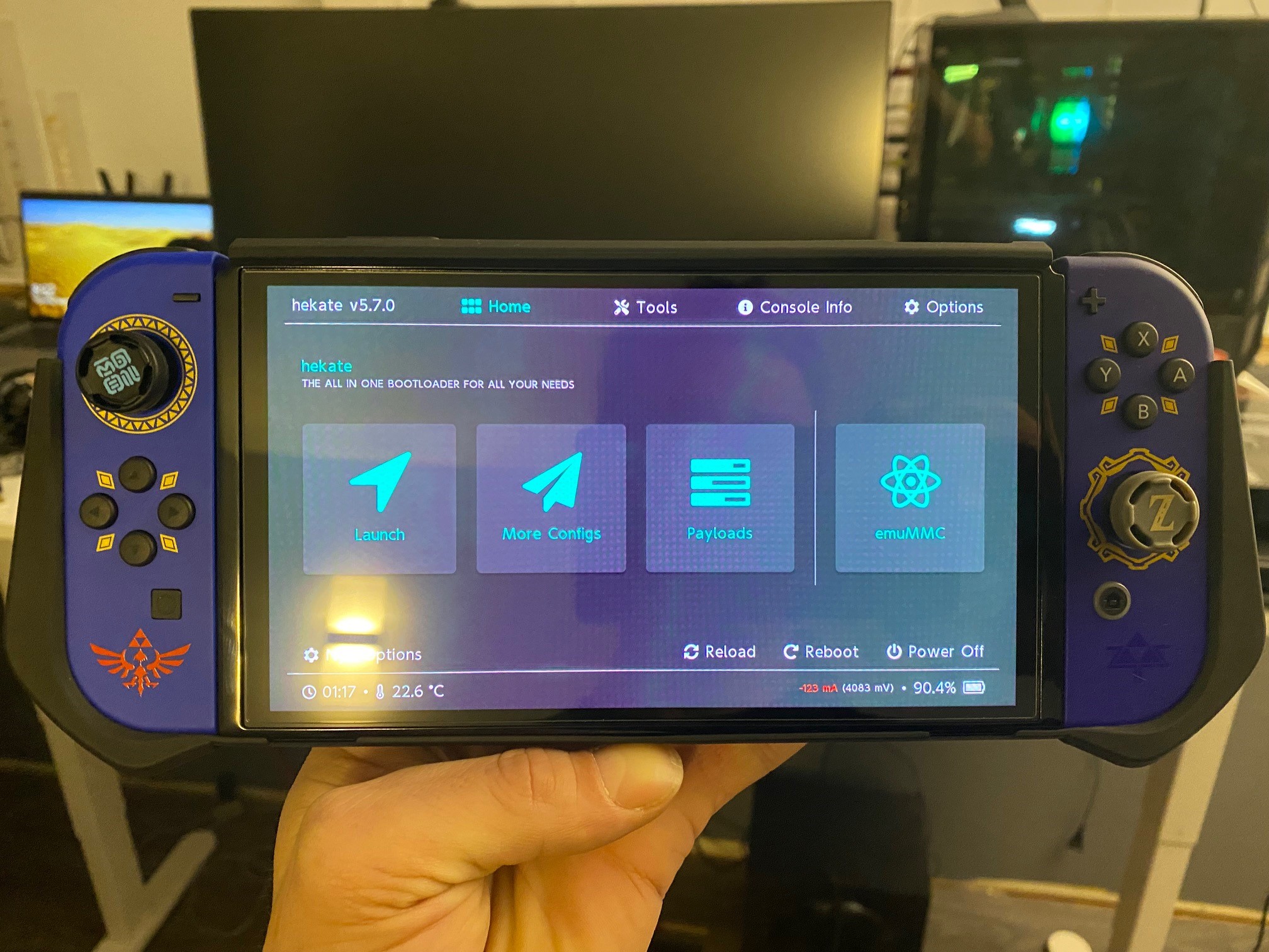

Thanks, should've thought of trying that. That said...
