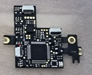

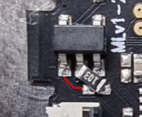

I did notice a difference between two boards I have. The first one has a trace going from the left resistor pad to the bottom-left pin of the ic. On the second HWFLY PCB this trace runs to the bottom-middle pin of the same IC. So it appears the out-of-place looking resistor is a fix for a design error with the board.
That said, I'm unsure which revision either is, but it'd make sense for the second one to be a higher revision where the board issue from the previous revision was fixed. No guarantees though. If anyone has a known-good v3 they could confirm.

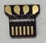

The small cable is for your NAND header on the lite. From left to right via the image of it, the order is DAT0, CMD, CLK, RST

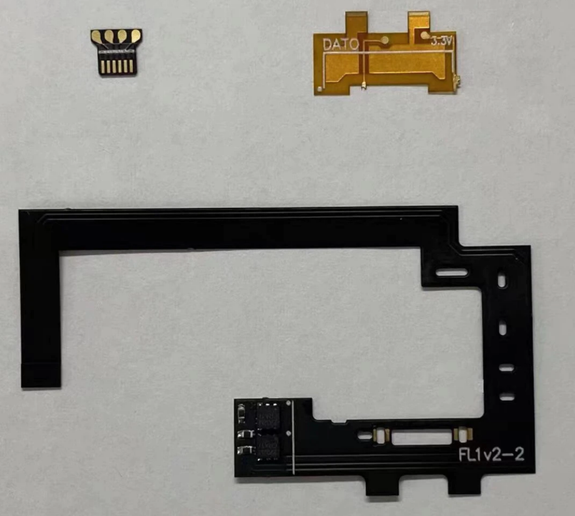

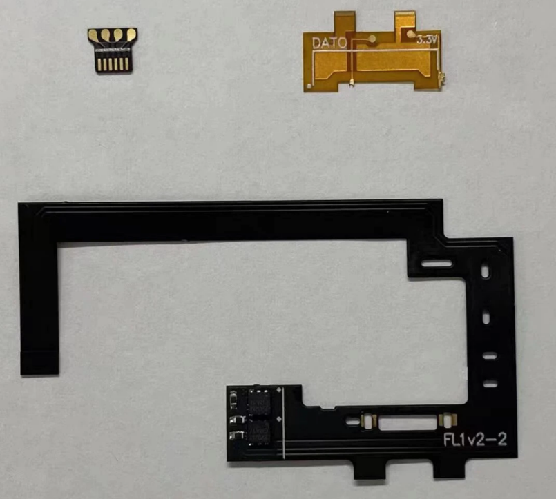

Hey all, been following along here, and after inquiring with a seller on ali about the OLED version they were selling, due to it being cheaper as mentioned, was told new stock was arriving and they sent this picture which I haven't seen elsewhere yet (at least with all 3 in one shot). Just thought I'd share it. It also shows the new smaller DAT0 adapter.
I'll be watching for someone to guinea pig this new OLED version out and let us know how it goes, hopefully with a video. ;) Maybe we can flash these ones? Looking forward to any news on these.
You cannot flash the new ones with default spacecraft. They contain a modified Spacecraft. This is to account for the new FPGA and the pin definitions and such. Flashing it would result in infinite glitching or nothing at all. I wouldn't even try it.
