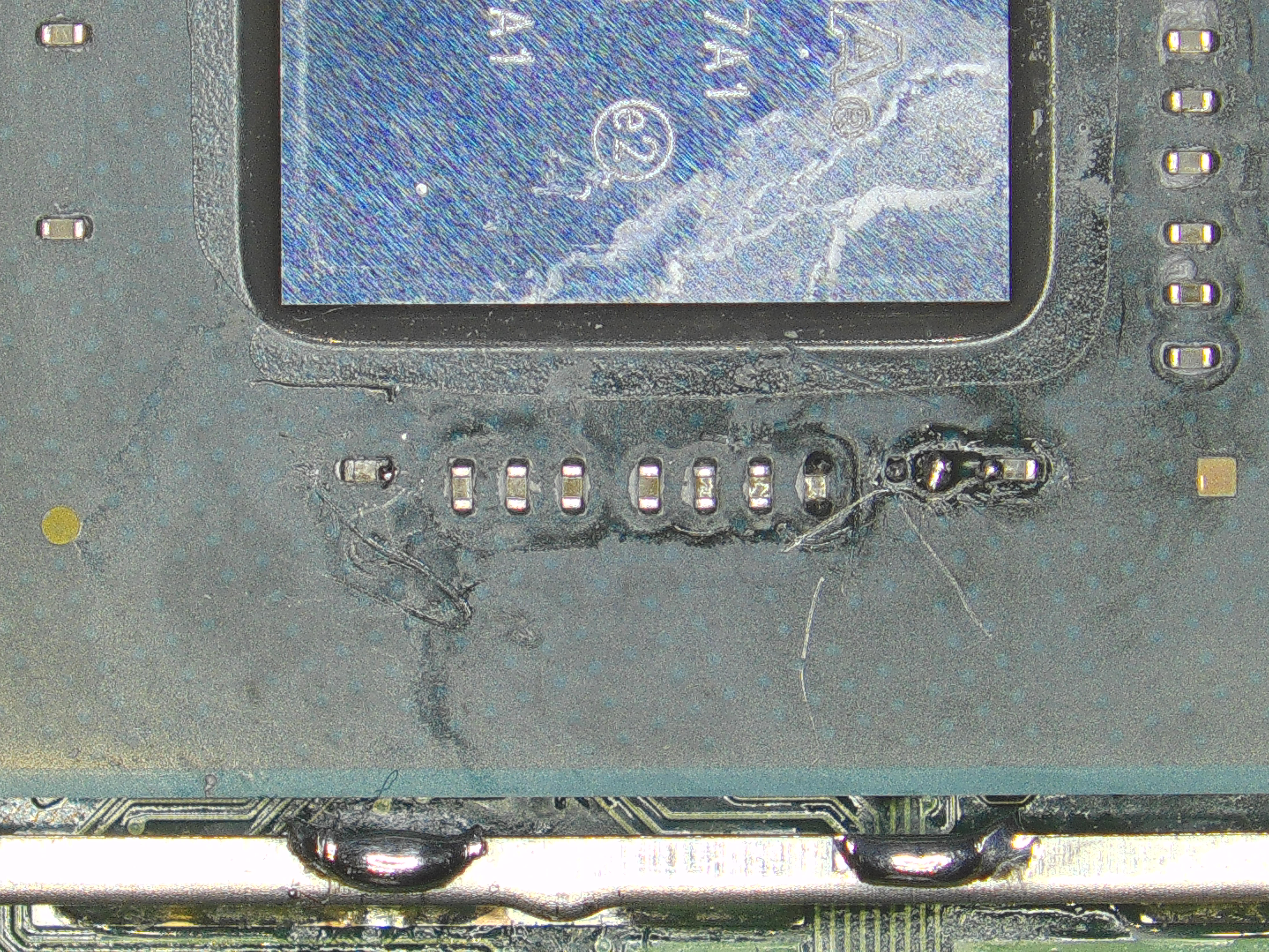

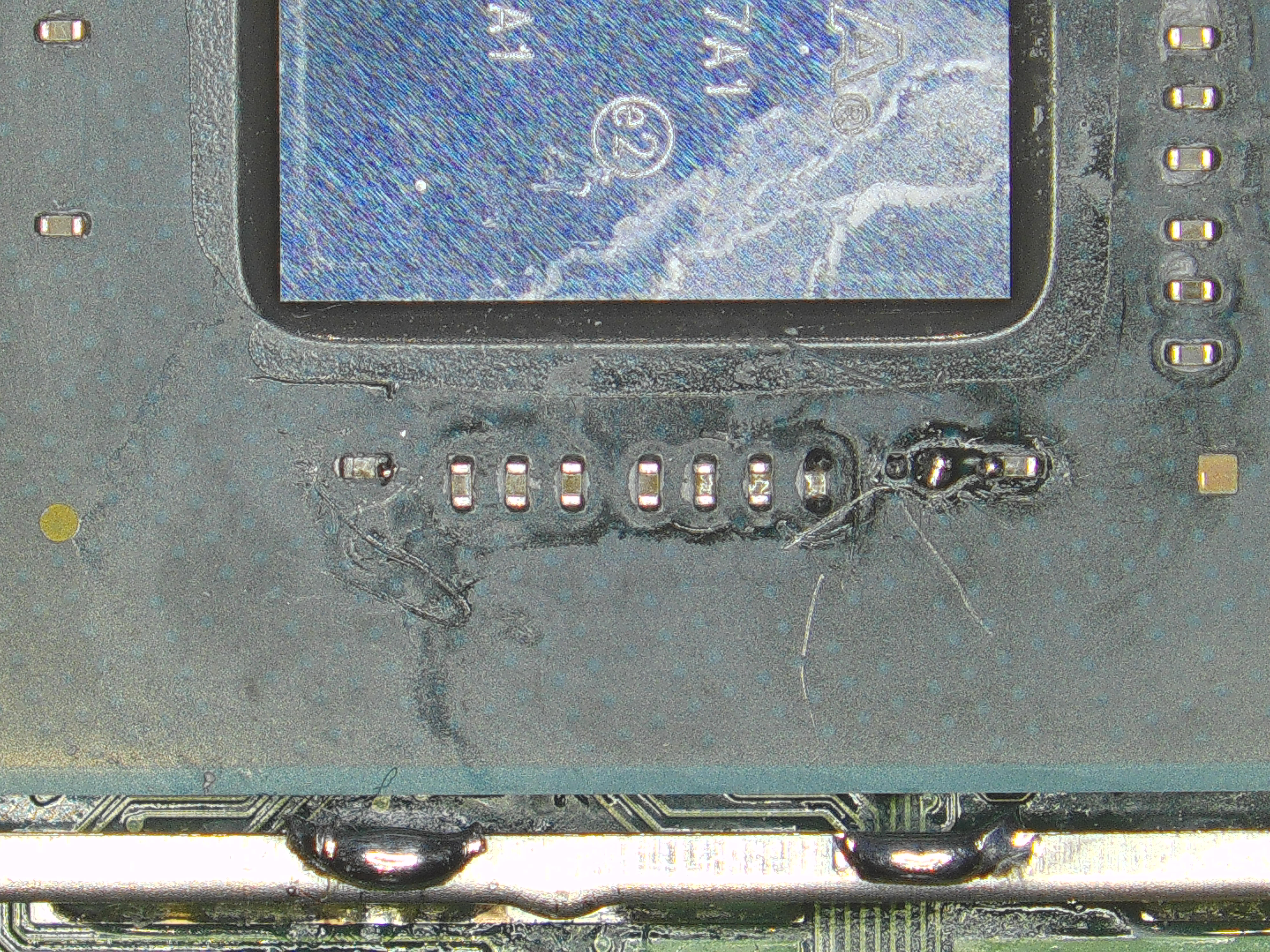

Hi guys, hope you can help or guide me to what could be the problem here. In the past I installed the original SX Cores/Lites on some switches and all was good. Yesterday I attempted my first install on an OLED using the latest HWFLY chips with v3 arched ribbon.
Having completed the install I turned on the switch, yellow light was blinking for good 1 minute or so but the red light next to it was constantly on. It then flashed green and went all off, but could not see anything on the display.I disconnected the battery and reconnected it, this time when I turn it on, cyan or blue light would blink few times while the red light is constantly on, then it goes off and the red light stays on. I disconnected few points so the chip doesn’t come on and removed the ribbon from the chip end, turned on console and its booted as normal.
Next I decided to re-do the SP1 & SP2 points, connected everything back and when I turned on the console now I get a pink screen. I removed everything including the flex cable from SP1 & SP2 points but still pink screen.

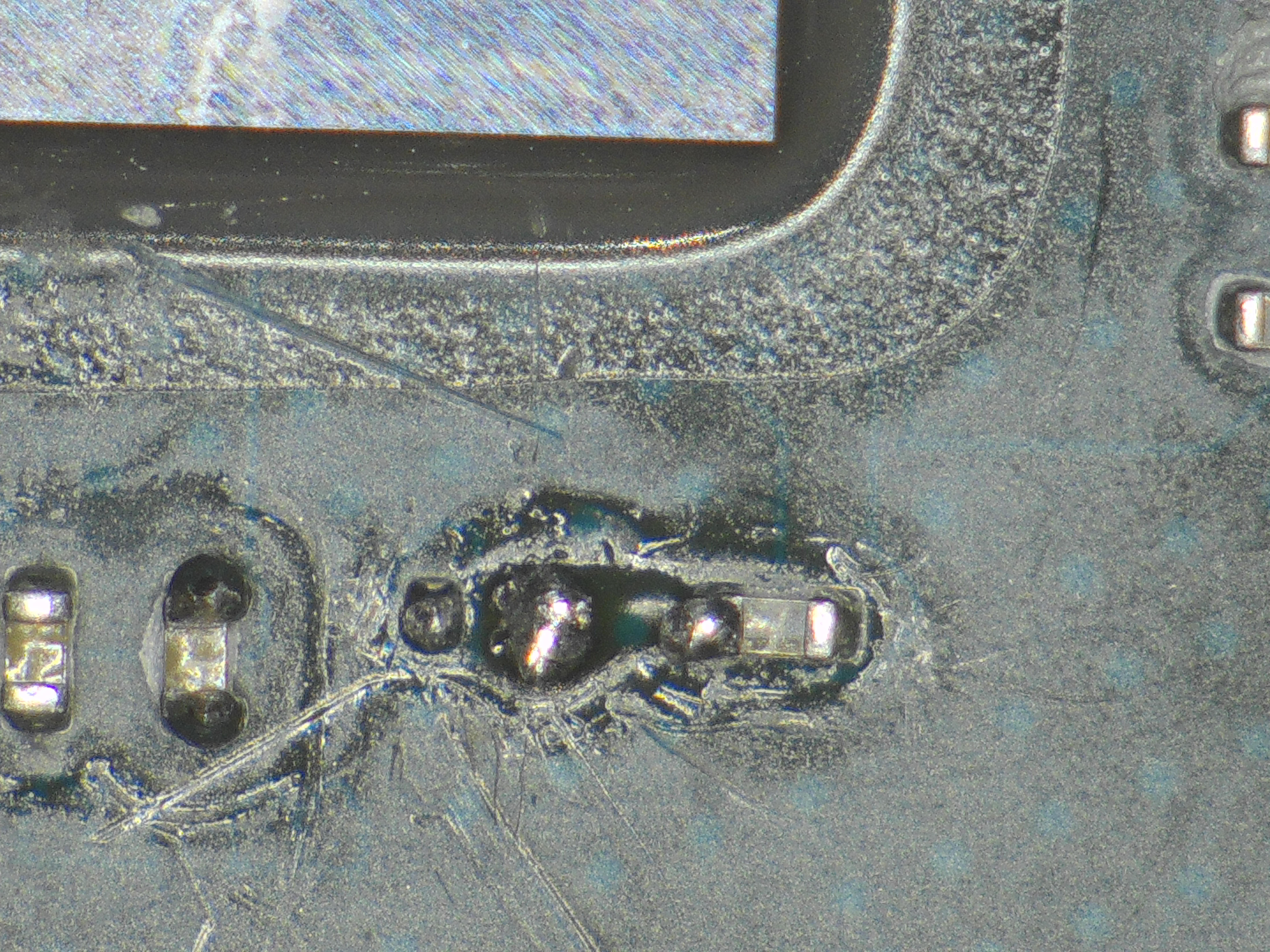

I tested with multimeter, SP1 was giving between 9 and 11ohm, SP2 was dead, however you get continuity at the bottom of SP2 (it is as if the two connectors for the sides of the cap no longer there). I removed SP2 completely and still get pink screen.
I’ve ordered 100pcs 0201 1UF 6.3V X5R 20% Thick Film Chip Multilayer Ceramic Capacitors of Aliexpress now on the hope that replacing SP2 or SP1 too if necessary will get the console going again. Any help or advise on similar issues or tips would be really appricated guys.

Mostly because your boot0 is corrupted.
You have to dump it, and recreate the boot0
EDIT : 25 MARCH 2022
Look at the resistor CMD if the value without anything solder is 4.7 Kohm.
If the resistor is burned, you will have BSOD
this thread is old, probably just needs a good installer. But on a serious note, it is just probably sp1 and sp2 or dat0 connection for red light.
If I read good he have a bsod.
It s because the chip write on the boot0

OLED switch? Did you reflow the dat0 adapter? Does the display connector still look perfect?
