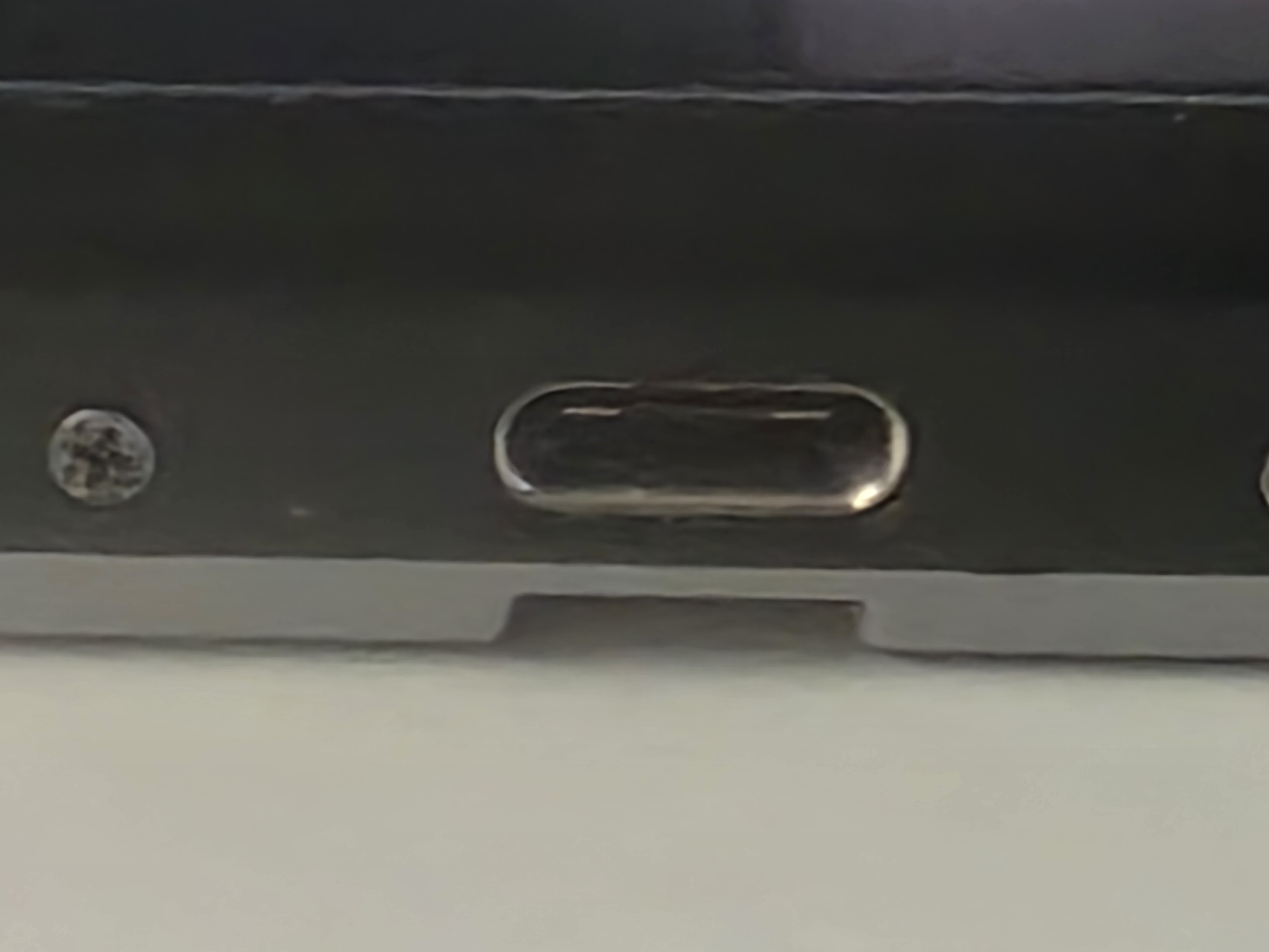

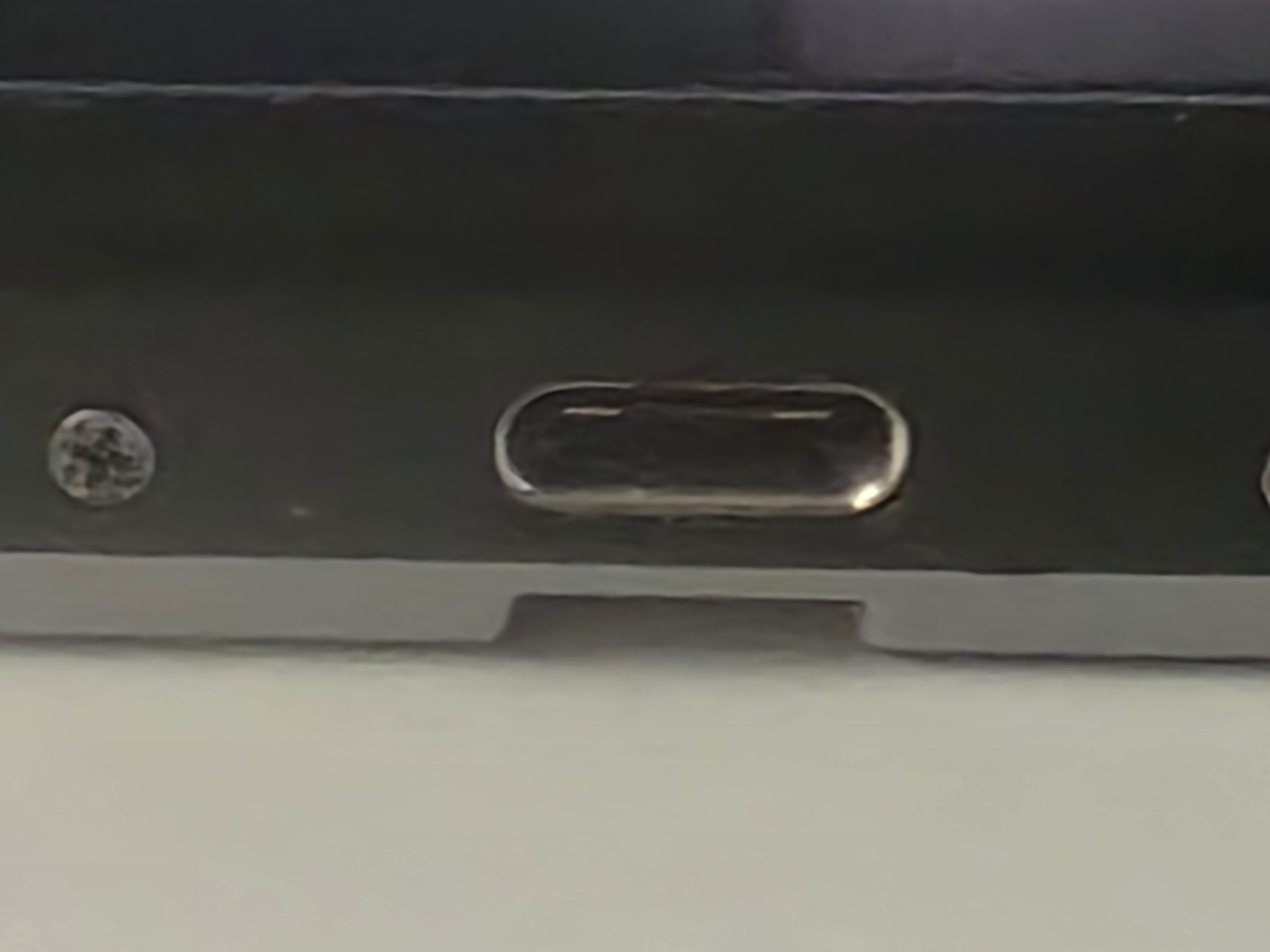

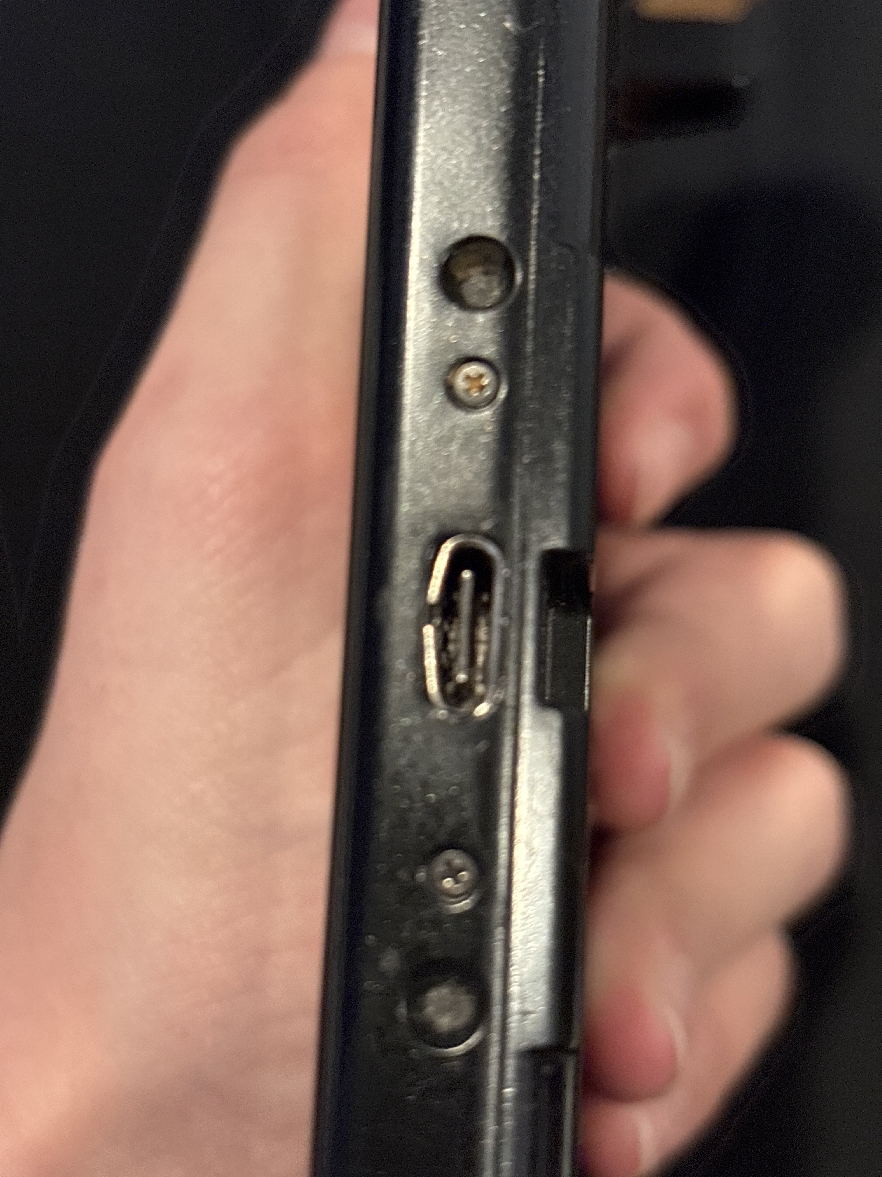

Im pretty sure it’s the charging port. Second opinion?
That's not how it supposed to be normally
I know. I assume this means it’s the charging port at fault for the 2101-0001 error. Do you agree? I just really want to make sure I have the right part before opening the switch up.
The error point at the power management chip, I mean the port probably needs a replacement too, unless you can get it back to how it supposed to be. It depends on if any of the part of charging port are damaged or not.
