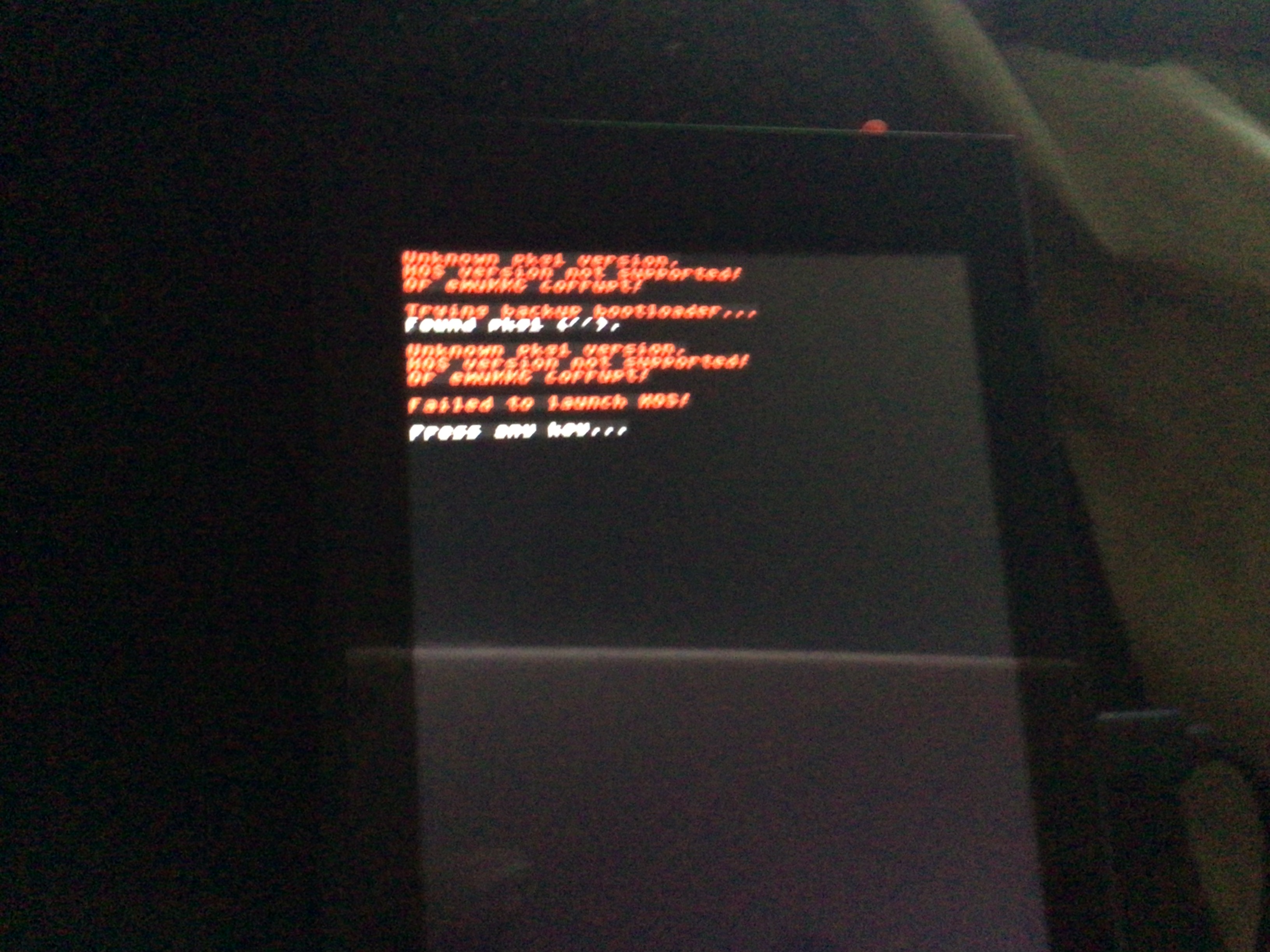

Can somebody help me I recently bought a unpatched switch and I modded step by step I had the latest atmosphere And hekate I partitioned my sd card and created the emunand but when I try launching it it says
unkown pkg1 version
HOS version not supported!
or emuMMC corrupt!
trying backup bootloader…
found pkg1
unkown pkg1 version
or emuMMC corrupt!
failed to launch HOS!
press any key
the seller didnt mention about him modding it so I don’t now if it’s because I have 19.0.1 please help me I have been trying this for so long

downgrade to 18.1, newest fw not playing good...
