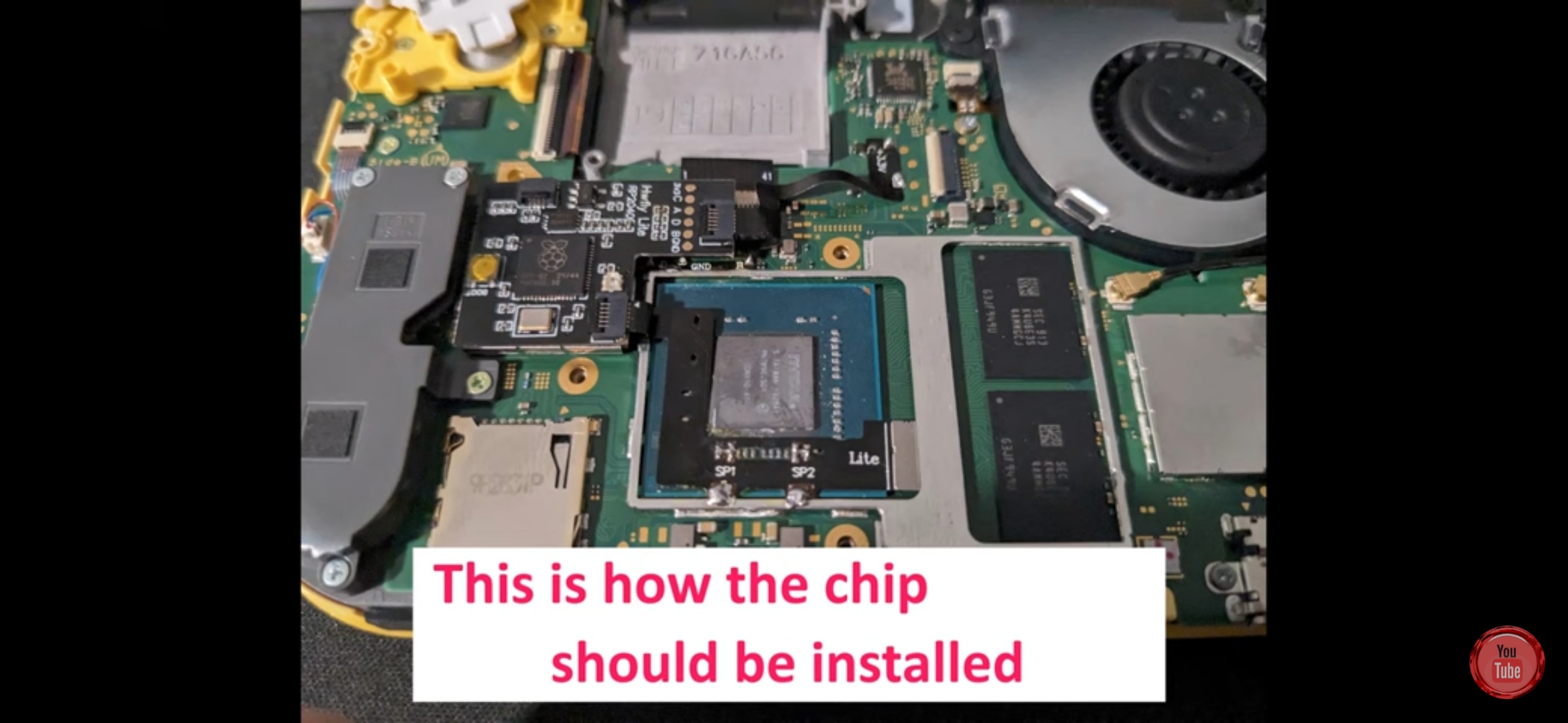

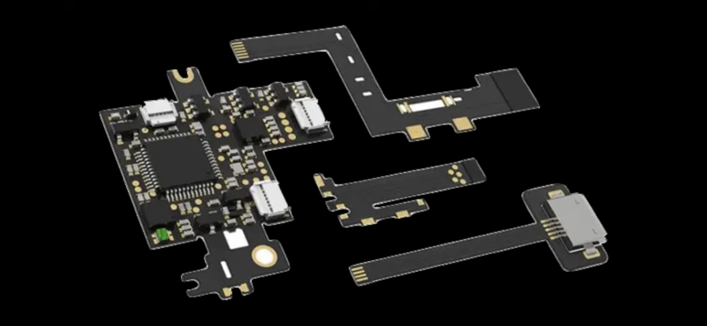

Sorry to pose such a simple question when it's a matter of lurking moar, but I recently found my way back into console modding and figured I'd get a switch since that's the hot new thing.
I've done some slight research and through various reddit posts arrived at the conclusion that there are two revisions I need to be aware of, V1 Erista the original softmod-able one, and then V2 Mariko which patched the vulnerability and requires a modchip (Hwfly Picofly) to run CFW.
So my question follows, is there any difference between OLED models or can I just walk into any store and purchase a Switch OLED then install a modship and go? Is there anything else I need to be thoughtful of when purchasing the modchip to go with V2?
As far as I know, there is only one type of OLED Switch model. As for the type of modchip, I'm afraid I'm not too knowledgeable on this subject. In case nobody else chimes in on the subject, you can try making a thread and asking the genera forum for their opinion.
