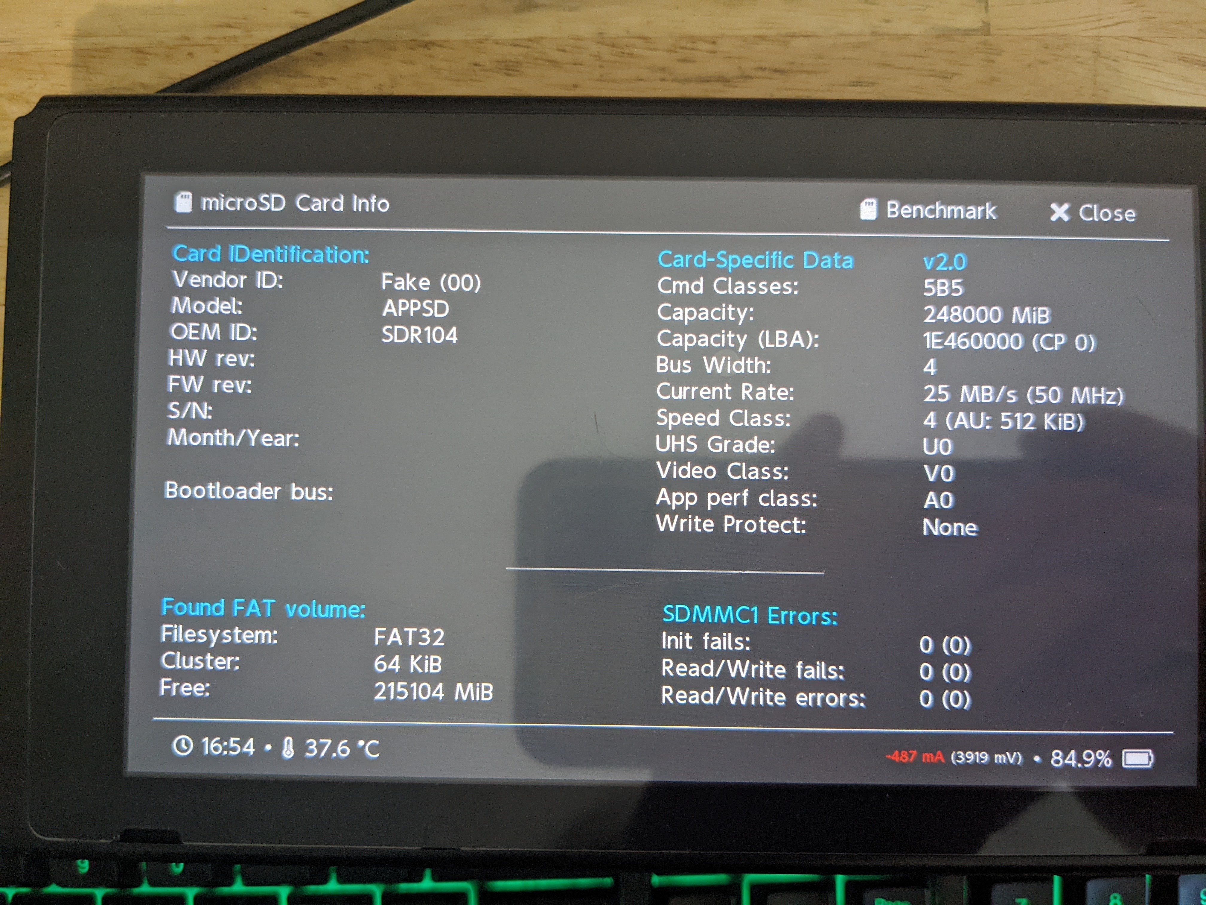

last thing to check…let’s check your SDCard info in Hekate:
please post a screenshot herel should looks something like this:
Then run the following on your PC against you new SDCard plugged into your PC
https://3ds.hacks.guide/h2testw-(windows).html
more details on what we’re doing here: https://rentry.org/SwitchSDInfo
rcm, no modchip
what do you mean by that? what do i have to do?
The problem Is that It says "acquiring fat volume info" and it's freezed on that, but i think this screenshot Is enough.
I am doing the test with H2testw, but that seems pretty long... 1 hour and 30 minutes.
Reactions: binkinator
