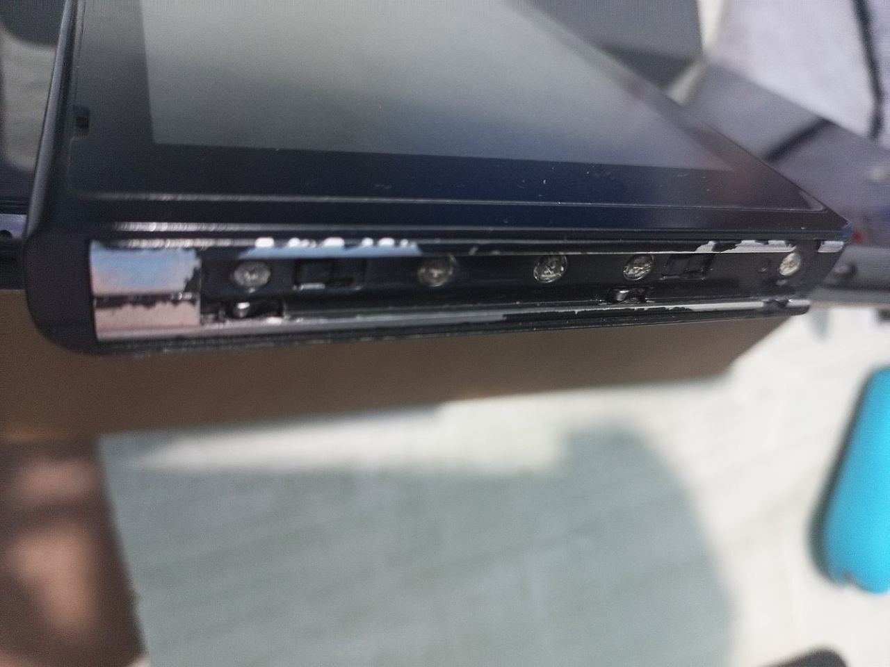

Hi friends! My switch shuts down after low power notif, when I attach my hori split pad pro to it, even though the switch is fully charged. What should I do?
First of all, I'd stop attaching your Hori split pad pro to it, at least until the problem is identified.
Now, this seems to me like an electrical problem with the contacts at the bottom of your Switch's JoyCon rails - the ones we need to short to boot the Switch into RCM mode and their neighbors. It might just be an easy to fix short that the Switch shuts down from to protect the battery or something along those lines.However, I am not very knowledgeable in this area, so let's go through the safe basics until someone shows up who can help you better than I can.
The first thing: does anything power-related happen when you attach regular joycons or any other third-party joycons you might have?
The second thing: It's kind of uncomfortable to do, but you can take photos of these contacts on the Switch by pointing your camera along the rail, top to bottom, and bottom to top on the JoyCon. Could you photograph the Switch's contacts and the ones on the Hori split pad (both sides in both cases) so we can at least see if there's any sort of visible bending or damage? Use flash, or even better, have a lantern pointed at the devices so that your camera can autofocus better.

Thank you for replying! ^_^
1. Good thing, nothing bad happens when I user my regular joy cons. I can still play the switch when using it. Sadly I don't have any other third party controller, besides my hori split pad pro.
2. I had my suspicions that the fuse we short to go to RCM Mode, is the culprit. I tested it by attaching the left hori split pad pro and regular joy cons on the right, and it worked normally. But as soon as I attach the Right Hori Split Pad pro, it prompts low battery and shuts down, within a few seconds.
3. As per your request, I took photos of both the railings and hori split pad pro.
Excellent, this narrows down the problem. Your right Hori split pad pro is doing something that it shouldn't, everything else is probably fine.
Thanks, but I may have been less clear than I should have. We need to see the contacts in the end of the railing, not the railing itself. We've already determined that the right Hori Pad Pro is the problem, so I only need a picture of the contacts on that one. Like so:
Approach from this angle, the bottom of the controller. See how there's a sort of overhang on the railing? The contacts are under there.
This is what I want to see. Notice all these little lined-up dots? These are the contacts. Normally they should line up perfectly with the ones on the Switch. But if I'm right, at least one of them will be bent somehow. Fixing that won't be especially easy because of their size and the poor access, but it should be just a matter of bending it back into position, so not especially hard either.
A closer shot.
