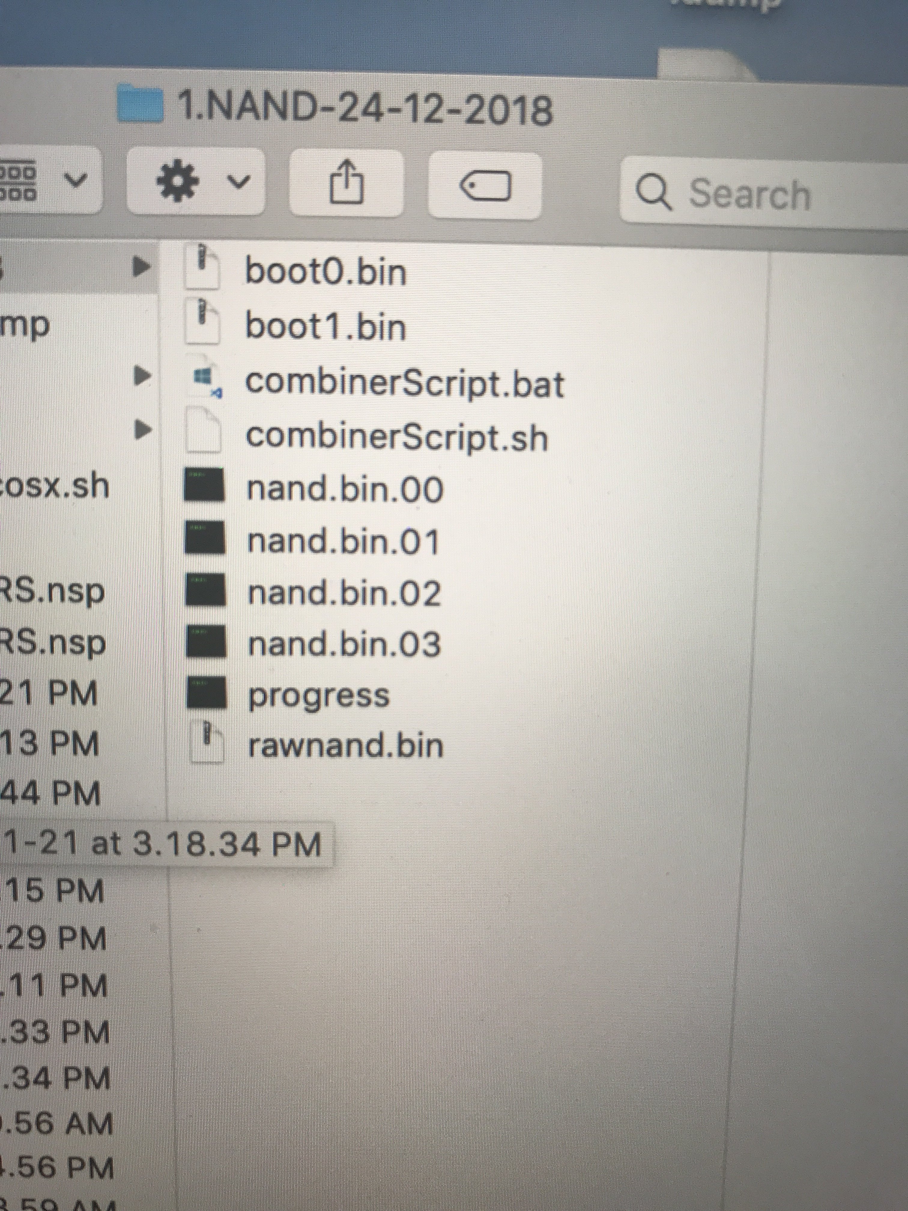

Hi all! I did a wrong thing. I made a backup nand. But my nand files isn’t enough 15 files. It’s means i have had a “boot 0/1” and “useless nand”. I ran restore boot 0/1. I couldnt run nand restore. It make my NS is bricked. Have any solution for my case?
What files do you have? if you have rawnand.bin.00 .bin.01 etc you need to join them
It depends on how confident you are and if you read and follow the instructions properly, if you don't think you can then don't do it cause it can brick properly
I joined the nand files by combinerScript.sh. I will send you director structrure I had.
yeah that doesn't look right... you should have atleast 15 of the files for a size of 29gb..
So. Is my NS is bricked, right? Could you give me some solution for my case? I ran Boot 0/1. and Couldn't restore nand file for my NS.
