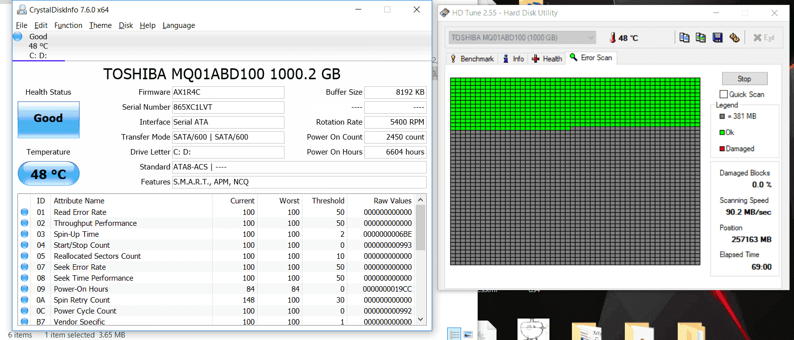

cystal disk info is showing all blue, and hd tuner is (so far) not finding any bad blocks

ok, so after a few dozen more tests, chkdsk is coming back clean, hard drive blocks are all good according to hd tuner, registry files are good, drivers are good too, and crystal disk is reporting good hard drive health. I still don't get it. Everything points to there being no problems.
