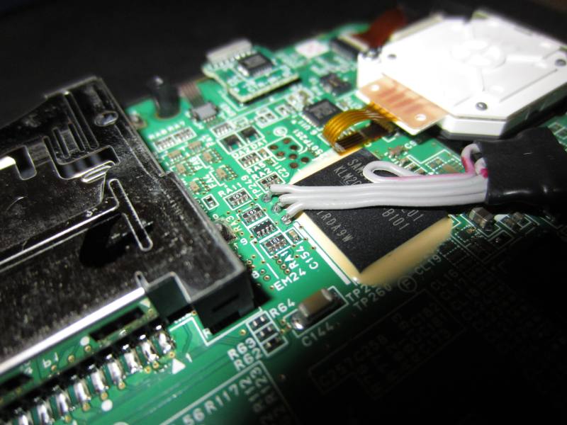

I've worked out now well with your past help as well how the ohm crap works. One of the connections came off last night as it sucked. The two that are on there solidly. Im getting an ohm reading of 9.20 on one and 8.80 on the other. Also getting a ohm reading on pads that have nothing on them around 9.20. I imagine if you have a bridged connection of some some sort you wont get a reading?
To test the pad i grounded the positive and then just put the neg on a pad that had nothing on it, i think thats right. So it would seem the pads are good.
The 30 awg cable looks really bloody tine single strand can barely see it not looking forward to it at all.

Yeah that video is crappy, i saw that forever ago... I really recommend some 40 wire IDE cable for this mod honestly...
As you can see it's good sized but not too big and makes a nice solid connection without much risk of too much leverage from flex

out of interest what ohm reading do you get on any of your points?

Well you aren't exactly doing it right... Basically you want from the pad to the end of the wire which will tell you if it's connected properly or not
Thats what i have been doing i mean for testing a pad without anything connected to it. Cant get a stable reading at the end of the wire jumps about to much.

on one of my pads im getting 01.5-01.7 dunno if thats any good. Done a continuity test there are no bridges.
Sounds pretty good

however to get that reading you have keep the needles completely still or it jumps around. How much solder do you apply to your iron before hand? I was worried about putting to much on and making a mess and thats why i went in with a brushed iron beforehand.

I just take that thin solder I use and just feed a small amount in

I could use two strands of my 80 cable for now for the last one.
Could i shove this in to the sd reader as is without casing it back up?
You probably could but I wouldn't as the wires are likely to break off

Sorry to the SD card one... You can just use one strand of 80 wire on it just fine, but 2 might help with data transfer rate
