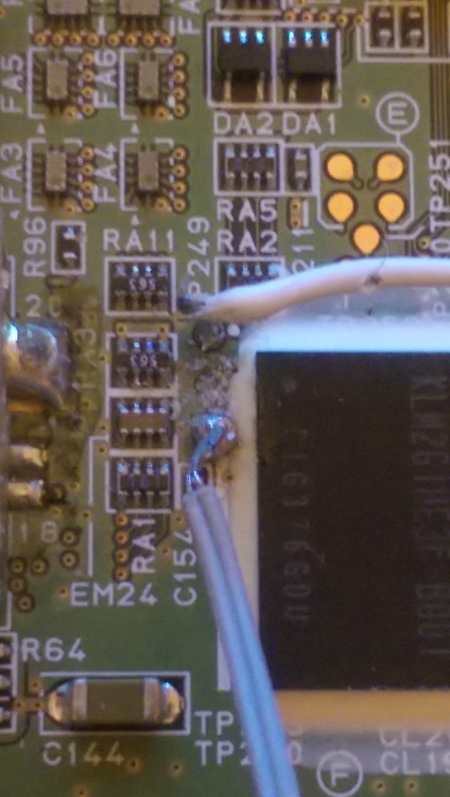

Think ive fucked it, i was messing about with the other end of one of the bigger cables and accidentally pulled it out off the soldered connection. i think ive bugered it. shit.
help or am i screwed? i can see the gold thing on the end of the wire cmd any alternatives?
cmd point it is
Well your only alternative is to scrape some of the green stuff down to the bare copper and use some really small wire on it (the 80 wire stuff is small enough)
So i scrape the green chip it self? or that white gunk stuff around the nand chip
It's the green stuff underneath the white gunk, you'll see it as a little line that goes from where the pad was to under the chip... And replace those other wires with the thinner wires too

is
is it possible that lifting the pad has stripped the trace copper as well or is that unlikely. Dont think im going to be able to fix this really.

it probably didn't... If I were you I'd find someone who is more skilled than you to scratch it and repair it

Yea that repair is defo beyond my skill for sure.

better pic not that its of much use.
