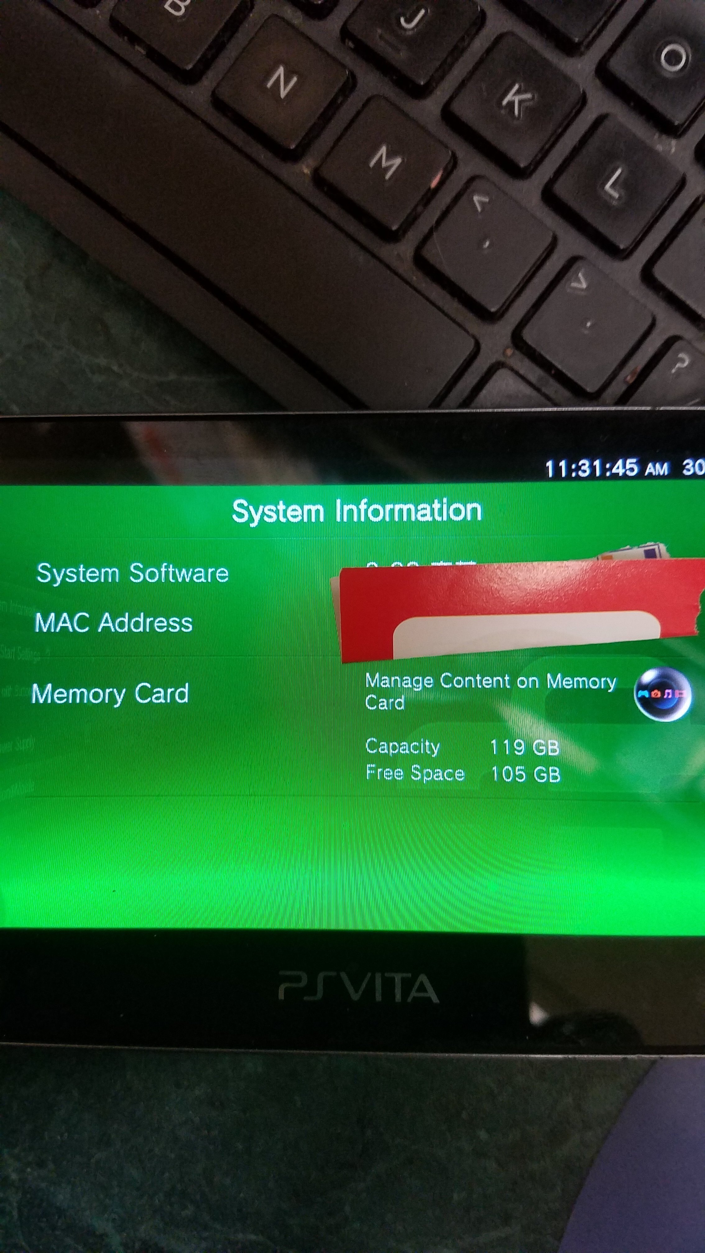

Well I'm trying to get my son's Sd2vita card working.. I followed a video to the T & my vita see's the SD card! But Vita shell won't work says " corrupt data" I re built the data base... But still no luck... If anyone could help me out? i watched this Video
EDIT: got it working

So, from what I can gather, you sucessfully migrated to SD2Vita as your primary storage (ux0). I think you maybe forgot to copy the data from your original storage to the sd2vita.
So either install Vitashell again or copy all content from your old memory card (or internal memory, whichever you installed vitashell to) to the sd2vita first.
Since you're using either Storage-mgr or another plugin to mount your sd2vita as ux0, you'll need to disable this first. Without access to vitashell you'll need to hold the L Button on boot or when loading h-encore (chose whchever method you hacked your Vita with) to launch without loading your henkaku config. Enter Vitashell and copy everything from ux0 (which is now again your old storage) to your PC via FTP or USB and copy it onto the SD of your SD2Vita.

hey thanks for the reply after struggling a bit i did get it working .. all is great atm ..i formatted my sd to 64klb because a guy on Reddit said otherwise ou cant save properly ... anyways its working great ..i was just curious if i can just use the sd and sell my 16 original mem card ... im not that bothered as you know i woulldnt get much for it at gamestop .. the cheating bastards lol
If you are on firmware 3.60 or 3.65 with enso then you do not need the official memory card.
If you're above 3.65 and have a vita 1000 then you will need an official vita mem card to allow you to launch h-encore. If you have a vita 2000 or pstv above 3.65 you can use the internal 1GB 'memory card' as the location to install h-encore, so you wont need an actual vita mem card.
With enso the exploit is loaded at boot so you're fine. Without enso you need h-encore installed on official storage that is available prior to you activating the exploit each boot.
The 64K clusters formatting prevents the vita from incorrectly reporting the amount of free space for those who run a 200GB microsD or larger.
