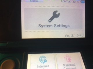

downgraded to 2.1.0 from 11.2 on o3ds, using soundhax :-)
