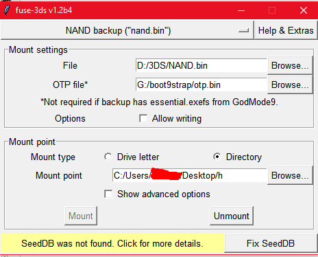

-on PC, use fuse3DS (download if you don't have it) to mount the stolen 3DS NAND image to a folder, you need the nand.bin and otp.bin for it to work

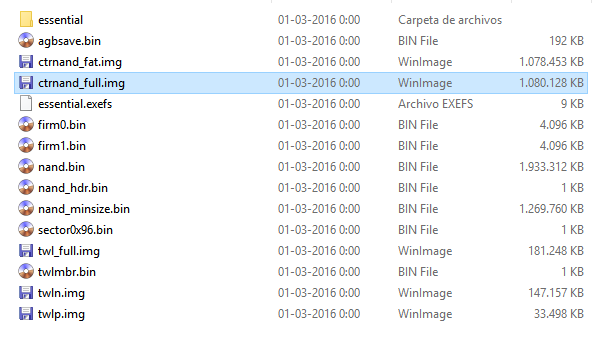

-open the ctrnand_full.img file using WinImage
-open private folder
copy movable.sed to the new 3DS SD card
