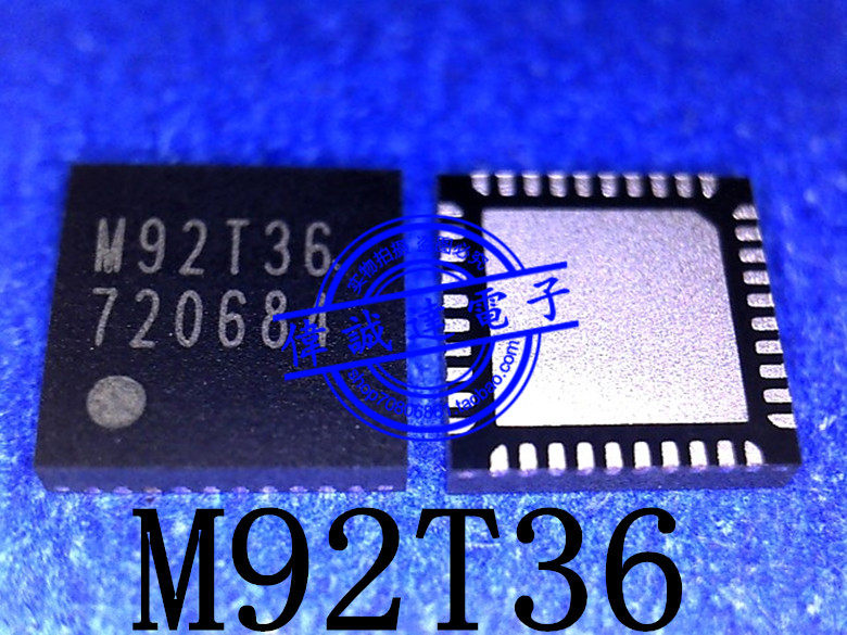

After long hours of research, I'm pretty sure the M92T36 chip is responsible for both charging and HDMI is the fault here. It can't be the port as no physical damage was done to it.
How difficult is it to replace this chip? Apparently you need a reflow oven or hotair rework station for this as it's an SMD component, so would mobile phone repair shops be able to do this?
This chip seems to be way easier to replace than the USB port though, this one has flat pins, the port has two sets of pins, one going into the PCB itself so a proper rework station is mandatory.
This fix also apparently helps with third party dock bricking, I'm tempted to get this tried out. I just wonder if mobile repair shops can do this without messing up. I'm in China currently, so is the teardown self-explanatory? I have no idea where to begin with explaining how to tear apart the system to the people there as I'm not fluent in Chinese.

For that chip I would say a hot air station is necessary, and anybody that could do it with a regular iron would not do it in their day to day repairs.

I already found one neat mobile repair shop with a ton of soldering equipment, they should be having a hot air rework station.
I'm scared the hot air might melt other components on the PCB, and even melt the new part I am going to replace it with. What temperature of the hot air station to be set do you recommend?

As for the heat gun I agree in a part like that you would go that route. You basically use tape and foil to isolate the area you want heat and protect the other components then ramp up the heat slpwly until the part comes loose the actual temp can vary on the type of solder used.

I do hope this chip is indeed the issue, I have a replacement chip sitting on my table waiting to get installed. It heated up, but that could probably be normal as it is responsible for charging, or so I think it's normal. Be back in a few hours to get the soldering done by a mobile repair shop, fingers crossed.
Edit: Make that a day lol. Paid $12 for the solder job, guess those guys don't want me around when they do it, or the price would seem too expensive. xD

Nope, no change, same issue. Welp, at a loss here. No idea what the issue could be, guess I'll just maybe wait and see if any other person goes through this issue and provudes a solution. Thanks guys! :)
Personally, I'd swap the USB-C port. Assuming it don't charge? Next I'd follow the USB-C traces and see if they lead to another "CHIP" and swap that out. I've never seen the inside of a switch so I have no idea.

Alright yeah, sounds like a great idea. I've seen other fixes of the not charging problem and they do involve replacing the C port, but that's when it was physically damaged. Mine isn't, or so I'm almost certain, it looks fine to me.
