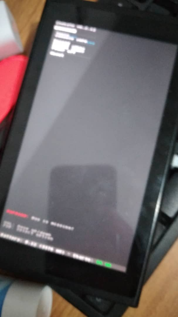

A few months ago, I went to grab my Switch, it had no battery, not a single charge, I turned it on by connecting a USB cable to my computer and injecting hekate, then I plugged it into a wall, but after reaching 3% the console shut off and never turned back on, I bought a pair of screwdrivers, I was able to disassemble my console, I checked the console there was liquid? Although the liquid damage stickers were fine? I cleaned it up and the console still did not turn on.
A few days ago, I plugged in the Nintendo Switch for curiosity, injected hekate, and by miracle I got this.

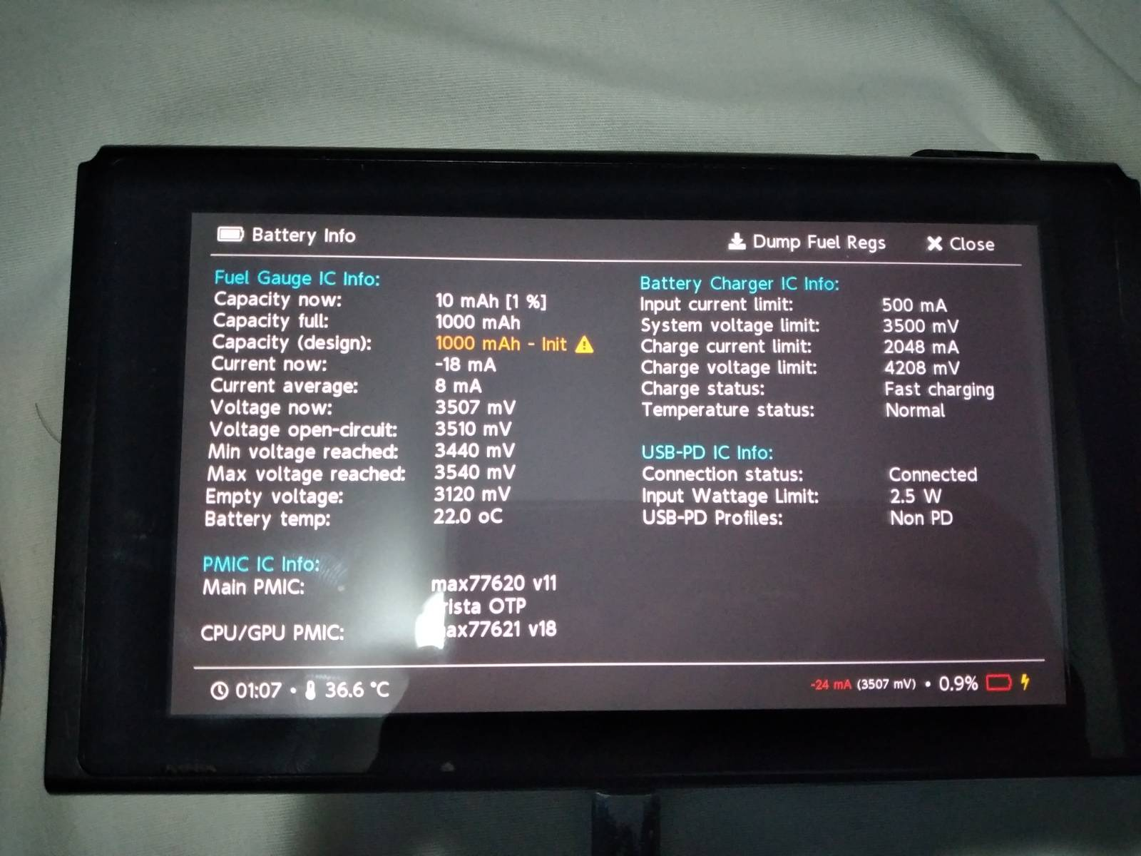

When charging to 3% on hekate, the console shut off and once again did not turn on again. Before that I checked the battery status on hekate and it had a warning sign on capacity? Like, the capacity was the same put then there was "Init?" warning sign. Sadly I took no photo.

A hekate battery report help
