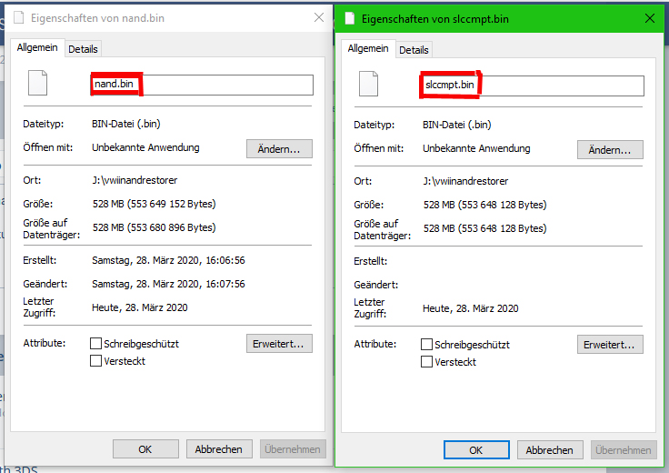

Hello.:)
There is another Thing that makes me a little "confused".:unsure:
The NAND Backupsizes are different:
I used that from the Wii U Dumper.Actual I have no Signs of "Issues".
Thank you.:)
Reactions: GaryOderNichts
Hello.:)
Thank you.:)
So both dumps are extracting fine? Thats weird Dump Mii Nand always gave me a file that could not be extracted.
Edit: Oh I think I missread that You used the one from Wii U Nand Dumper
