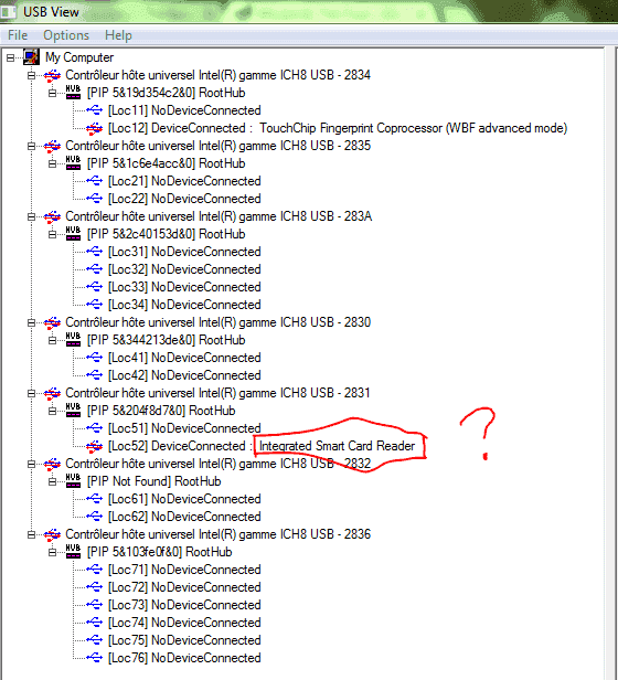

Try running usbview and seeing if your device is on the list somewhere.
I don't know if this is it, Unpluging and repluging the card in the reader changes nothing in this screen:

I don't have such things on my laptop. It's a lenovo thinkpad t61
So, I can't tell if the built-in card reader is on the list.
In case this hasn't been solved yet, your T61 might have a Lenovo smartcard reader. That communicates through USB.
The card reader seems to be either Ricoh R5C843 or Ricoh R5C847, both communicates through PCI.
EDIT: Datasheet: http://www.e-devices.ricoh.co.jp/en/products/product_pcif/pcc/5c843/index.html
http://www.e-devices.ricoh.co.jp/en/products/product_pcif/pcc/5c847/index.html
It's likely that this device doesn't abstract memory card communications, since the OS needs specific drivers for it.
