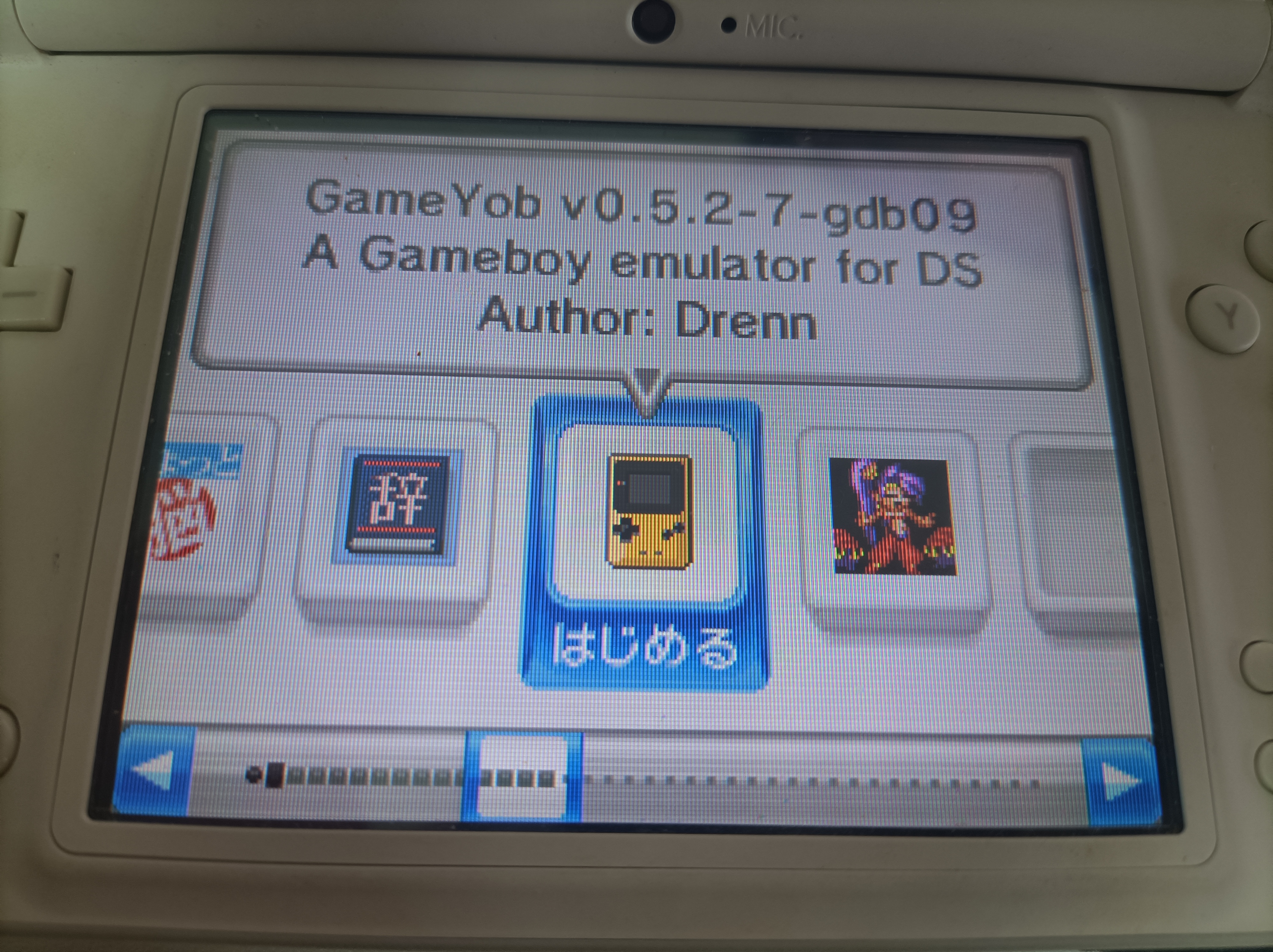

It's very cool. Can I use it install GBARunner2, GameYob to SysNAND ?
I don't think GBARunner2 will work directly (though it should work to use a forwarder to GBARunner2 on the SD card) since it requires nds-bootstrap to run on DSi, I think GameYob should work though.
Edit: I tested in no$gba and gameyob_dsi.nds works, however the banner is blank. I complied the latest commit of the v0.5-hotfix brach with the latest devkitARM/libnds and it seems to work so I've attached that here.

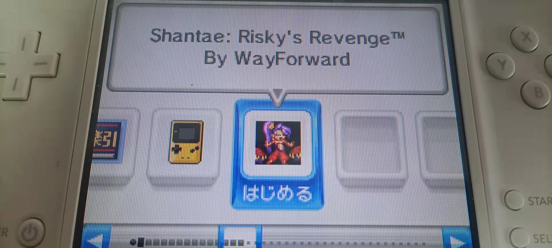

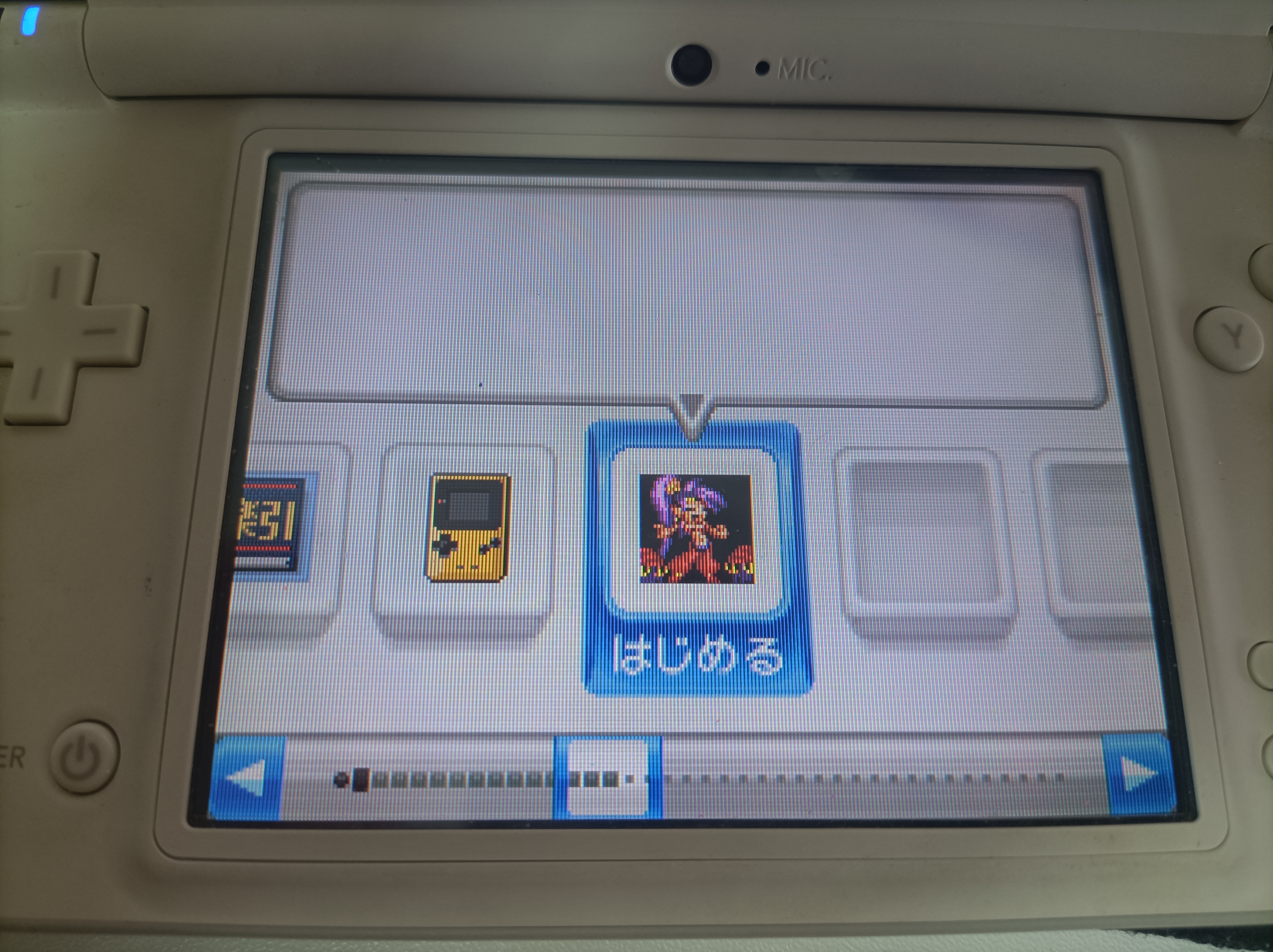

I installed your gameyob_dsi.nds on my NDSiLL sysNAND, it works very well. And I install Shantae Risky's Revenge (EU) , it also works, but the banner is blank. My NDSiLL is a Japanese version.

I used the fixed build NTM to install Shantae Risky's Revenge (EU), the title banner is also blank, but the game can run very well.
Huh, it seems that the developers just left all the non-European titles blank on that game. If you just copy the English title to the Japanese title that should fix it. I think MessAnimDSIco should work correctly or (since I can never get that to work) I just made a little Python script that will copy a language into any blank ones.
I've also attached an IPS patch for the European Shantae that copies the English title into Japanese, Chinese, and Korean.

I patched the dsi rom with shantae-title-fix.ips, the title can be displayed now, but the game can't run now.
Oh huh, that's really weird... Sorry I didn't test better, I figured it'd work since I made sure all the checksums were correct and I only touched the banner.
It seems like there's actually something in the game that checks if the banner's been tampered with and refuses to load, editing the banner of another DSiWare (Bloons TD 4) works just fine...
I'm not sure there's an easy fix for it unfortunately, did a bit of testing and it always seems to get stuck if you touch anything in the banner... I guess just reinstall the unpatched version for now at least, I'll be sure to post about it if I figure out why
Edit: I did some further testing and it appears that the game won't boot if any of the banner checksums have been edited, it doesn't care about the actual banner data... however the launcher does care about those checksums and refuses to display a banner (blank white box) if they're wrong... So probably need to patch the game wherever it checks that I guess, which is beyond what I know how to do.

This game is very special, the USA version also can't run on my Japanese NDSi/NDSiLL, but the Europe version can run very well.

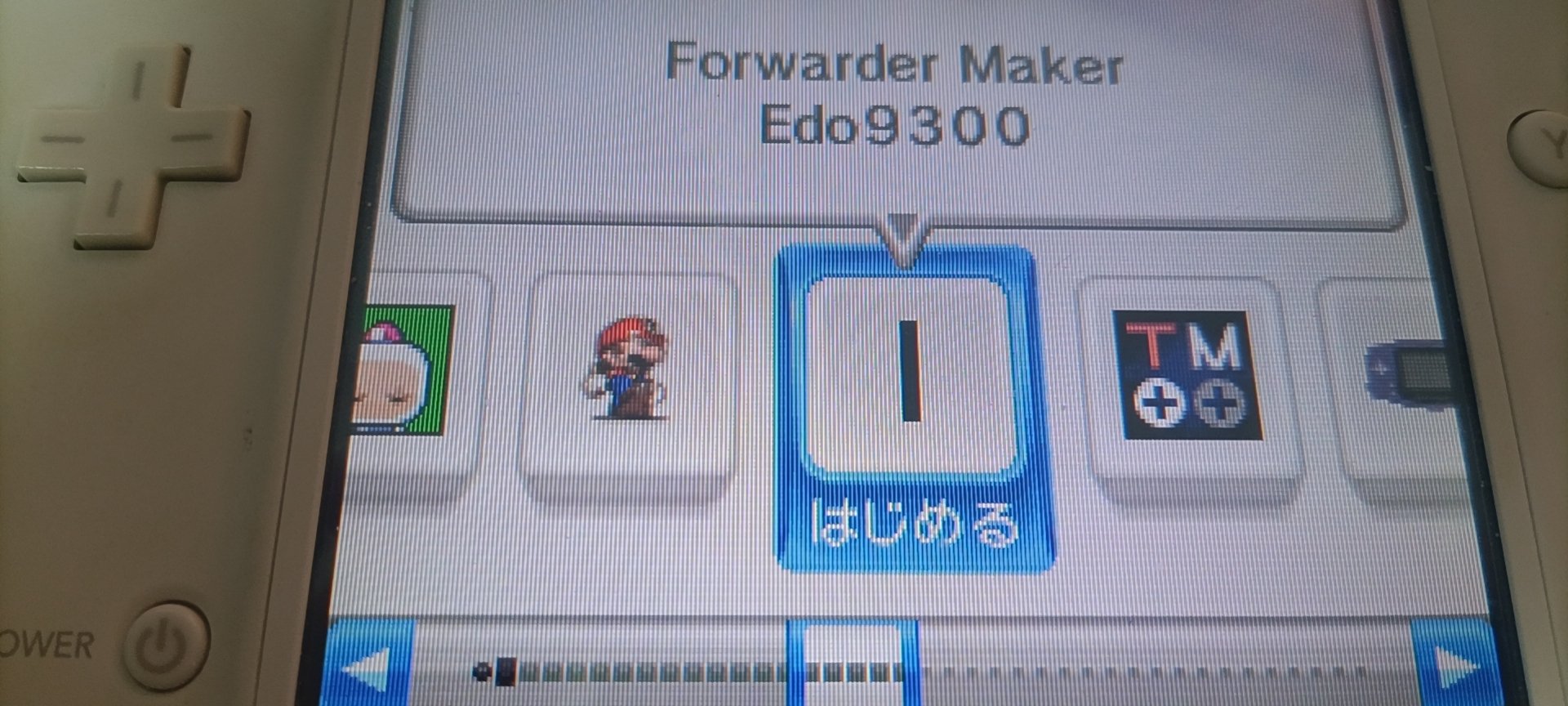

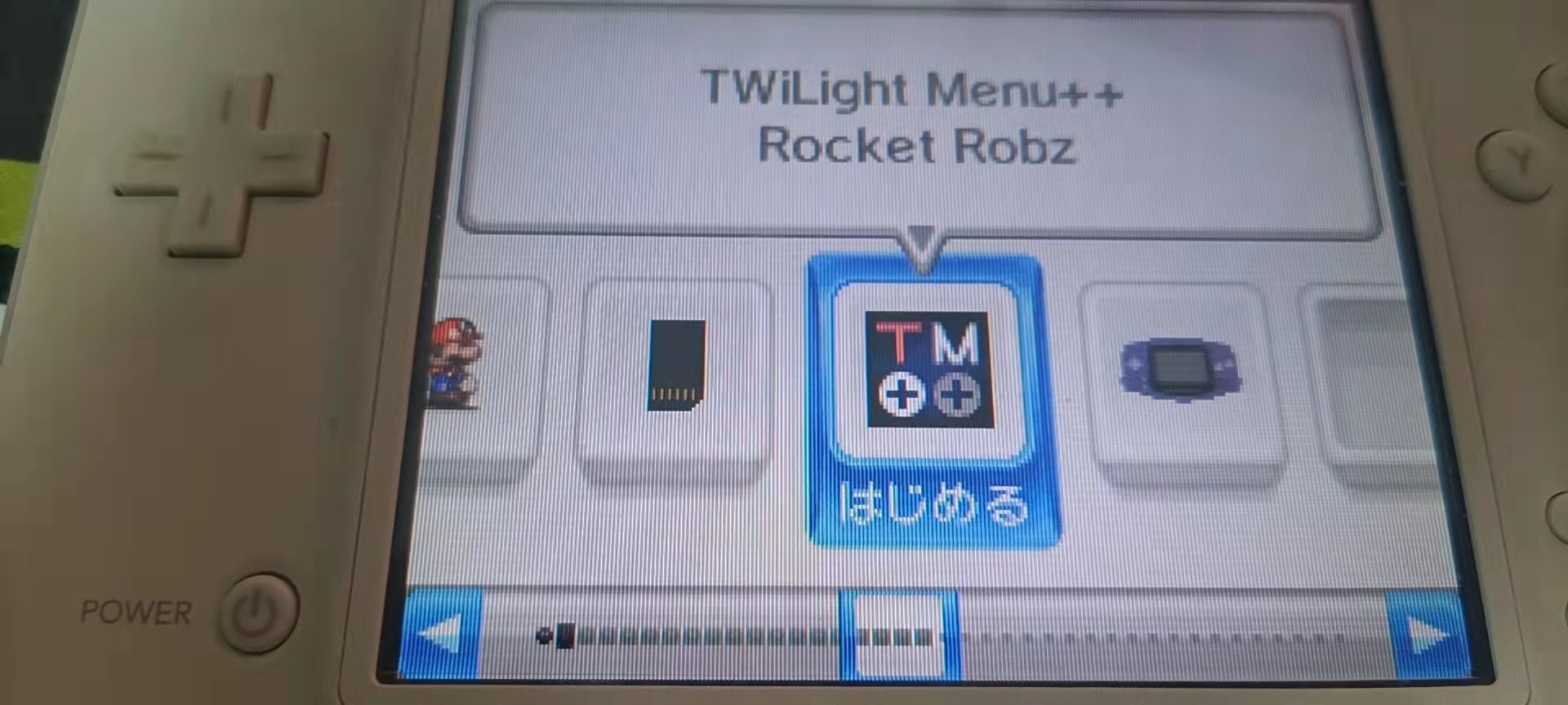

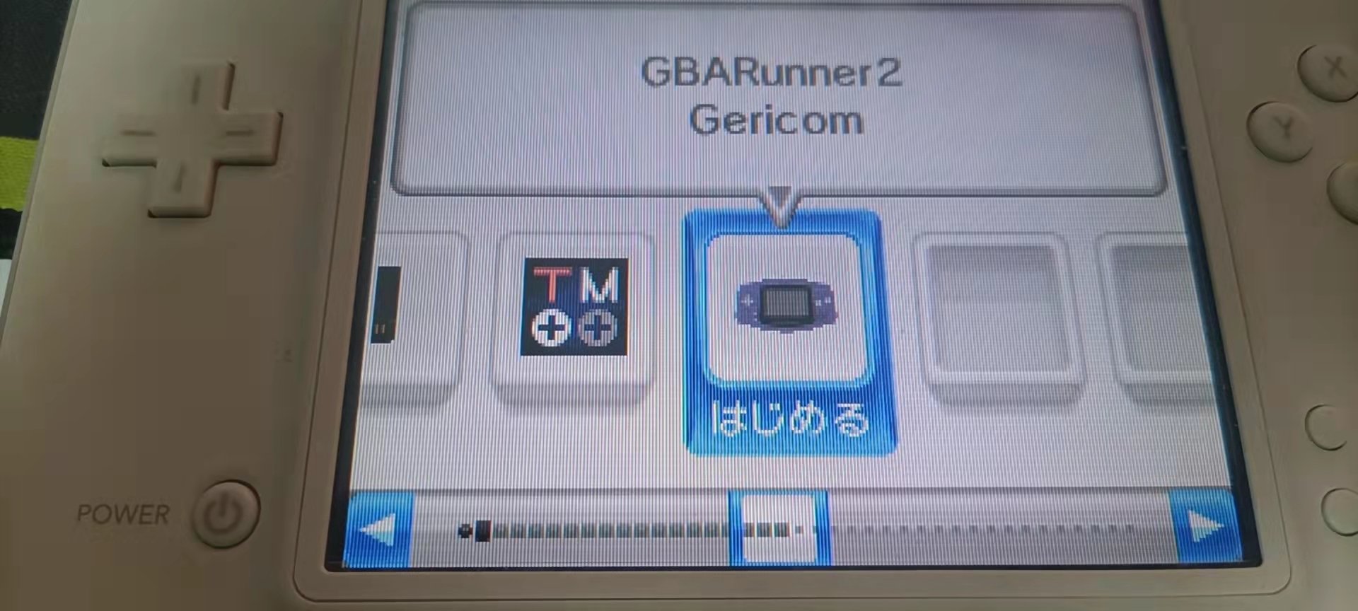

I installed Make-Forwarder-Dsi by NTM, then I use it create a GBARunner2 Forwarder, then I installed the GBARunner2 Forwarder by NTM too, now I can use GBARunner2 from sysNAND now, I also installed TWiLight Menu++ into sysNAND, it also works well.

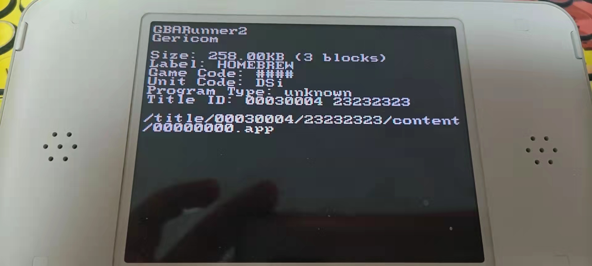

But I noticed that the Game Code of GBARunner2 is ####, so the TItle ID is 00030004 23232323, and some other Homebrew app's Game Code is also ####, If I installed another one, this title must be overwritten. How can I change the title ID to avoid conflict with another app.
If an app has a game code of #### it will be automatically randomized on installation, if you check the Titles menu you should see that it has 4 random letters.
I installed TWiLight Menu++ using the nand title manager. It works when I launch sysNAND from unlaunch. But if I launch sysNAND natively, it gives me "An error has occured. Please refer to the booklet idk the rest". Do I have to load sysNAND through unlaunch or I did something wrong...
Do you have sound in the DSi Menu? If so you need to reinstall Unlaunch with launcher patches enabled. Unfortunately there's not a way to both keep sound and the splash while letting Unlaunch patch out the RSA check at the moment.
