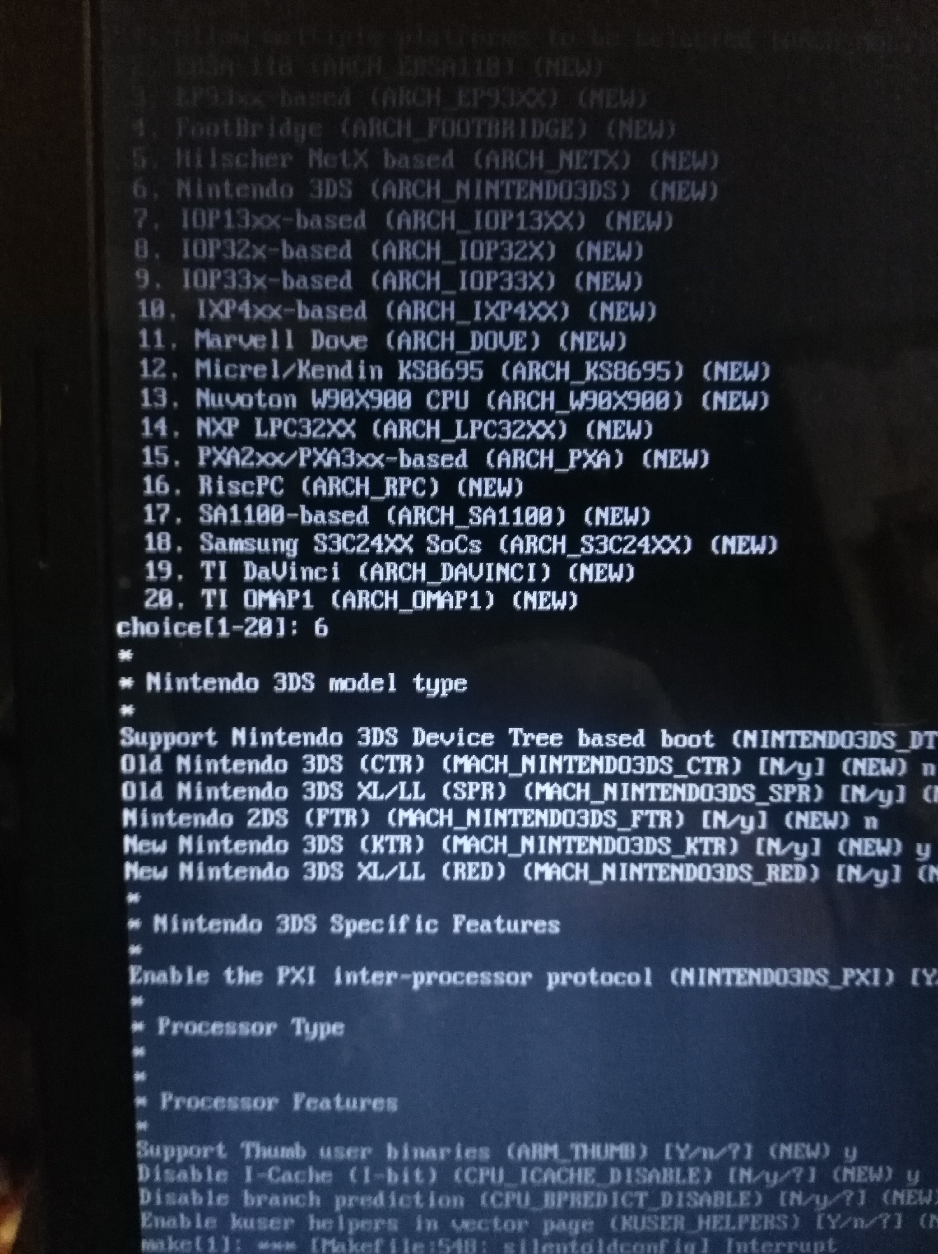

@xerpi what the fuck are these questions help

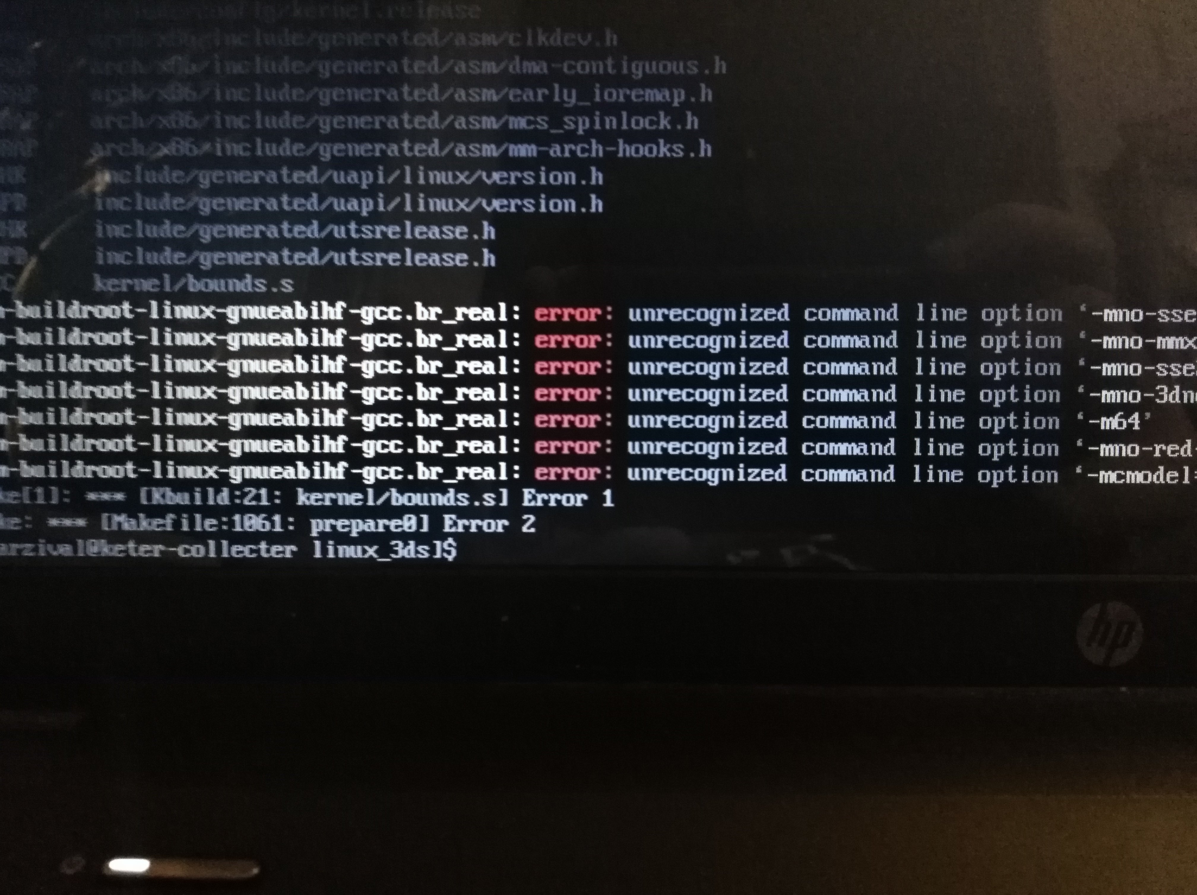

Also fuck these toolchains, they're always named wrong and don't support what they need to despite being the same version and they give me indigestion please help i wanna beat somebody

@xerpi what the fuck are these questions helpView attachment 148904
Say yes to those questions. PXI is the protocol used to talk with the ARM9 processor.
Also make sure you do "make ARCH=arm whatever...".
EDIT: if you use the provided 3ds defconfig it shouldn't ask any questions.

yeah, the defconfig did some weird shit and looked for the toolchain in /opt still and I couldn't figure out how to change it at first. I managed to edit it, though, so it's just the defconfig plus path changes.
