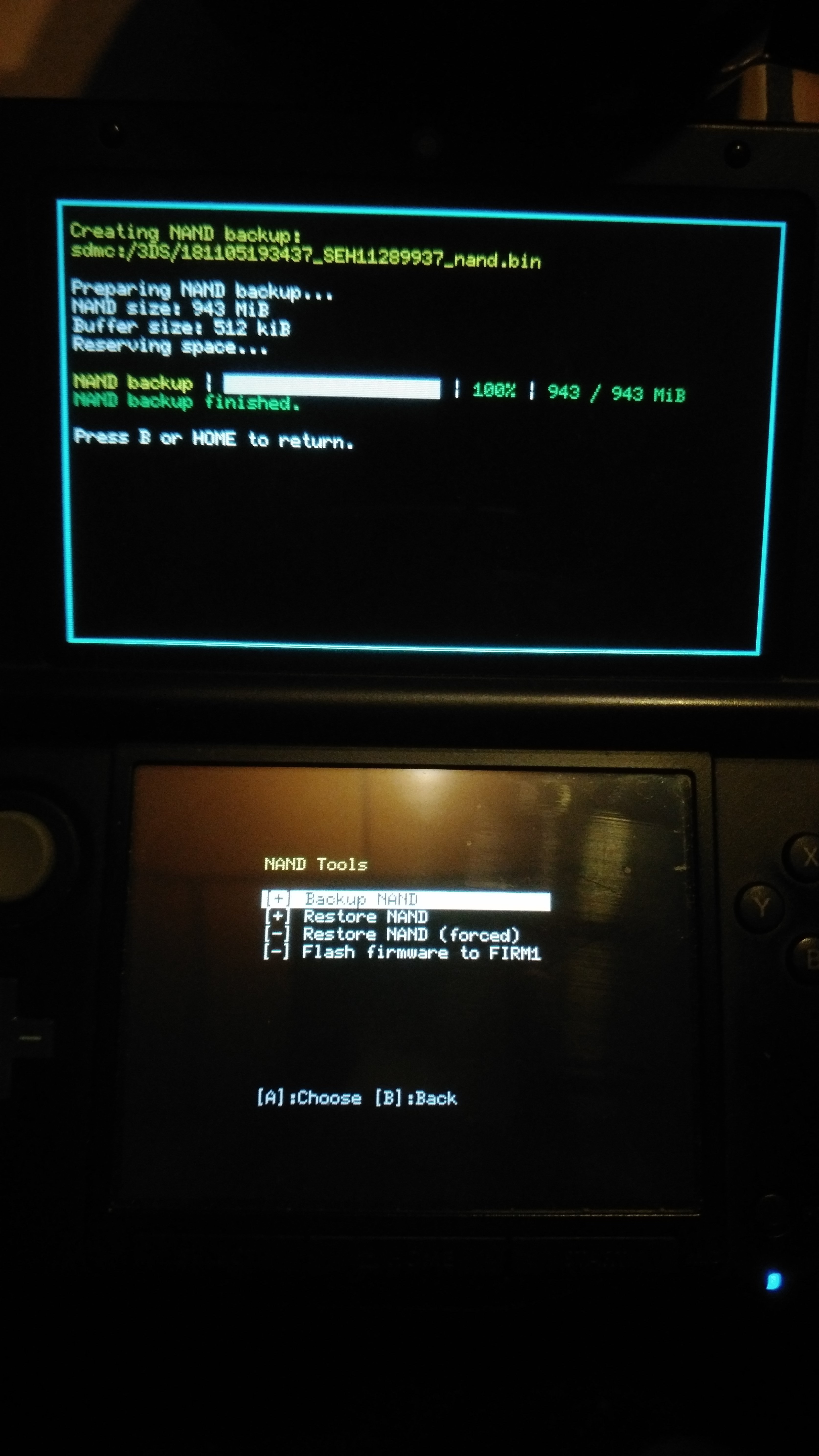

I have installed it. And will give this a try.
