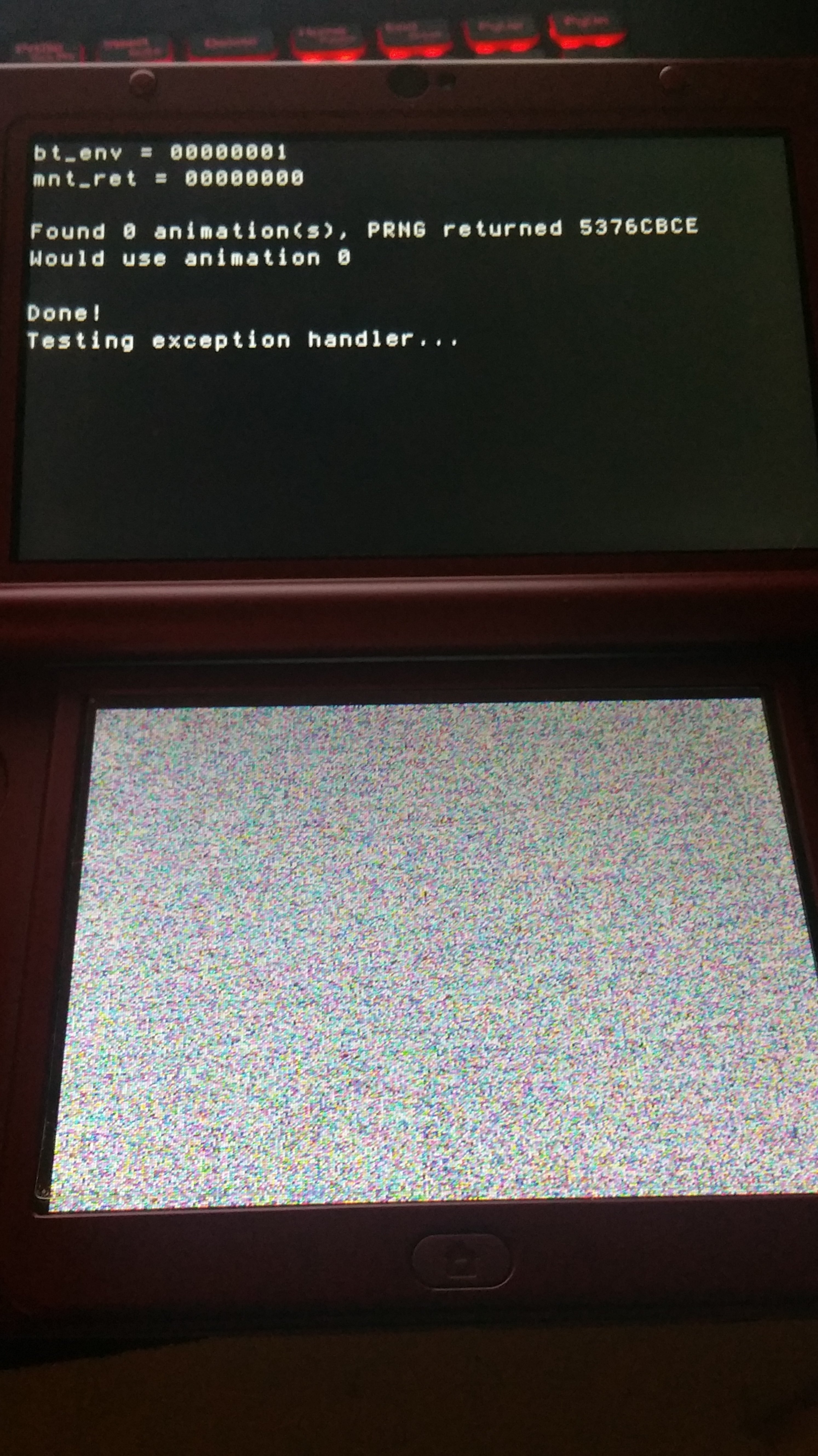

it was tested twice on a n3ds a9lh sysnand 11.x running luma 6.6. my a9lh version is the one used by 3dsafe so it already has screen init and thats all i can think of.
the second time i ran it bt_env was all zeroes.
bt_env is the BOOTENV variable. Basically, if BOOTENV equals 0 it means the system was coldbooted, if it's 1 it means it was rebooted, etc. This will be used so that the animation will only be played in the event that the system was coldbooted.
As for the bottom screen, that's odd. The "corruption" is expected, after all I point the GPU to an uninitialized area of VRAM, so it's expected to be pseudo random. On the other hand, the exception handler didn't get triggered, much like my other N3DS tester... I'll have to look into this.
