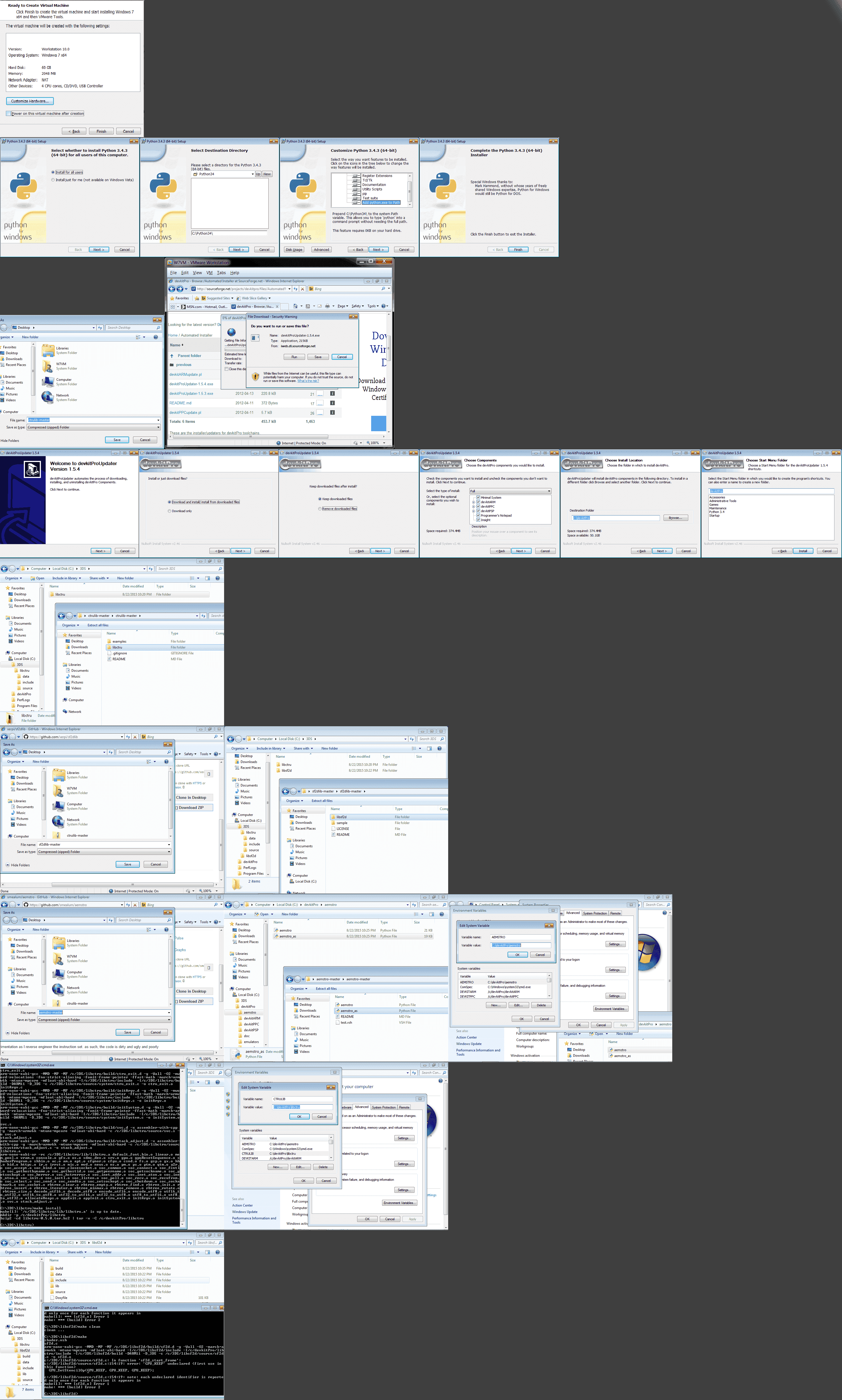

Alright so I gave this yet another shot using everything I've learned so far. All the things I said before apply. Long list detailing every single thing I did is in the quote below and screenshot of everything including errors is in the attached image
So yeah, if anyone can show me how to install sf2dlib on a fresh copy of Windows I'd love you.
EDIT: So the make error in 'libsf2d' says something about GPU_SetStencilOP(GPU_KEEP.... That wouldn't possible be related to the latest ctrulib commit about GPU_KEEP would it? I'm just think out loud. IDK, it's probably something I'm doing.
HOST Computer: Windows 7 Ultimate x64 SP1
VM Software: VMware Workstation 10.0.1 build-1379776
VM OS: Windows: Windows 7 Ultimate x64 SP1
Windows ISO MD5: c9f7ecb768acb82daacf5030e14b271e
Navigate to Python.org
Download: Python 3.4.3 Windows x86-64 MSI Installer
https://www.python.org/ftp/python/3.4.3/python-3.4.3.amd64.msi
Install Python 3.4.3.
Download: CTRULIB v0.5.0
https://github.com/smealum/ctrulib/releases/tag/v0.5.0
Download: devkitProUpdater-1.5.4
http://sourceforge.net/projects/devkitpro/files/Automated Installer/
Install devkitProUpdater-1.5.4
Copy libctru from ctrulib-master.zip to newly created C:\3DS folder. (notice the directory tree on left)
Download: sf2dlib-master.zip
https://github.com/xerpi/sf2dlib
Copy libsf2d from from sf2dlib-master.zip into C:\3DS
Download aemstro-master.zip
https://github.com/smealum/aemstro
Copy 'aemstro.py' and 'aemstro_as.py' from aemstro-master.zip into newly created C:\devkitPro\aemstro
create System Variable 'AEMSTRO' pointing to C:\devkitPro\aemstro
'make' C:\3DS\libctru then 'make install' that same directory
create System Variable 'CTRULIB' pointing to C:\devkitPro\libctru
attempt and fail to make C:\3DS\libsf2d
You actually found the problem you just had one more step to fix it.
Open the file libsf2d/source/sf2d.c in a text editor and search for "GPU_KEEP" and change it to "GPU_STENCIL_KEEP" three times, same as in that link you found:
- GPU_SetStencilOp(GPU_KEEP, GPU_KEEP, GPU_KEEP);
+ GPU_SetStencilOp(GPU_STENCIL_KEEP, GPU_STENCIL_KEEP, GPU_STENCIL_KEEP);
The compile error will go away after you save this fix.

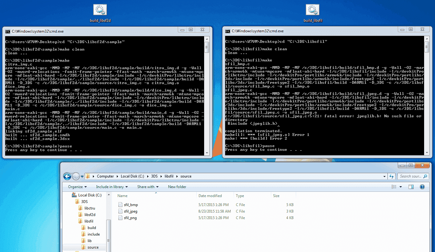

So, now that I got the sf2dlib working anyone got some protips on how to get the load_images library working with it? Screen of successful compilations of the sf2dlib and the error I'm getting with the load images.
Again, I have 0 idea what I'm doing. I just dragged the images library with the other stuff and wrote 'make'.
EDIT: THe error is about a missing file "jpeglib.h. Where can I find that file?

You have to make and install the Portilbs.
Xerpy on his github has a make file that downloads, compiles and install everything for the 3DS toolchain, but it needs wget (or you can download the packages by hand an puth them in the right place).
The packages versions in the script aren't the latest, but work fine. If you want the latest you have to edit the script.
Good luck.
