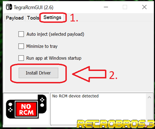

Hello, I tried to inject hekate like I always do since 2 years now and now I have the error No RCM device detected.
Here what I already tried :
- change cable
- change usb port
- install driver again
- try on other pc.
I am out of Idea I just don't know where the problem from

SD card should not have anything to do with RCM mode. Only thing else I can recommend, but looks maybe you've already tried is: Reinstall Zadig Drivers - https://gbatemp.net/download/zadig-generated-nintendo-switch-drivers-for-windows.37504/
Or try different cables (some USB-C cables only charge, will not transfer data) also try different USB ports on PC.
You could always try reinstall Tegra also if nothing else helps, Good luck!
https://github.com/eliboa/TegraRcmGUI/releases/tag/2.6

Still the same issue, zadig don't detect the switch in RCM but he detect the switch in OFW

Update : I give it another try but I really go hard when I put my jig and it worked. Thanks for the help dude
